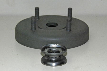

I took the shock absorbers out of the rear of the car over the weekend and at Stu’s suggestion checked, the cupped washers that came with the Koni D adjustable shock absorbers and which sit either side of the mounting plate. The shoulder which sits in the hole measured about 1/8 of an inch.
20130204-3991Ptw Koni bush holders.jpg (117.47 KiB) Viewed 3895 times
With the two stacked together as seen here they were moving around inside the mounting plate creating an alarming rattle.
I have removed one of the two on each shock absorber and replaced them with what was on the car previously. The rattle has gone.

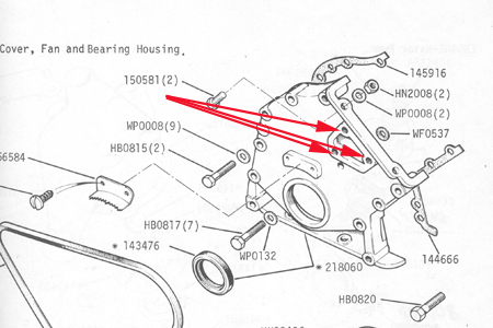

However in the drive back from putting in the petrol, the viscous fan coupling started to protest. I have now searched this Forum and read through 14 pages of references on viscous fans and know that it is time to pull this one off and replace it. I have one spare in stock but it has a three bolt rather than a four bolt attachment onto the timing cover. The odd thing is that my copy of the parts book, June 1974, shows it as a three bolt connection although further down the page it states that four bolts are required.
20130205Pw Timing cover.jpg (115 KiB) Viewed 3895 times
I shall pull the radiator off and try it! I hope it will fit. If it does and is not satisfactory then I will fit an electric fan of some sort.

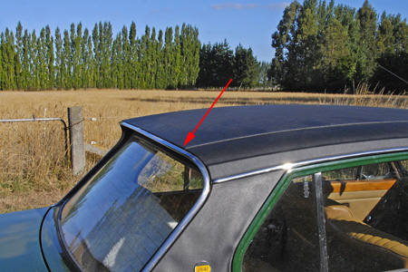

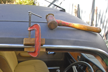

Back in November I struggled a little to get the left hand stainless gutter trim on. Today it was the turn for the right hand. We have to make do here with what we have and I have had to make do with a fairly well twisted trim which seemed to polish up reasonably well on the polishing buff. This time I found that the only way to fit it correctly was to adopt the suggestions made by Steve and Jereon back in November last and I installed it from the bend. I did try from the windscreen bottom but I started too low and it did not reach past the end of the gutter rail.
20130222-4033Ptw HU5000 Fitting the trim.jpg (113.81 KiB) Viewed 3791 times
I clamped it as I had done earlier although it was hardly necessary for this one seemed to push down and clip over the bottom lip relatively easily but for those of you who find it a bit of a struggle then clamping and tapping with something soft might be the way to go.

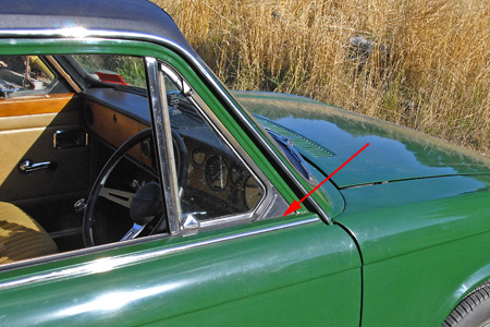

I have now fitted the two C pillar covers and all the trims around the back window. I have not glued the covers into place for they are quite badly marked and I hope that I will find a couple of better ones in due course. The stainless trims buffed up pretty well and the final job was to work a little Dum Dum along the join line between the vinyl roof and the stainless trim itself.
20130222-4035Ptw HU5000 Roof detail.jpg (114.63 KiB) Viewed 3791 times
I have caulked this join line up for I want the water running off the roof to run over the trim rather than to find its way under the trim and perhaps find its way back under the vinyl. Rust is generally not a problem here but I have seen rather horrid photos on this forum of rust in the rear of the roof.
I have used a lot of Dum Dum in the course of this restoration along join lines like this one, on the front doors in order to keep water out of the door inners.

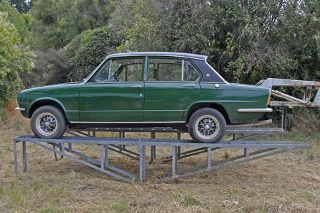

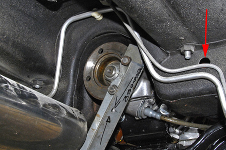

The rear gearbox oil seal was leaking badly. I found amongst my stock of spares a new gearbox oil seal NKC39A dated 1989. Still in its sealed packet. It was a nice day here, in fact it has been a superb summer so far with no rain really since early December. So I drove the car up onto the ramps which sit outside the workshop and sat underneath out of the sun and removed the prop shaft and the nut on the back of the gearbox.
20130302-4048Ptw HU5000 On the ramp.jpg (126.88 KiB) Viewed 3740 times
I find I am spending as much time on these little jobs making the necessary tools, in this case the arm which I bolted to the flange to allow me to both undo the nut and retighten it correctly when I finished. It was very pleasant working under the car today. Plenty of room and plenty of light. Can somebody though tell me what are the functions of all those additional holes in the various cross members and inner sills for. I have marked one here.
20130302-4042Ptw HU5000 Gearbox rear seal replacement.jpg (106.22 KiB) Viewed 3740 times
Should they be fitted with grommets to keep the moisture out?

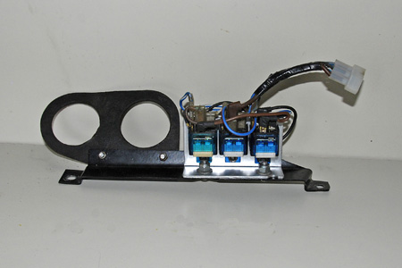

Then another little job was completed. I had earlier made up my relay pack for the headlamps but because I have fitted quartz halogen lamps to the car which have single filaments, the dip beam was not staying on when I selected high beam. So I have added another relay to the pack which when high beam is selected allows the dip beam to remain on.
20130302-4053Ptw HU5000 relay arrangement.jpg (61.82 KiB) Viewed 3740 times
Some have commented about my positioning of the relays, that they might well be in the direct line of the all that comes through the front grille. They are largely protected by the front valance and by the side of the radiator. They are also sealed relays. I will if necessary add a shroud to keep the water off.
The big plus for me is that the relays are as close as it is practical to get them to the lights and just as importantly there is no additional clutter in the engine bay itself. Everything looks neat and tidy.
I noted one thing though. The wiring diagrams in the workshop manual and in the owner’s handbook are more a sort of schematic for they do not show how the headlamp flasher switch is connected to the headlamps. No wiring shown at all. Which is a pity really for when I originally turned the headlamps on to the dip beam and pulled the headlamp flasher on all four headlamps came on. I cannot see how that happens I cannot see where or how that flasher is connected at all. It certainly happens now with the fitting of the third relay.

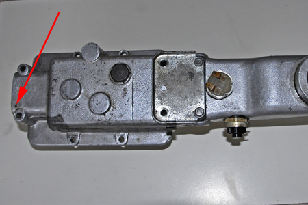

My only course of action then was to remove the passenger seat, disconnect the handbrake onto one of the rear drums, remove the front carpets and then remove the gearbox cover. Once the cover was removed I then took the top cover off the gearbox, yes the workshop manual says you can do this, without removing the parcel shelf, which was a bit of a plus.
There was a lot of oil visible where the three selector rods come out of that cover. The rods are sealed by three o-rings which are held in place by plate and which is only accessible by removing the selector rods themselves. I had earlier broken the top cover on my gearbox and bought another complete gearbox which I suspect had been sitting outside and left standing on its bell housing. There was evidence that there had been quite a lot of moisture in that donor box. I cleaned the cover of course, and reinstalled the selector rods which were in the cover which I had broken for they were in much better condition than those in the donor box.
But I neglected to do two things.
Firstly I did not fit new o-rings, (I purchased three today for about 35 pence each). But why was the oil coming out past those o-rings? I figured that the gearbox must heat and cool as it is used and there must be some sort of breather somewhere and that perhaps this breather was blocked. If it was blocked then the build-up in pressure within the gearbox was perhaps sufficient to force oil out past any one or all three of these o-rings, which are only held in place very lightly by their cover plate. I found the breather hole right at the front of the top cover, as marked.
20130312-4061Ptw HU5000 Gearbox cover.jpg (135.75 KiB) Viewed 3692 times
Of course with the donor gearbox standing on its end this little hole seemed to be blocked for when I blew it out with compressed air there was a little wad of muck released.
The second task is that I should have blown it out when I cleaned the cover originally.
It is easy to be wise after the event. But I hope this will lead others to check, if they have their gearbox apart that this little hole is clear. It sits forward of the end of the reverse selector rod and I imagine that there is sufficient clearance, and fairly minimal movement to allow the internal space within the gearbox to breathe, and which allows air to pass along that selector rod and not allow the oil which might follow, to escape.

Not sure about the chassis holes, will have to wait until I have the car in the air again. I have a feeling that mine are open like yours but I should confirm that. Nothing in the parts catalogue I can see.
