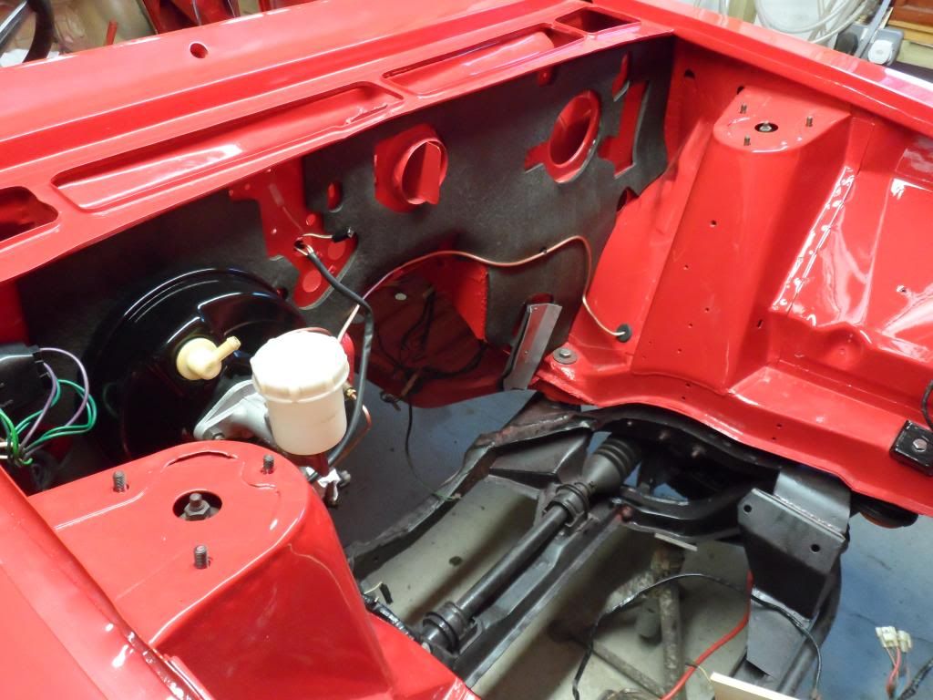

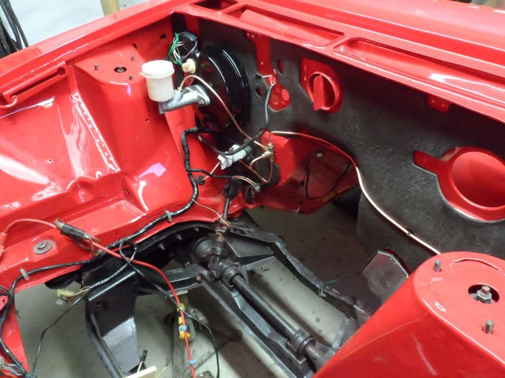

Bit more done today.
Heat shield fitted
Bulkhead pad fitted
Loom fitted
Brake pipes fitted
Clutch master cylinder fitted
Servo & brake master cylinder fitted.

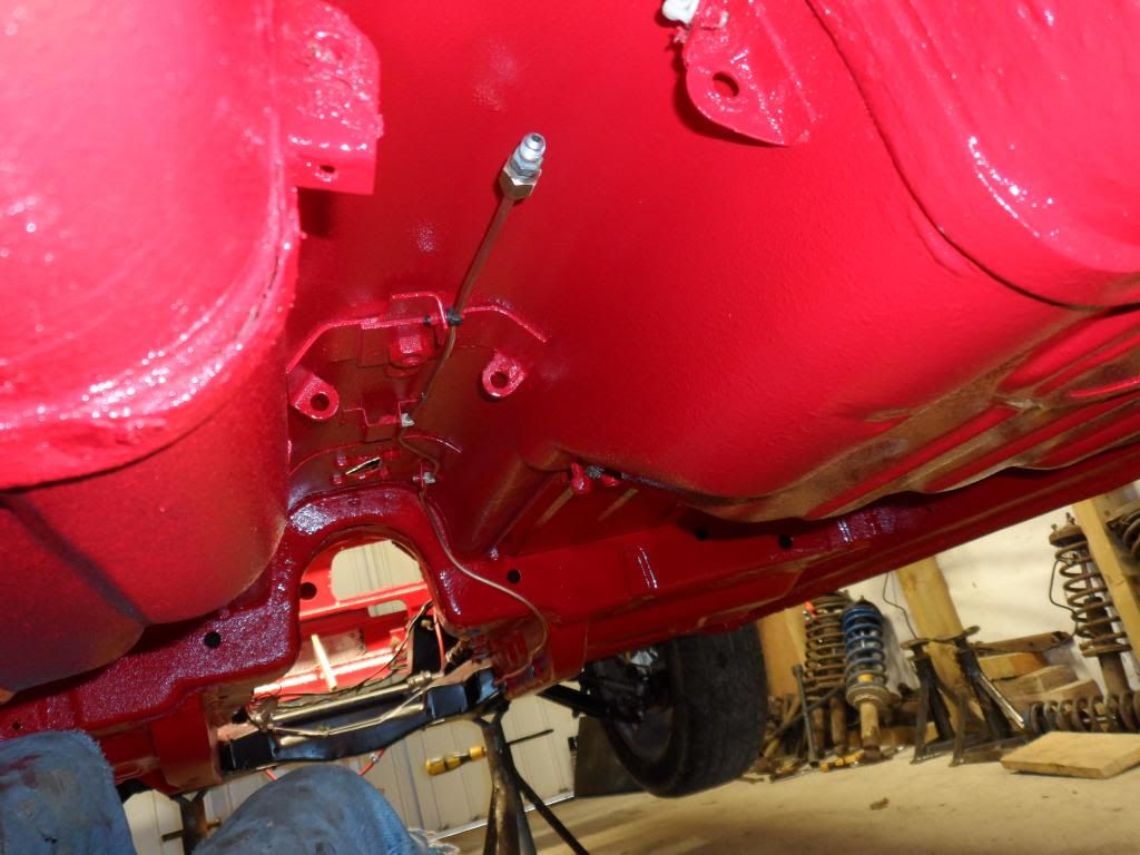

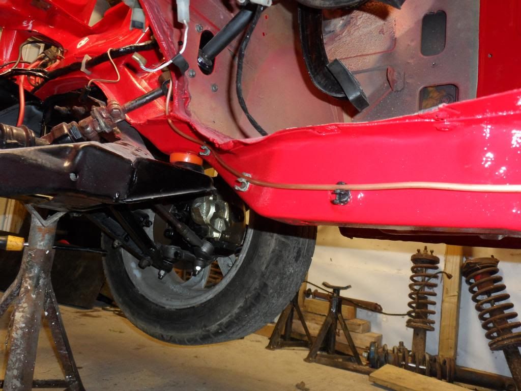

I bought the brake pipe set from Stevsons, the 1st pipe that goes from the 4 way splitter to the rear axle seems too long, bit of a pain as I need to now shorten the 2nd pipe, just need to find someone with a pipe flarer, or I haven't routed the pipe correctly, have a look-

Yes that first pipe is way to long. It should end just before the handbrake area with a union to the next bit which goes to the LSV.

Why is the pipe to the back axle in two pieces?
I think I will call Stevsons next week to see if they can either make me a shorter 2nd pipe or replace the 1st section, plus they need to know the set they are supplying is incorrect, unless mine is a one off mistake.
