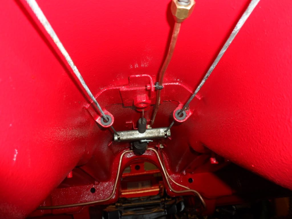

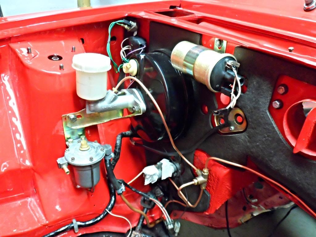

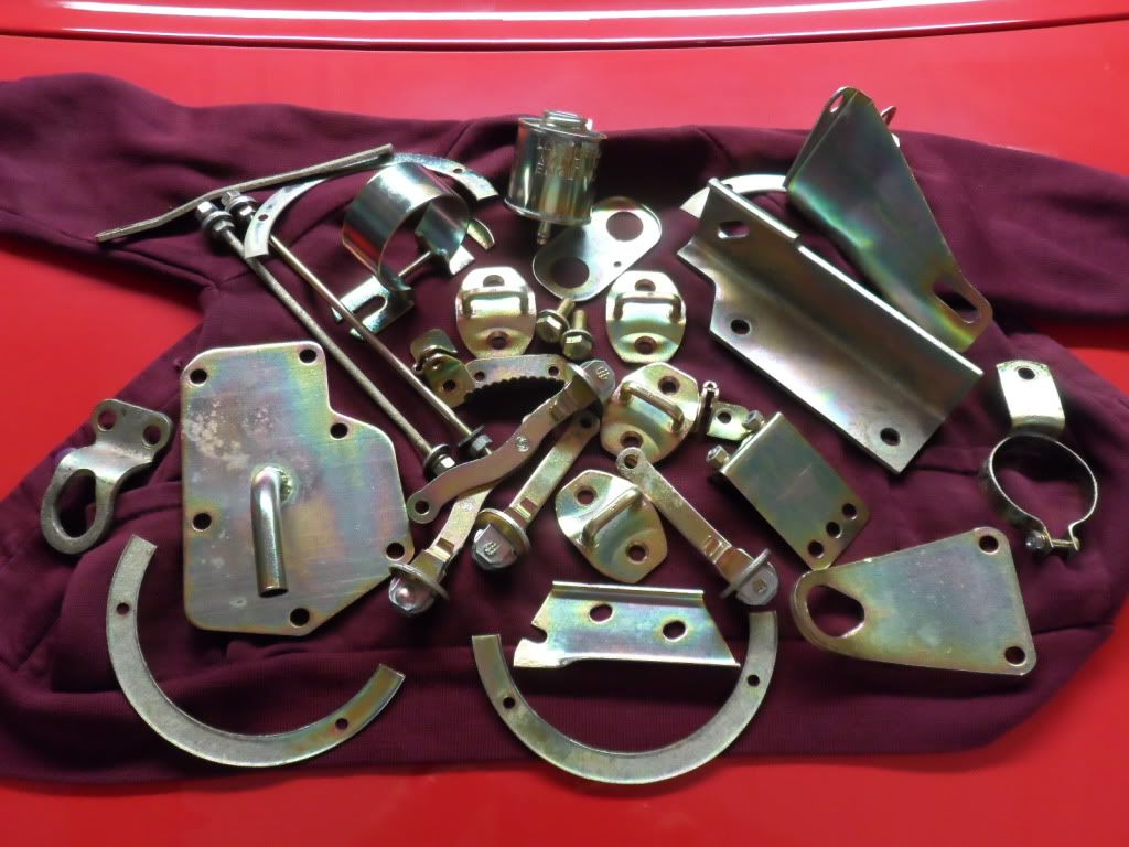

Took a leaf out of Mark's book & took a load of stuff to my local plating company a couple of weeks ago, got it all back today zinc passivated, all nice & shiny, not bad for £40
Unfortunately it doesn't remove any pitting from previous corrosion but should stop any further corrosion in the future.

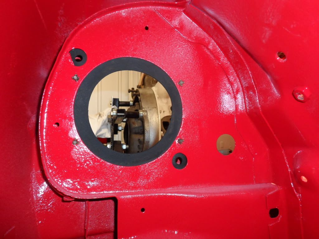

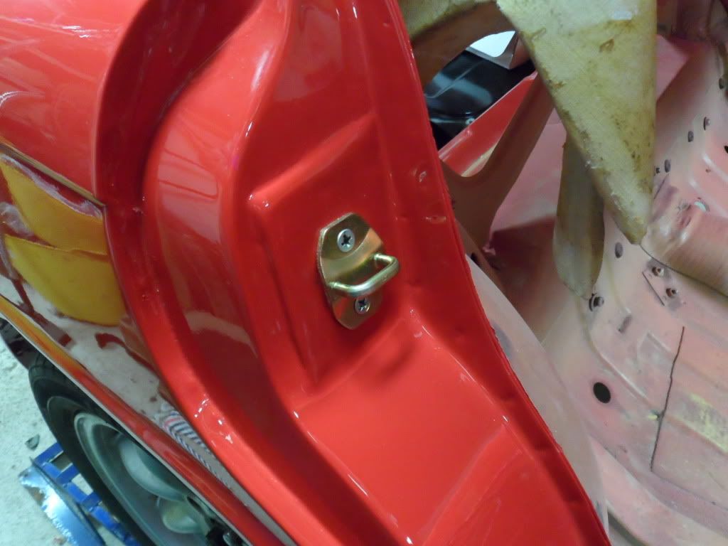

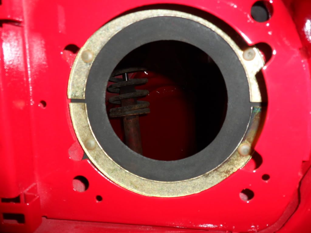

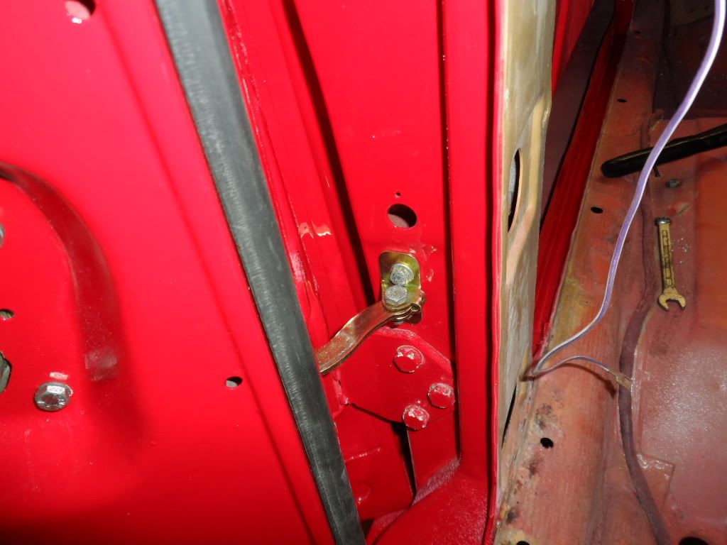

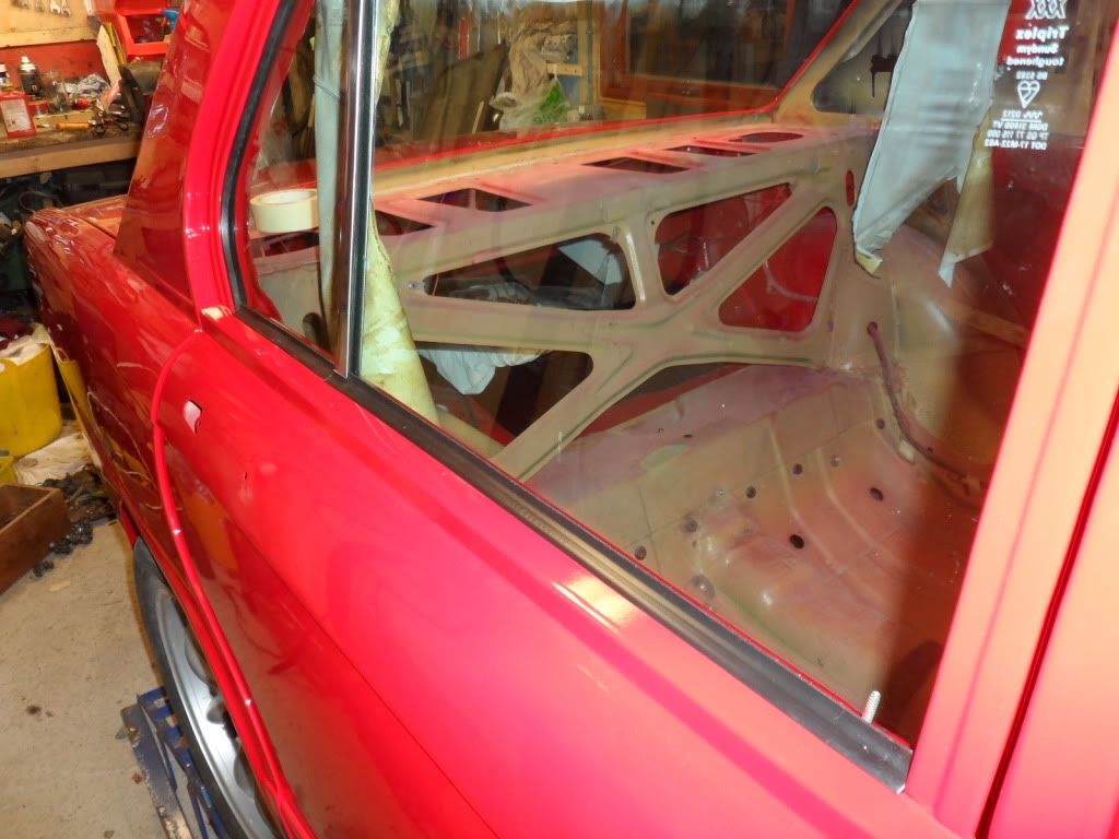

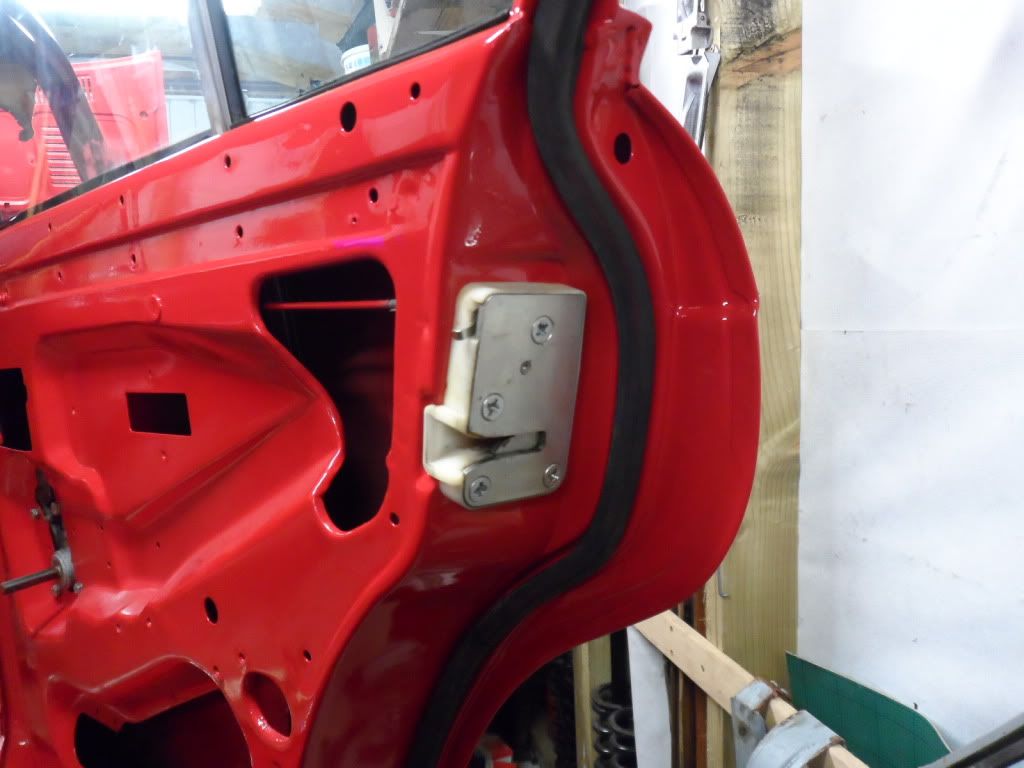

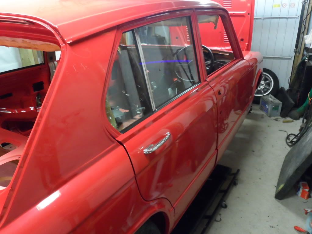

Grommets in, thanks Bill
Few more bits fitted
Offside rear door built, Mark you have to fit the weather strips after the glass is in as the chrome stip that holds the quarter light in has to be angled to get the glass in, this would be very difficult with the weather seal in place.

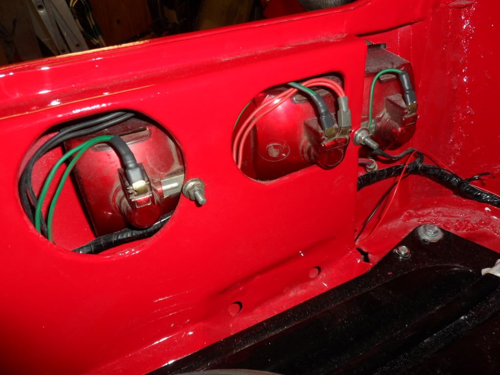

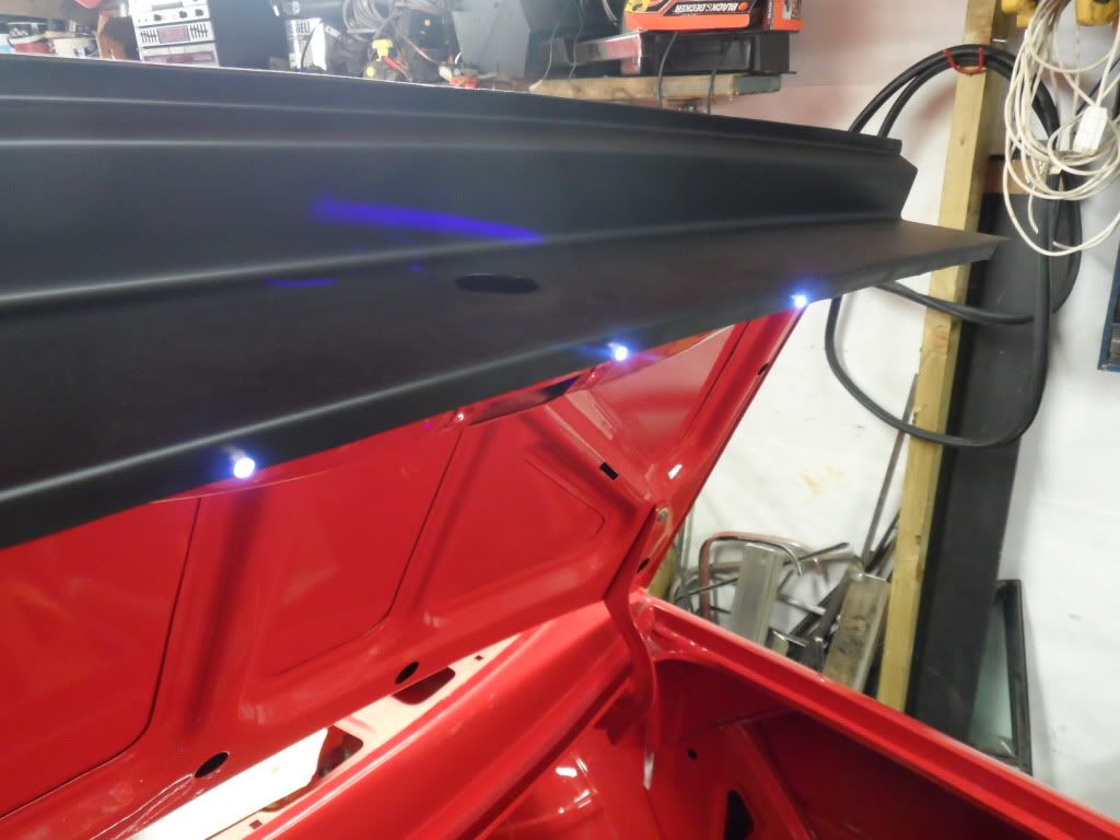

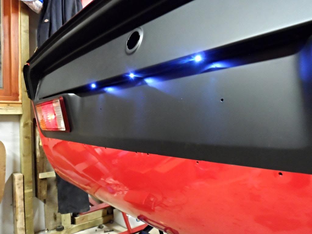

Few more bits done, not had much time with other family commitments taking priority.
Headlight rear seals fitted
Rear lights and LED number plate lights wired up
Rear doors finished off

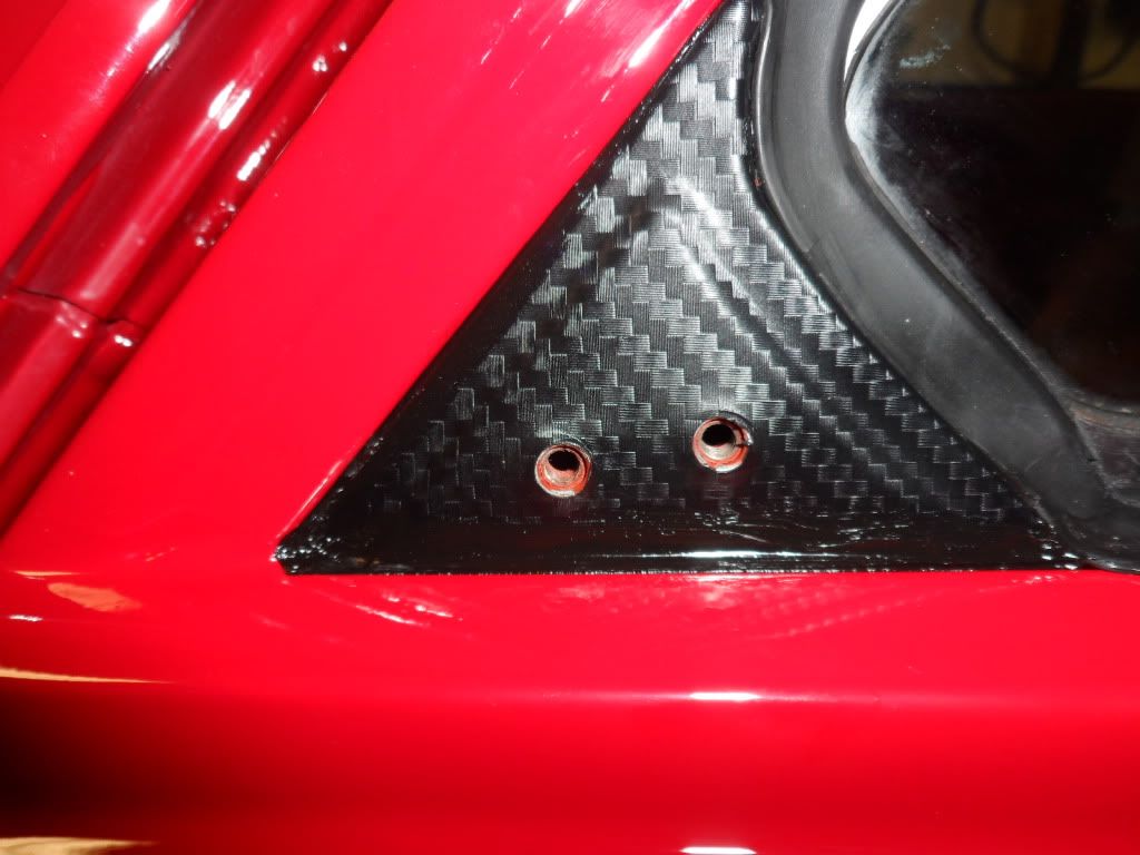

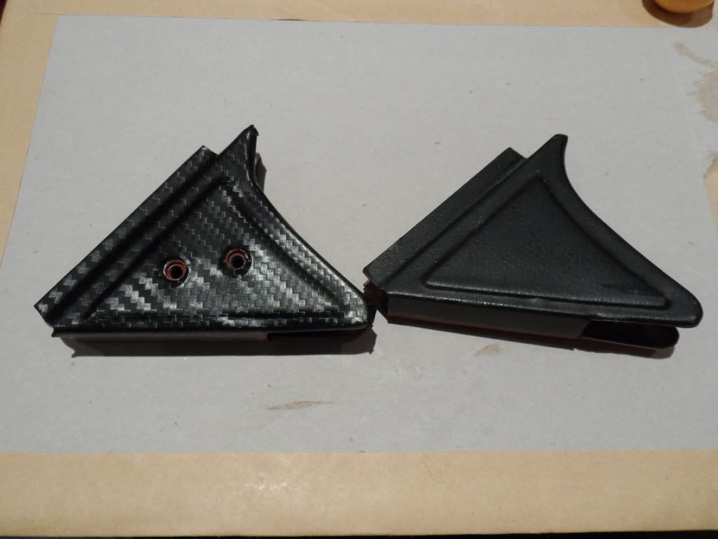

Started on the front doors, the small vinyl covered triangle inserts were rusted, so I have recovered the outsides in carbon fibre wrap, there also have rivnuts fitted for the wing mirrors.
I used black silicon sealant to fit the inserts

Great idea for the door mirror mountings - will they be strong enough?
Tony Burd
Posts: 1248
Location: Andover Hants
Re: MSO 662P
#147 Post by Tony Burd »
Hi Bill
I can't take the credit for the mirrors, the guy who built the car in the 80s fitted them, see the article on the first page of this thread

Your plated parts look the business. I picked up a box load more this morning. I'd dropped them off a fortnight or so ago to a man who thought I'd given him various bits of scrap, sometimes quite rusty metal. Even he was surprised how well they came out.
