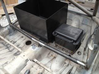

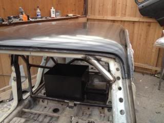

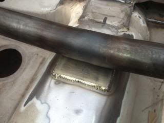

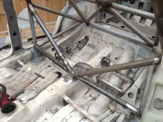

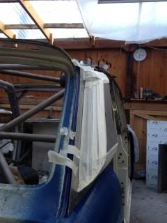

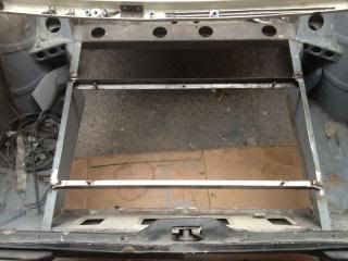

Did a little bit today,
Welded a bar across the bottom of the rear loop to protect the fuel tank a little more
I have 2 dia stays to put in this week
Also put these in at the top of the windsreen cage .
My clarke welder packed up before i could finnish

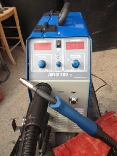

Its a 151te but its an old one 10yrs +
The new ones are built in china and i heard bad things so i would not by another
I have seen one i want just need to get the money together
Its a ex display one so a bit cheaper will post picks up when i have it ,

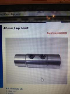

Ive done a little more today,
i popped over to custom cages to get a couple of these for a dia bar which
goes in front of the fuel tank ,
Ive had to make a removable bar to aid fuel tank removal for pump service,
Bar in

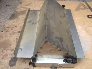

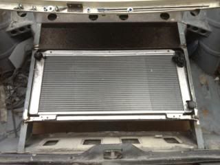

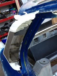

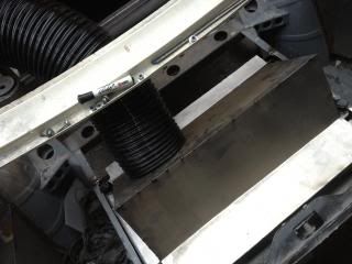

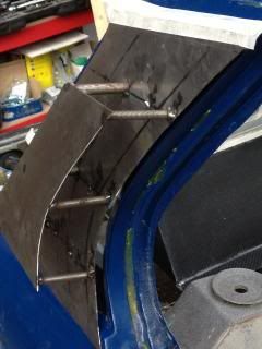

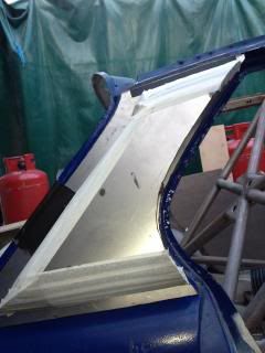

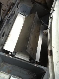

Also did a bit of work on the rear radiator install
Put a frame in,

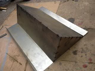

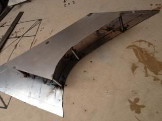

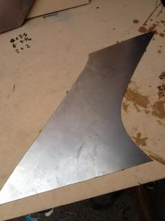

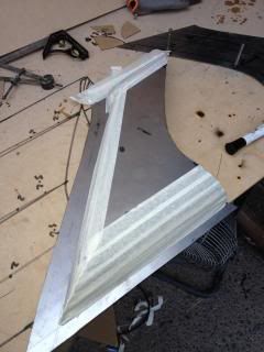

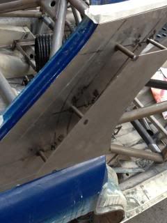

I then made a air feed box
Which will be fed by two BIG pipes,
I have calculated the area of the rad and if the scoops either side of the car flow the air i should have
enough cooling

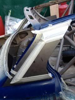

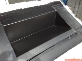

I then started to take a mold
I havnt bothered to paint the air box before molding,

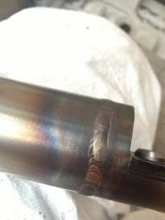

I also picked a new mig welder up
Its a shop second which has a scratch on it so it was £100 cheaper
Bit rusty on the tig need some practice
Bar in
Put a frame in,
enough cooling

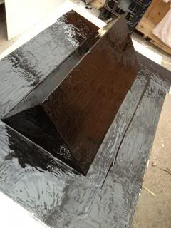

Oh yeah, we can all see how awful that TIG work isDF wrote:Bit rusty on the tig need some practice
Tried out the R-Tech?
Re: My new road And occasional track day car
Loltinweevil wrote:Oh yeah, we can all see how awful that TIG work isDF wrote:Bit rusty on the tig need some practice
Rtec im getting used to it now
It is better then the clark more finnese

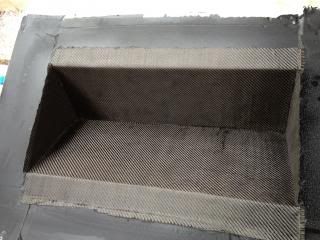

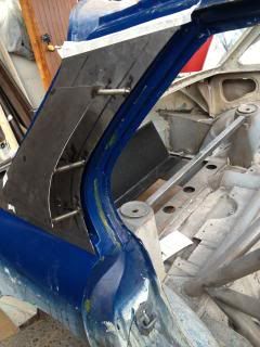

Finnished the air box mold today and have made the carbon part.
hopefully it will be cured tommorow

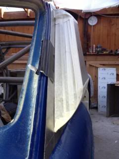

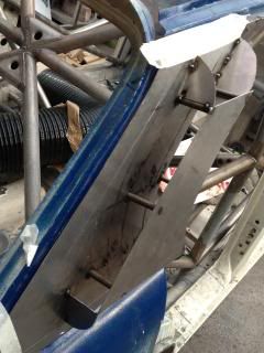

Forgive my ignorance (if it is) but would it not be better to taper these ducts in towards the rear to encourage the air to turn the corner?
Have to admit, that was my first thought too.
Hit it.
Hit it.
The photos don't show it but they are tapered,
They are in 2 parts there is an inner section
I wanted to keep the outside flat as I think the angled outer wouldn't
Look right
All will be revealed when I've made the part in cf ,
Look right
