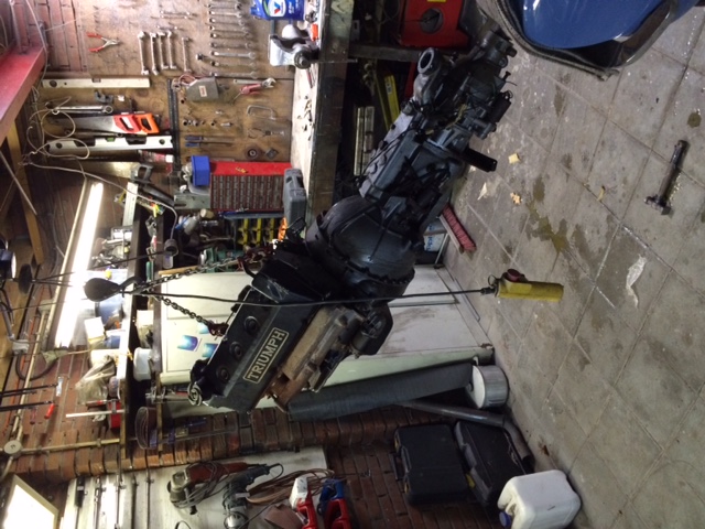

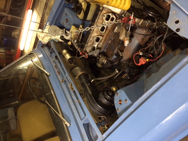

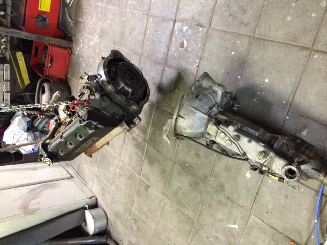

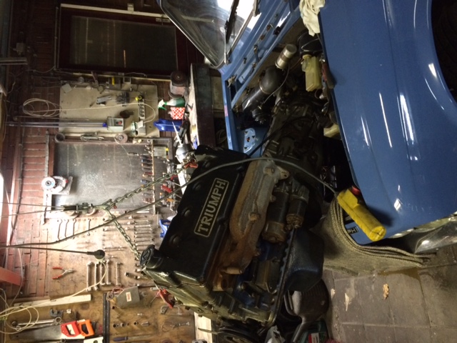

It's all going smoother than I thought, so far. We just took the engine and gearbox out. Saturday I'll start stripping it to the base and clean it up.
Mounted the winch
Mounted the winch
Pulled it out smoothly
Hanging in there
Hanging in there
And voila, there it is

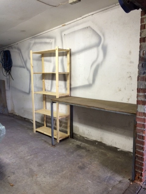

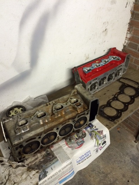

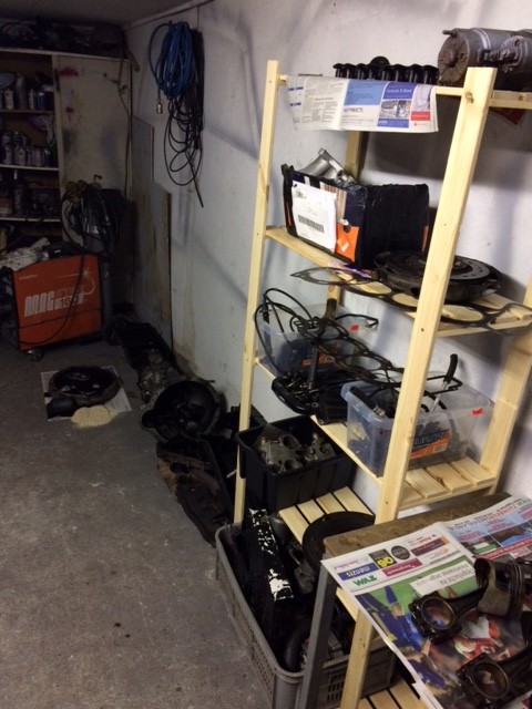

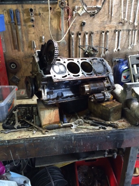

Also good news. I made some room for a working bench and a storage rack for all the parts that were laying all around. And I took the engine's head of today, I think there's one or two more hours of work to take of all the parts before I can start cleaning up. We checked the pistons and the piston chambers. I was quite satisfied finding out there are no (not sure if that's proper English) ridges on the edge of the chambers.
This afternoon my uncle showed up by surprise. He saw a picture I posted on Facebook of my new "revision corner" and brought me something unexpected. He had an unused engine stand sitting in his garage for years and decided I could put it to use. All I need to do is fit the mounting plate, which I will be doing next week.

Almost done stripping down the engine.

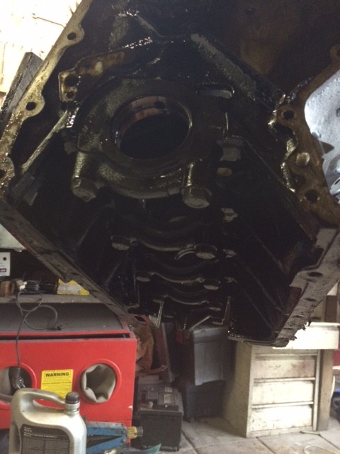

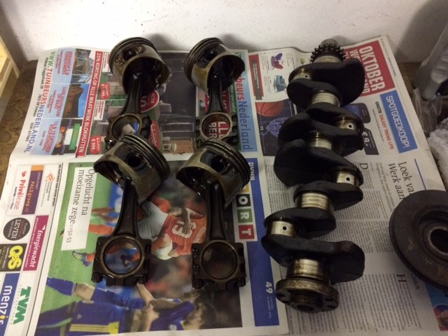

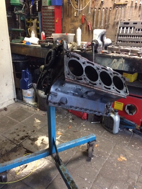

Well, it has been two weeks since I worked on stripping the engine. Today I managed to finish that job. Now all there is left is a bare iron block. Besides renewing bearings, bearing shells, seals and gasket I also think the timing chain has to be replaced, as wel as the tensioner. And the clutch seems a bit worn off. But first I'm going to clean all the parts... :D

And more pictures

Be sure to remove the jackshaft and check the bearing condition.
DutchSprint
Re: Outlaw Dolomite Sprint
#37 Post by DutchSprint »
The jackshaft?
#38 Post by Jon Tilson »
Yep its the long bit behind the last sprocket.

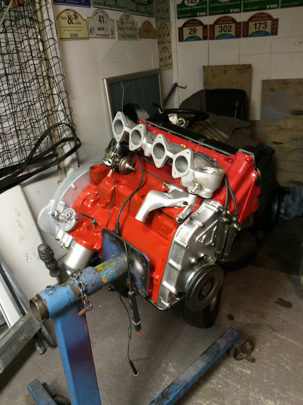

I did not take the time to post updates, but we've put the engine back together. It had a complete revision, including a new clutch plate and pressure group. We worked the flywheel and connecting rods to make them lighter. The only thing missing are carbs. I had a good offer from a member but waited way too long with a proper response. So now I'm on the lookout for a pair again.

There they are. Dell'orto 45 DHLA carbs. they need some cleaning up, but that's all. At this pace, the car should be up and running in about two weeks!
