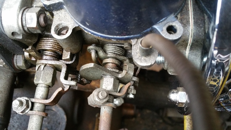

Reassembling the carbs, can someone check that I have fitted the choke cam spring right here? The spring itself is the correct one as the carbs are waxstat.
It's a bugger to fit! I think I have its just that I didn't get a clear photo of it when I stripped the carbs down.
In the basis that I have fitted it correctly (if I haven't it can easily be removed) I completely dry fitted the carbs and linkage to the manifold.

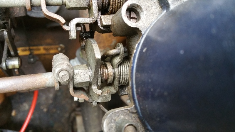

I'd send you a pic of my choke cam spring, but it's so covered in grime, you'd be wasting time trying to photoshop the picture.

This is what they looked like on the car
Mahesh
Posts: 1293
Joined: Wed Jul 22, 2015 12:58 pm
Location: London
Re: NWL – Project Carmine Sprint
#310 Post by Mahesh »
If that's what your engine and carbs looked like, compared to now, can you come and do mine :D
I've just returned from the car, after removing and stripping the radiator, but will put up a pic in the morning if it helps.

#311 Post by Mahesh »

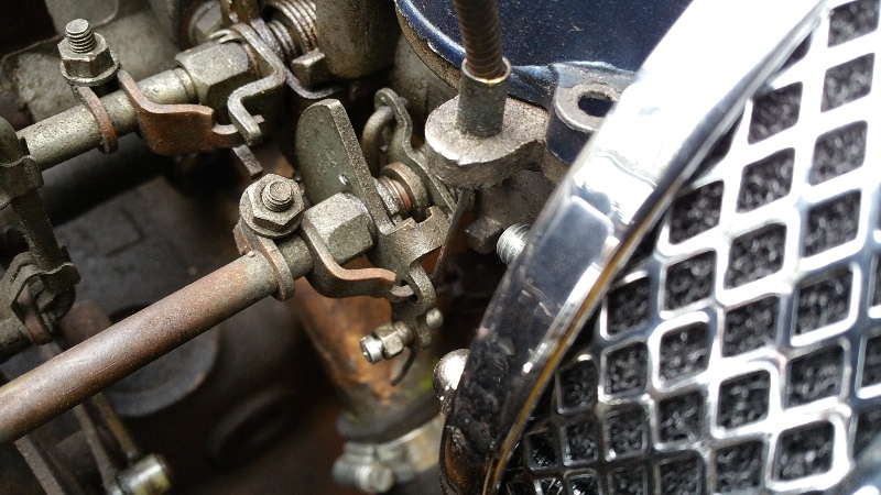

Doubt my pics help,

That nicely illustrates what I was going to point out that one of James spring hooks isnt located properly...
James...3rd to last pic at about 8-9 o'clock on the throttle return...

Thanks Jonners, is this the pic you're referring to?
If it is, I think I can see what you mean, I've had a check and it may just be due to the nut not being quite tight enough on the spindle yet allowing the spring to move sideways. I'm confident that I have it on correctly though, I'll do the final assembly and see how it fits.
