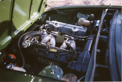

I seem to remember that I took the air box in to Halfords pre sandblast to match a colour and that was the closest I could find as well, anyway, these are the only before photos I have. Not like me to not do a before pic, luckily they're pretty good from a colour point of view!
See Mahesh, no black paint here!! :lol:

Re: NWL – Project Carmine Sprint
#337 Post by Jon Tilson »
Sprints came out of the box with either grey or black airboxes, but Ive only ever seen TR7 ones in grey.
My Sprint is black...
That's also bizarrely an earlier TR7 airbox outer...the later ones that would have been contemporary had a vacuum or temperature controlled flap valve instead of the two open pipes. They really do seem to have been trawling in the barrel at the end of the line.
Nice job on the carbs but I would personally have waited until the manifold was on the engine before fitting them as it puts less
weight on the unc bolts that hold the manifold on, and you get better viz of water leaks and access to fix them with the carbs off.
You can always whack them off again no worries, or just fit them to the engine out of the car....loads of ways to skin a cat.
