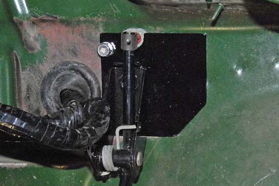

Guys and gals, what was the repair for the accelerator pedal bulkhead cracking issue?
Weld it up and fit the auto pedal brace?
Thanks
Re: NWL – Project Concours Carmine Sprint
#520 Post by Jon Tilson »
Pretty much. It tends to crack out to the hole for the wiring loom grommet. Alun makes something to strengthen it.
Mine did this so I riveted a support plate over the area.
Robert 352
Posts: 389
Accelerator pedal stiffening
#521 Post by Robert 352 »
I guess you have a bit of a quandary here for if you are striving for originality then you have few options other than to weld where the cracking has occurred and fit the plate which was fitted to the automatic gearbox optioned cars.
Originality was not an issue with me. I set out to overcome the problem by reinforcing the area by bolting two plates, one on either side of the bulkhead. I utilised an additional hole in the bulkhead which the previous owner had drilled so that he could install an oil gauge. The plates were designed to transfer as much of the force generated back to the curved edge of the inner wheel arch which stiffens the whole bulkhead.
This is the plate on the interior side of the bulkhead which goes right out to the inner wheel arch.
20121022-3628Pw bulkhead reinforcing plate.jpg (75.47 KiB) Viewed 3654 times
This is the plate which matches the function of the auto reinforcing plate. I have shaped it so that it sits snugly up against the inner wheel arch.
20121022-3627Pw bulkhead reinforcing plate.jpg (54.93 KiB) Viewed 3654 times
If you are anything like me you will be wanting to enjoy the effort which you are putting into your car by driving it for that is where the real enjoyment comes so I would suggest the practical solution of at least stiffening the panel on one side after welding. The bigger the stiffening plate the better.
Robert

Thanks for the pics Robert.
Pretty much yes, I imagine if BL spotted this early on then I imagine there would be two options:
1 - Just fit the automatic bracket to all cars
2 - Reinforce the area by spot welding a plate in place over it during manufacture
I think what a normal car company would have done would be to issue a recall and apply 1 to existing models during a service and implement number 2 during the manufacturing process.
No hang on it's BL we're talking about, there would have been an industrial dispute over it because some militant shop steward didn't want to bend over that far to operate the spot welder or something and then probably just ignored the issue! :)
I want to weld up the crack and do number 2 because I feel that's what would have happened to late cars, the area would have been reinforced with a spot welded plate. I'll have a look at that this weekend.
