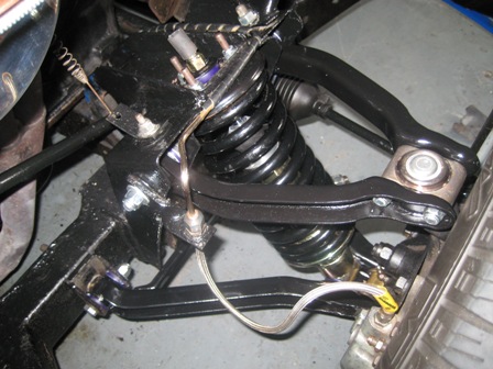

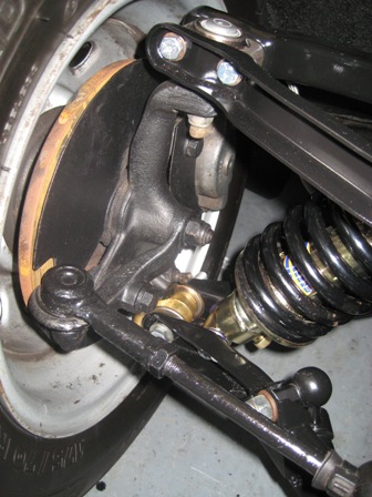

Despite the recent mishap fitting new bushes and bolts will transform the handling. You'll be really pleased with the results. Just remember to not fully tighten the bolts up until you have the car weight back on the suspension. I do this but using two trolley jacks under the wishbones to just lift the car off the axlestands. This saves nipping the bushes at the unloaded position and then twisting them under load.
Use Copperslip (liberally) on the bolts and make sure there's loads in the metal sleeves and they'll never seize. Another tip when installing the lower wishbone with the new bushes. If you have the hangers loose enough to move a little you'll probably find it a lot easier to force the bushes into place...then retighten the hangers making sure that they don't twist.
Here's some inspiration. New Polybushes and Gaz shocks courtesy of Paddocks...
