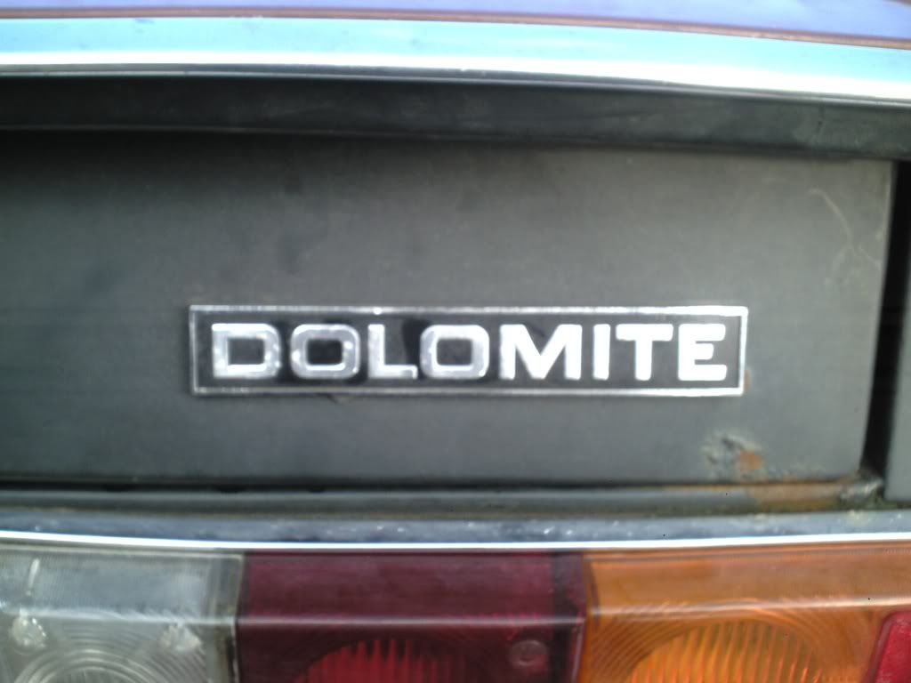

First up is the bootlid badge. The autos had "AUTOMATIC" beneath.

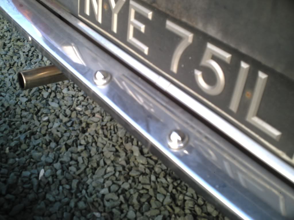

This is OSR bumper corner with the hole.
The rear bumper with the later type number plate lights.

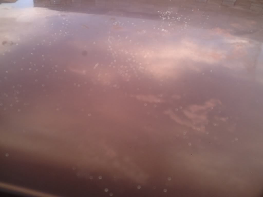

This is what the paintwork on the roof looks like. The bonnet & boot are in a similar state.

That is the correct boot badge for a pre-HL automatic, the "Automatic" script is a separate part that sits below the model identifying badge. :wink:
I'd nip out and take a close up of mine, but it's filthy and some rotten seagull just sh*t on that area. No, I couldn't figure out how he managed it either.... :evil:

Dont forget the older style number plate lamps...
Those newer ones are a reshell giveaway.
