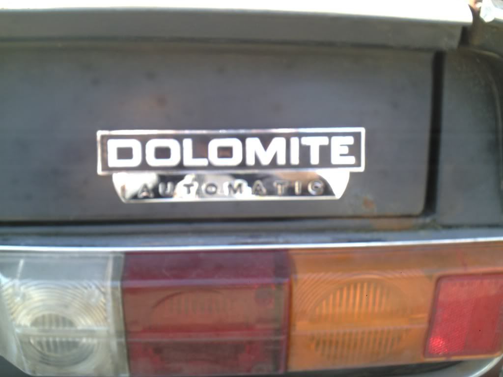

Brown's running fine now. The ignition timing was way out so once it was adjusted it was fine. The "automatic" badge arrived from Mick Dolphin so that was fitted as you can see in the pic below:

:shock: That's not fair now, your badge is shinier than mine! :mrgreen:

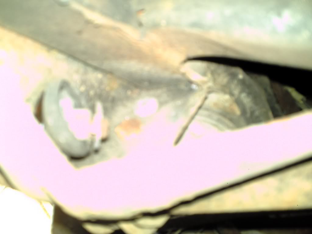

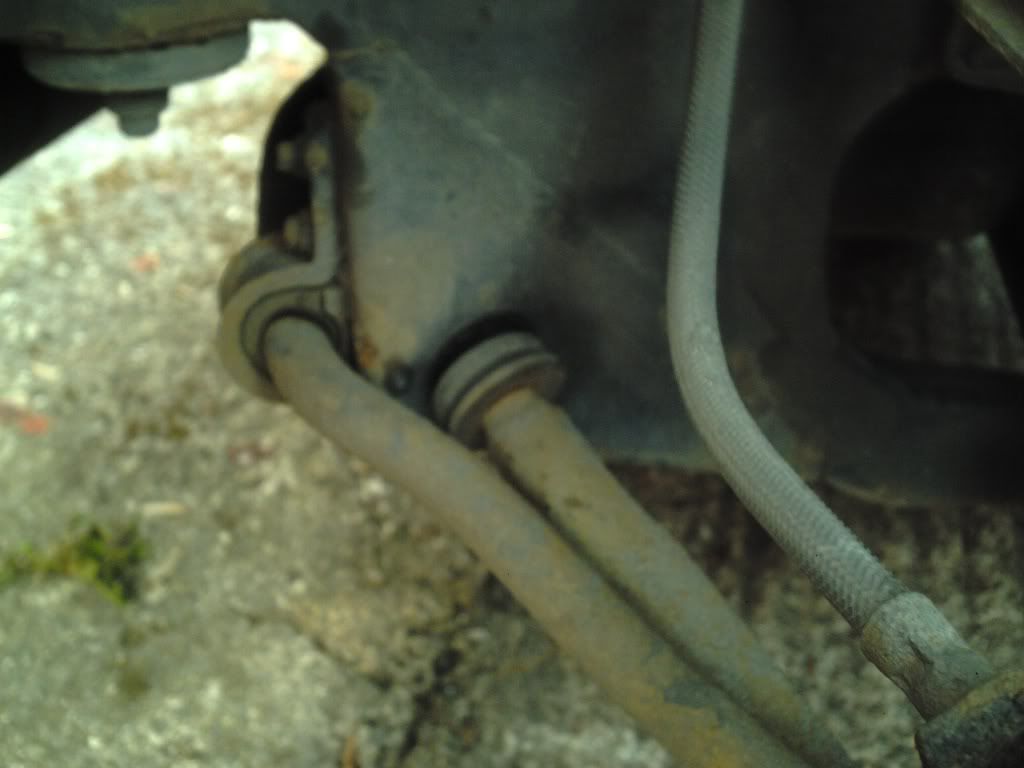

The joints on the exhaust were all blowing so I've managed to nip them up bar one. The first joint after the manifold needs a new clamp but the others are now fine. I topped up the dashpots with ATF, replaced the float chamber gasket on the front carb, balanced the carbs (the old fashioned way with a tube), set the points and hey presto, the car now runs like a dream. I'm sooooooooooo pleased! Trouble is I've run out of money until the next pay day.
This is the list of jobs left to do:
Replace the front shock absorbers (they've started to leak)
Replace the front springs
Rebush the suspension
Clean and repaint the wishbones, trailing arms, etc
Rebuild the carbs (I might not need to do this as Brown's running fine. It depends on fuel consumption)
Change the engine oil
Change the oil filter
Replace the bottom ball joints
Replace the steering column bulkhead bush
Respray bonnet, bootlid & roof
Fit BL badges on the front wings
Replace the brake hoses
Replace the steering rack bushes
Replace the wing mirrors or fit door mirrors
