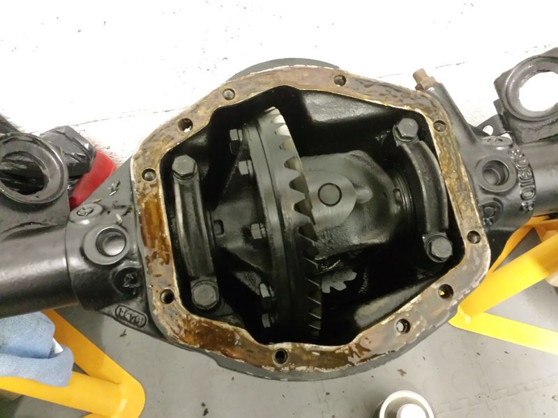

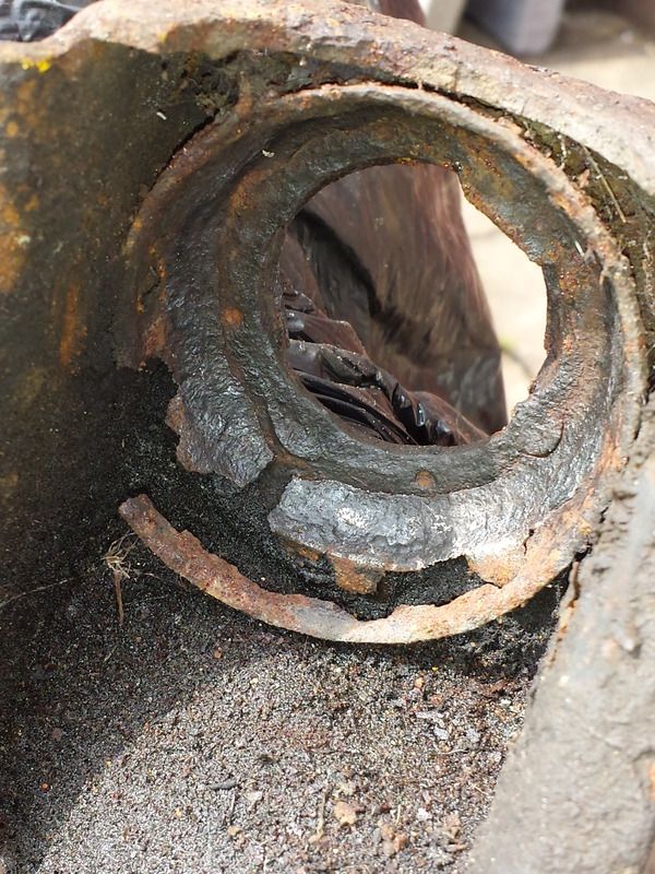

When I dismantled my original car it became apparent that my axle was in quite poor condition. Although not especially noisy it was extremely leaky from every orifice and more worryingly the tie bar mounts were heavily corroded. Looking at the numbers in more detail I don't think it's the original one either. Someone had at some point fitted a hub, or complete half shaft with 3/8" studs on one side, the other was the correct 7/16" size. I had previously purchased new hubs, studs and seals etc with a view to refurbishing it.

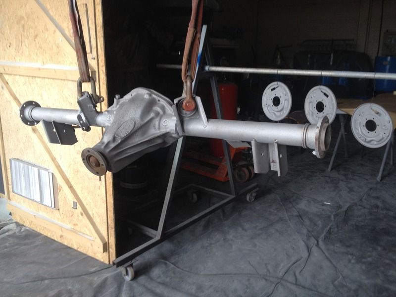

When Mike Papworth was working on my gearbox he offered me a complete Sprint axle which had good mechanicals and no major rust problems. This seemed like an attractive option so a deal was done and I decided to use this axle, keeping my 'original' as a spare.

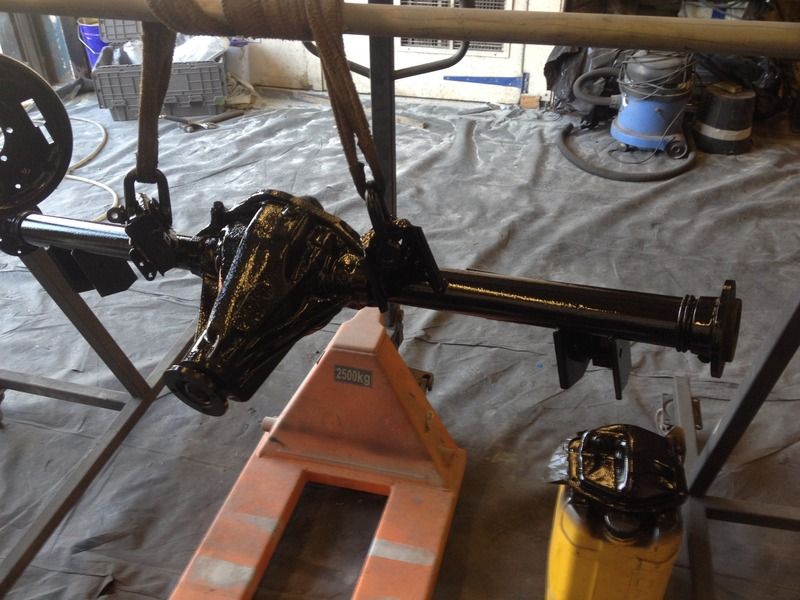

In order to get a nice finish I stripped off everything from the outside and sealed up any holes in it before having the outside blasted and then as the blaster was getting into painting he offered to paint it for me too using epoxy mastic paint which gives a nice, if matt finish. He also blasted and painted the rear back plates too.

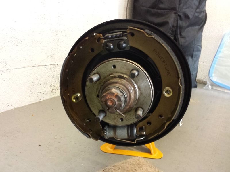

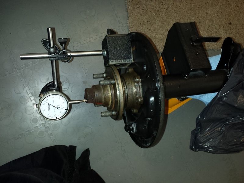

When I got the axle back I perched it in the garage and it was a few months until I got on with the next job. I started by inspecting the half shaft and hub assemblies I had in stock. In total I had 4, one looked very oily, one was the wrong sized studs and the other two seemed pretty good so I chose to use those. My original plan had been to strip down the assemblies by removing the hubs and replacing the seals and bearings etc. Of course removing the hub is very difficult and though I had picked up the proper Churchill factory tool I figured that this was just making work for myself and therefore I chose not to do this, instead after a bit of a clean up I went ahead with the half shafts I had.
Before I fitted new seals I had a go at setting up the end float with my new drum back plates. After messing around with various shims I got it just right. That was in May of 2015, work then stopped as I started a difficult time.

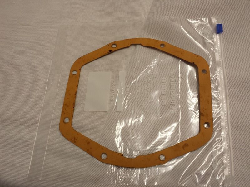

As I now work at a company who works with, races, fixes and restores classic cars I thought let's see what we use at work. My boss pointed me to a drawer full of gasket paper and so I set about making my own. I used a material which is a mixture of nitrile and paper so it's good with heat and also for applications which are prone to leaking. Sounded perfect. On taking off the diff cover I found that despite being removed for painting an original paper gasket was actually stuck to the underside of the cover so I peeled it off and used it as a template for making my own. Cutting it out to fit was straight forward enough and my trial fit proved it was perfectly adequate.
I took the advice of our axle builder who recommended I use a little Heldite jointing compound on both faces. You brush a thin layer on, leave it for a bit and then bolt it together. I have not yet filled the diff with oil but it does seem to look OK and it was satisfying work to do.

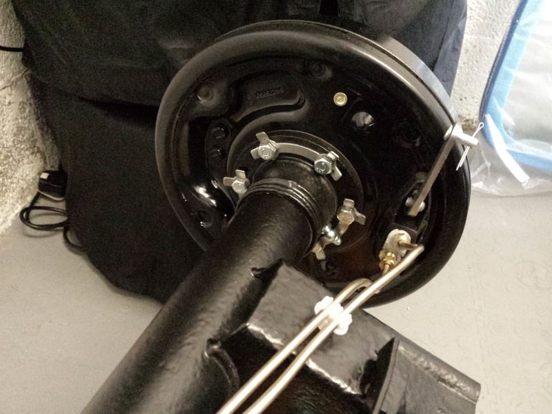

Next my attention turned to the back plates. I chose to use some NOS back plates as the used ones I had didn't have the quality of finish I was looking for. These had been blasted, primed and painted a few years ago. I built up the backplates c/w wheel cylinders, handbrake levers etc off the car. I then fitted the new back plates onto my axle with the half shafts I had previously fitted. I checked my end float again and whilst one side was perfect, the other was miles out. This meant setting up the end float again from scratch but it did really need to be done.

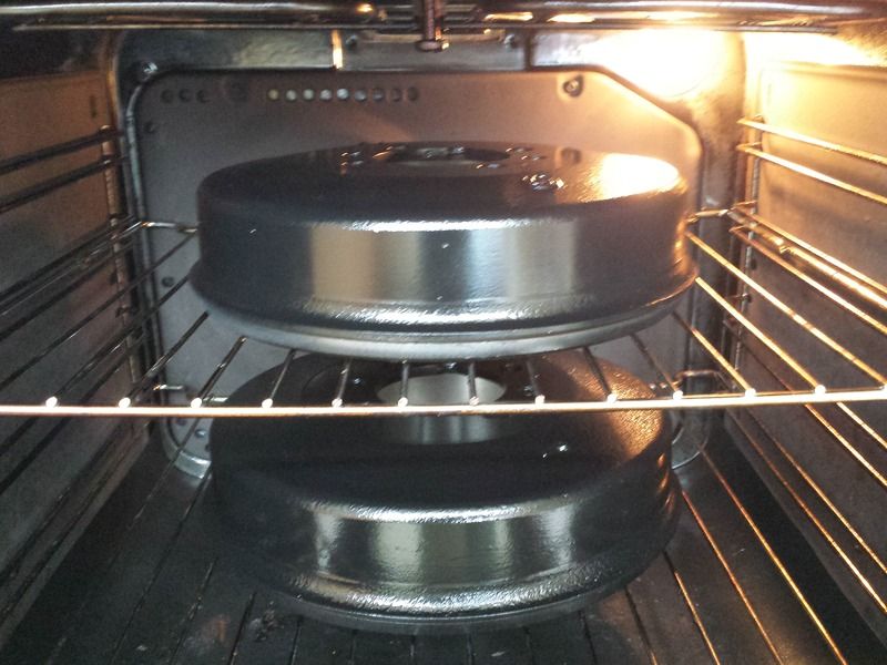

Next up were the drums. These were again NOS which I had picked up from someone nr Preston about 10 years ago. They were covered in protective wax/grease which took some time to clean off. Then I gave them a good going over with a wire brush on a drill, wiped them over and then gave them a coat of calliper paint which is both tough and good for bits that get hot. As part of the process I had to cure the paint. I waited until the wife was out and then borrowed the oven to bake them for an hour or so at about 100 degrees.
With the drums painted I could fit them using the nice and shiny new screws I had bought. One side went on perfectly, the other seemed a little tight. Having tested another drum it seemed that one hub was a bit tight so I lightly dremmelled the face to remove a few thou, drum then fitted perfectly. it's worth pointing out that before I fitted them I actually balanced the brake drums using equipment at work. Balancing the drums is a good idea as they are often not very well balanced as this can ruin the ride and not do your bearings any good either.
I then moved onto the brake pipes. I already had sections of kunifer cut, flared and unions fitted so it was 'just' a case of bending them to shape. This is not my favourite job and the end result though OK is not as good as it could be. Fortunately you don't really see it when it's fitted!
With everything now assembled the axle is now pretty much complete. I do need to properly bend over the securing tabs on the back. I thought I'd do that at a later date just to make sure nothing needs to come out as they are a real pain. I actually pre-bent them slightly to aid the proper bending over when I do that bit.

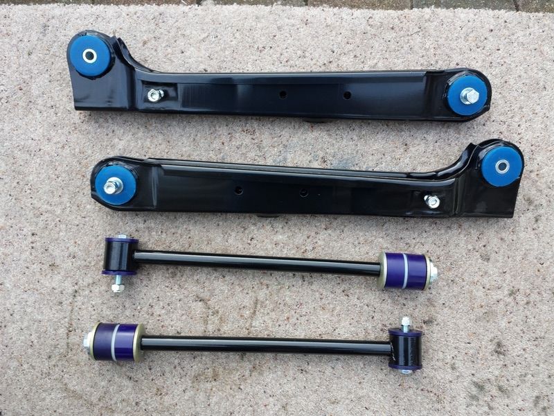

I have also been working on the suspension components too. I had previously bought some new trailing arms, tie bars , anti roll bar, springs and shock top mounts. All were blasted and powder coated which gives a nice finish. I chose to fit new polyurethane bushes which were quite easy to fit using a hydraulic press. For the trailing arms I opted to go for Polybush branded versions. These come in 2 halves so are even easier to fit. The Superflex versions come as one piece and are all a bit stiff. The Polybush comfort grade fitted here is a much closer match to the original rubber ones. I did consider fitting new rubber bushes which I removed from the new arms but decided that actually the Polybushes would be better. I know some people have questioned the wisdom of fitting polyurethane bushes to the trailing arms as they believe they cause the arms or body mounts to break. Given the mileage I will do, the use it will get (i.e. not extreme) an the fact that neither the arms nor mounts are rusty and old the Polybush comfort seemed the only way to go. I can always change them again if I have any worries.

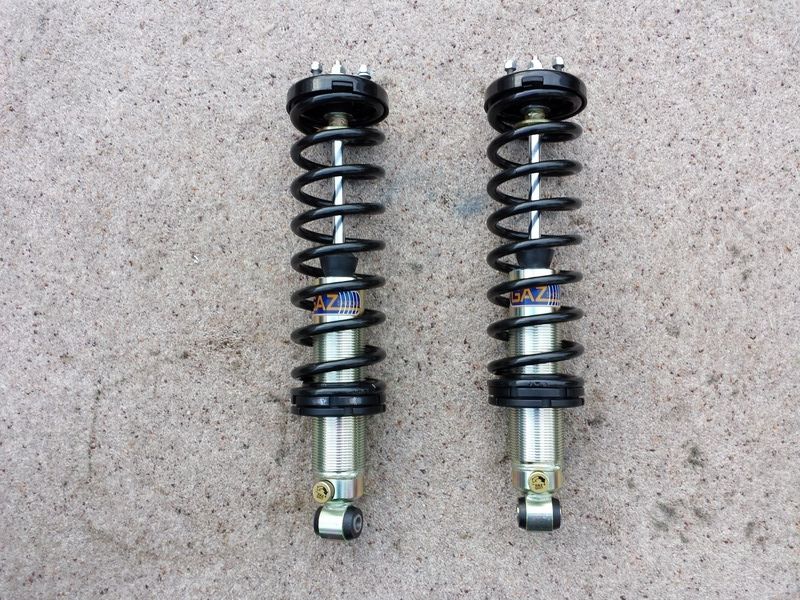

Shock wise I had in stock a set of Gaz adjustable height and ride front and rears. The springs I used are standard, actually NOS ones from Fitchetts which actually fit the top mount! With the height platform wound right down it was easy to fit the springs to the shocks without a spring compressor. I have not yet set the final height for these, they will be easier to adjust when they are on the car.
Finally I collected and allocated all the nuts, bolts and washers etc. to put it all back together. The next job will be to remove the old axle and fit the new parts to the car. It might be a little while before I do this. Not because I don't want to but because I may need to move the car in a short while and I don't want to immobilise it.

Looking great Mark, I love the incriminating oven shot :mrgreen:

Remember our telecon some time ago about the stainless steel spacer within the poly bushes - make sure that the stainless steel spacer is slight protruding pass the outer face of the poly bush - if not you will end up with annoying sqeek when the susppension goes up and down like I did, maybe its the positon of the rear tie bar but the spacer does not look it portruding see attached picy
Also you may have the open (make it wide) where the damper secures to the rear trailing arm (i had to open mine using a stretcher bolt) as the dimension of the lower damper mounting point is larger then the dimension in the trailing arm
Do a trail fit of all parts before bolting them to the car

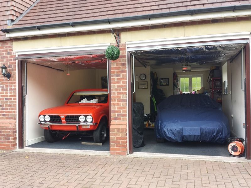

I moved my car the other weekend. Work were able to lend me a van and covered trailer and I borrowed a colleague and bribed him with some folding to help out as he has towing experience. Loading up at the old place was fairly easy, as was the 15 mile trip to the new house. Unloading was a little more difficult due to a slight uphill slope on the drive. The van clutch stank but we got there in the end.
The car now resides next to my Mazda in the garage with its carpet tiled flooring! All my car parts have now been moved as well. In fact I have also put the shell on stands ready to swap the rear end out for the newly refurbished one.

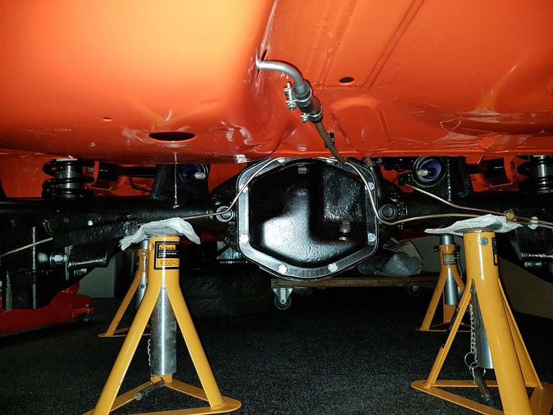

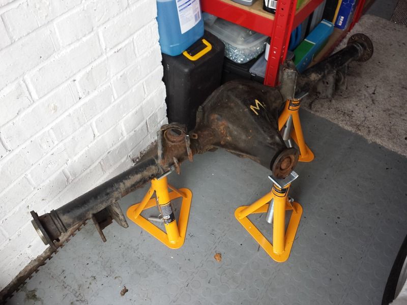

My project shell came complete with a rear axle and front assembly so I’d re-attached these when the shell was painted to enable easy moving in the garage, and of course it was very helpful when I had to move house. My first job for some considerable time was to set about installing my refurbished axle and suspension components. Removal of the old ‘temporary’ unit was pretty straightforward, at least in terms on undoing the nuts and bolts as they were not on especially tight. Supporting the axle whilst lowering it was a little tricky as it didn’t balance terribly well on my jack but between my wife and I we were able to lower it easily enough. I didn’t know the condition of the unit and didn’t really want it so a quick ‘Free Ad’ saw it taken away by a club member direct from the garage which was a real help.
Knowing my parents were visiting I knew I had a good opportunity to have some assistance with installation. Dad has plenty of experience installing these things on his cars over the years. First job was work out how to man handle the axle (complete with half shafts, drums etc) under the car. I had a handy wheeled board which slid under nicely then we got it onto the jack and raised it up. Some fiddling followed and we were able to attach the lower trailing arms and roughly position the upper tie bars. This way I knew the whole unit was roughly where it needed to be.

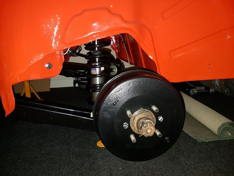

Next job was to install the shocks. I’ve chosen to fit Gaz height and ride adjustables to the car, mainly to allow for some lowering from standard but without going too far. I’ve retained standard springs, these were new old stock items but I had them powder coated as I wasn’t happy with the finish. As the car is not yet loaded I chose to set the height approximately, 140mm from centre of the bush to the top of the seat. I used copper grease on the threads and also a smear on the seat to prevent sticking.
Though I was initially confused it became apparent that the shock units would only fit one way so after the application of some Dum Dum to the top mounts, I lowered the trailing arms they slotted in easily enough.
The tie bars were rather more awkward. I’d fitted the axle without these but by raising the axle slightly and wiggling it around a bit I was eventually able to fit the rearward bushes, washers and nut. Currently these are not fully tightened nor have I put the R clips on. Last job was to attach the rear, anti roll bar. Like the other components this is a new old stock one, powder coated and fitted with shiny, new high tensile nuts and bolts.
I’ve still got some work to do on the back end, chiefly to fit the handbrake cables, brake bias valve and bend over the lock tabs. But it’s pretty much there.
