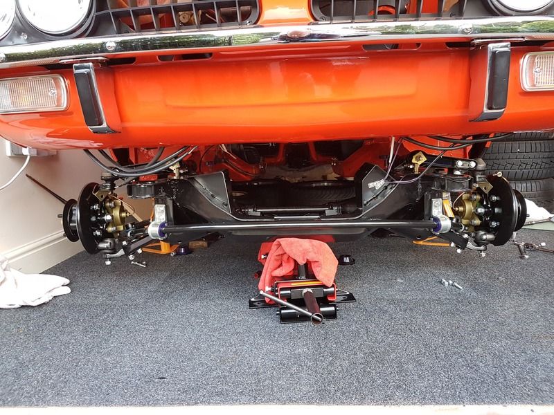

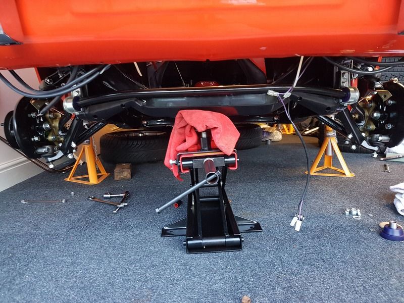

Installed the subframe this evening. I'd put it onto a small motorcycle scissor lift and wheeled it under the car on my trusty board. A bit of adjustment, some winding it up and it went straight on, no real dramas.
Just the one slightly rubbish pic as the phone complained it needed feeding with electricity again.
I actually removed the dampers to put the subframe on as they got in the way. Putting them back on will be the next job, I had to turn them around anyway to point the adjusters inwards. There's lots of nuts and bolts to be tightened up a little before I can lower it back down onto the wheels then I can tighten them properly with some weight on it. Then it'll be a case of finishing the brake pipes and fitting the steering joints.

Nice one Mark its great seeing the frame in :). To save chipping paint or powder, when you need to lift the lower arms to get the shock bolts in, fit a socket onto the lower ball joint nut and put the jack on that. :thumbsup:

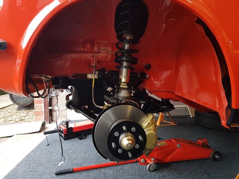

I went to fit the shock assemblies but of course found they were too long as the springs had not compressed enough to allow the bottom bolt to go in. After much deliberation I decided it was easiest to lower the subframe again, attach the shocks and then wind the whole assembly back up.
This strategy proved effective and actually very easy. I highly recommend the use of the little scissor lift I used. The subframe is nicely balanced on it and it's extremely easy to wind it up and down, and indeed to move the whole unit about to get it lined up with the bolts. It seemed like an expensive tool to use once so glad I've been able to use it twice!
With the whole assembly now mounted I've finished off the brake pipes and flexi hoses and attached the steering joints and column. I've got some jobs to do at the back end whilst the car is still on stands then I'll lower it down onto the wheels and undertake a little tightening of nuts and bolts. I'm thinking of buying some wheel dollies as the car is quite tight up against one of the garage walls and it's not very easy to move, the wheel dollies should work well on my carpet tiles which are smooth and even.

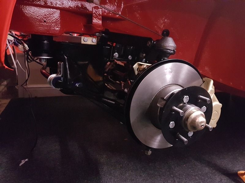

This doesn't look right to me…the subframe seems to be far away from the body, especially at the back.
The upper bush should be in compression.
The usual cause of this not being so is that the ferrule is too long.
At the front, there should be a couple of threads proud of the nylon nut.

Fear not, I did tighten it up some more after this picture was taken. When it's down on the wheels I will check it again. I'm assuming that all the bolts are loose currently across both front and rear so I have quite a few to torque correctly.
