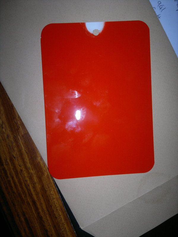

An exciting time today as I picked up the colour sample.
You can't get much impression from a photo of course but i've checked the match against the original (albeit re-painted) shell and it's not far off so with a little work it should be there. Work will commence next week, the delay being caused by me basically dumping the project on them.

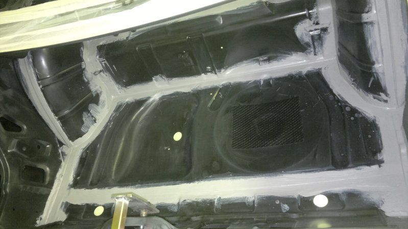

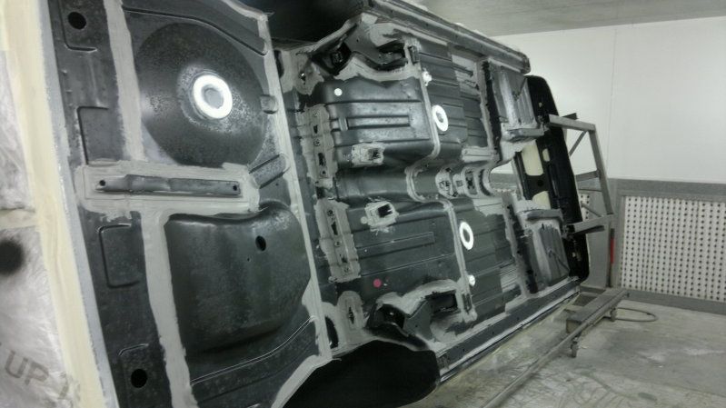

One of the most important stages though was well underway when I popped in the other day. When they were new the application of seam sealer and underbody coatings was pretty poor to say the least which lead to an early death for many a Dolomite. I decided that if it were possible to improve on the original application of both of these then I would do so. With the car on the spit Paul and his team have gained perfect access to all the underside of the car to apply seam sealer where required. In particular the rear wheel arches needed some work to ensure that any gaps were filled to prevent leakage into the boot etc.
Also the heat fusiable anti-drum pads have been installed on the floors and also the boot floor as per original style. I'll employ better more modern style pads for inside the rear panels and doors as these are not really seen. The caulking gun has also been hard at work on the inside of the car.
Originally I could not detect any seam sealer under the bonnet around the turrets etc. Paul was unhappy about leaving these unfilled so we settled on a 'wipe-in' application to help prevent problems with the joints here. By the time it's painted you won't even notice.

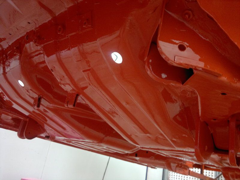

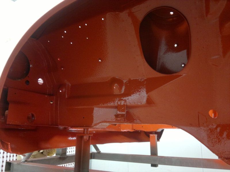

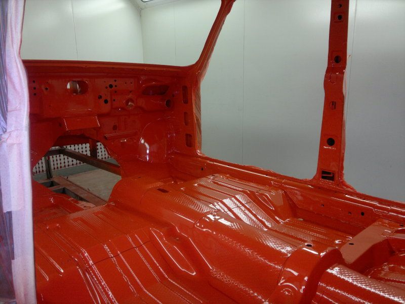

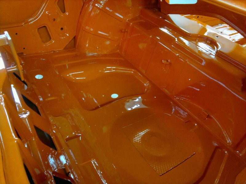

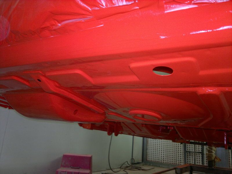

Typical you wait ages for an update then two come along at once. Got a call to let me know that the car is now wearing Orange paint underneath and inside so I popped down to have a look. Still lots to do but looking good, colour doesn't photograph well though with flash. Paint coverage is way above and beyond what was used new with no thin areas or unpainted areas to be seen. Of course it's very shiny too, seems a shame to cover it up with carpet and interior bits.
In the boot
Engine bay
Under the boot
Under the front arch
Rear Arch (note the stonechip texture)
Inside
Back end somewhere
Next job is to prepare the rest of the body for colour. Next time I see the outside it'll be in a grey/brown primer which is like a high build. At this point I'll need to sign off the alignment etc before the colour is put on. The satin black on the back and sills will also be added. The sills will benefit from a smooth epoxy primer for added chip resistance prior to being overpainted in regular paint. Not original as such but probably better for durability.

Wow...! What an epic bit of work... I must say you were darn lucky to have managed to nab that factory shell sir :shock:
I think that making it better than factory but not 100% concours is the right way to go as I can imagine the costs just spiralling out of control and it'd just end up being (perhaps) just too good to use...
This looks like something quite special will come out at the end and I just cannot wait to see the end result...!!!

PostPosted: Tue Sep 04, 2012 7:31 pm
Outstanding is a word that springs to my mind. 8)
Yes amazing the variation, everything through from light brown to pink, but the gloss and finish is ace - no problem seeing that.
Top
PostPosted: Tue Sep 04, 2012 8:20 pm
Like Alan, I can't tell the pink from the brown but yes, that shine is mightily impressive all over the car, whichever colour we're looking at.
It'll almost certainly be "too good" for concours d'état, but concours d'élégance might suit the finished article better since that particular discipline's all about the shine. That, and having things that were never shiny originally shiny for their kind of anally retentive so-called sport.
Just make sure and fire plenty of Ensis V at it, especially inside every single box and channel section you can find. If it doesn't drip on a warm day, it's not amply protected. :wink:
Indeed it will be filled with the sticky stuff. Not sure what but PF Autos are VAG approved body centre so I imagine it will be something that they use. Can't remember the last time I saw a rusty VW! I know he said it was brownish so it was easier to see where it's been applied.
