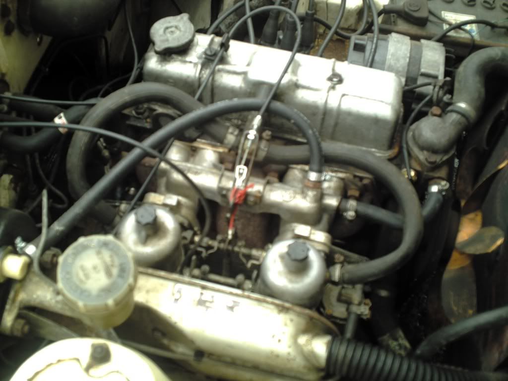

Mine had the same steering wheel as yours. Here's a few photos of mine.

The twin carbs and Sprint alloys (with 185 tyres) were just two of the improvements I made. I also fitted Sprint seats which were 10 times more comfortable than the original vinyl seats. Take a look underneath and you might spot something obvious. On my Sprint I noticed that one of the clips on the end of the tie bars (which stop the nuts from coming off) was missing so I tightened up the nut and fitted a replacement clip. If you need my help you know where to find me. You don't have to wait for the weekend either. Give me a tinkle (landline or mobile) and we can arrange something during the week if you want. When I replaced the bushes on my Dolomite 1300 (another improvement I made) it transformed the back end. No more cringing when I hit a pothole or a speed hump.
