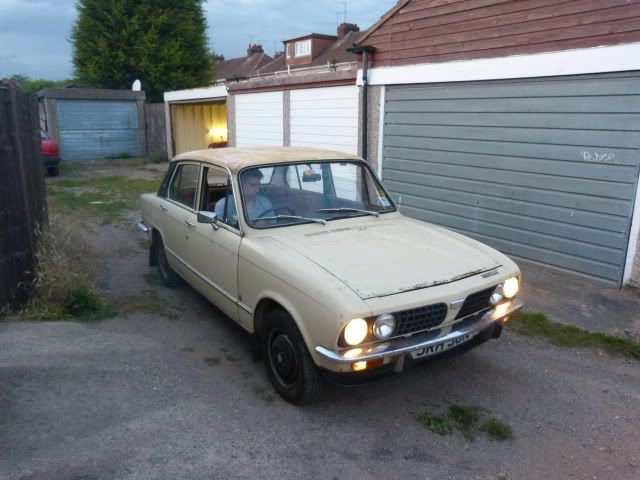

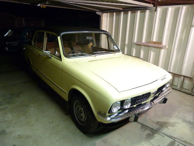

Sitting a home one night I received a phone call from Tom (tom 16v) on the forum, he had spotted a car on Ebay and was keen to go and have a look at it, the car in question was a 1974 dolomite 1850 Auto with 21000 on the clock, it was only local so we plodded over, the car had been off the road and sat in a feild since 2009, 2 ft of grass all around it and covered in moss, apart from a spin around the field it hadn't moved.....The car was solid, only a small amount of rot on the A post, lower n/s wing...all the other rot spots were solid, it even had its original wheel arches......a deal was struck and the car was collected a week later

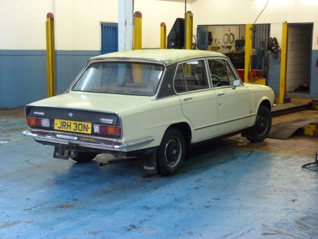

we booked it in for a mot at our usual mot station and drove the car there complete with moss, grass and general crap all over it, the old girl failed but only on bottom ball joints and a sticky front brake, with the work done we took it down 2 days later where it gained a MOT

MOT time

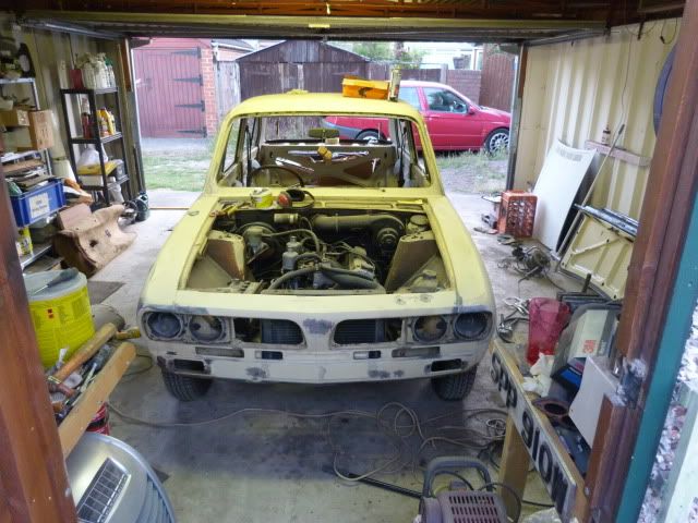

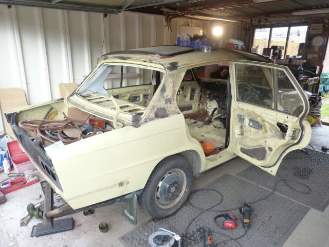

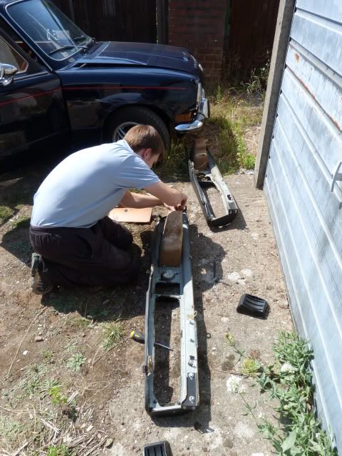

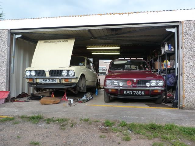

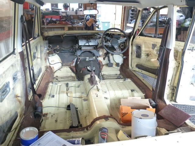

Strip down starts

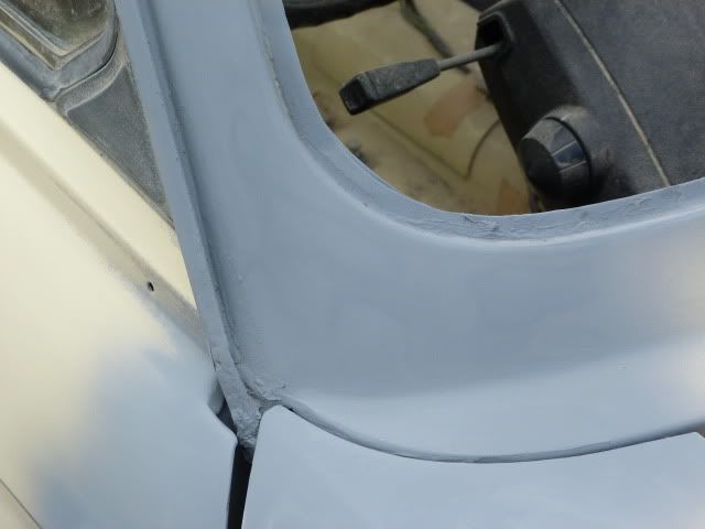

Rot on the A post fixed and prepped

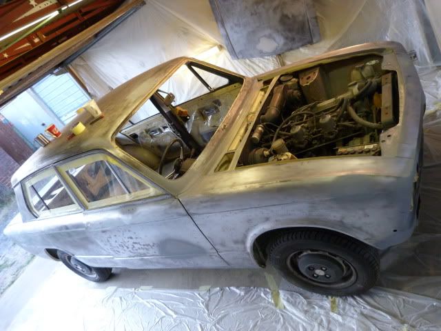

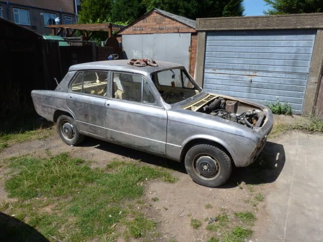

Now this is where the s**t hit the fan, someone had done something wrong and the paint wouldnt harden, it supposed to be touch dry in 16hrs, yet four days later it was still sticky, so the decision was made to fully strip the car and start again......
This is sunday....7 days till we gave the car to Toms dad...

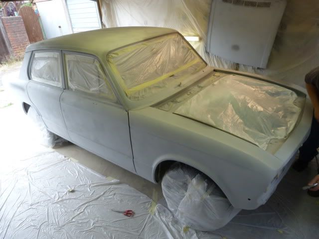

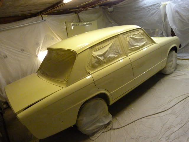

Monday night saw High build primer srayed on
Tuesady night it was time for the Top coat..
Wednesday we rested and let the paint cure

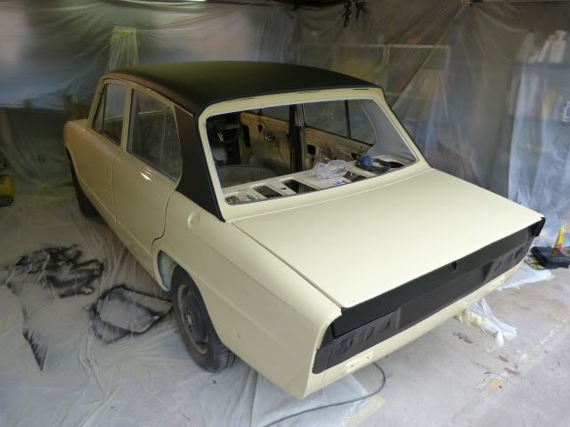

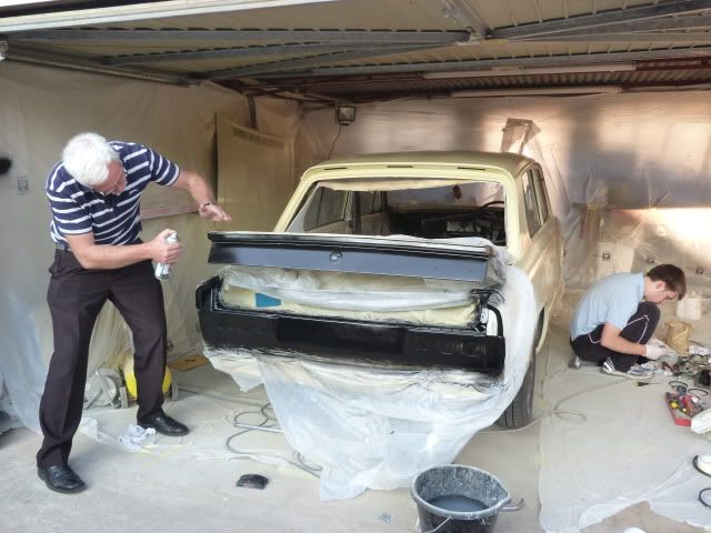

Thursday the black was sprayed on, rad was taken out to be cleaned etc

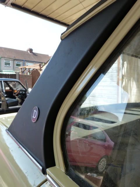

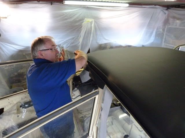

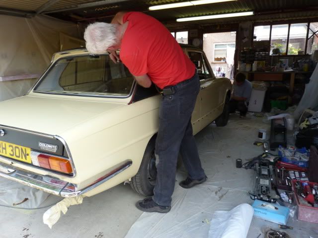

Friday Pete came and fitted the Vinyl roof and pillers,(pete worked for Triumph fitting vinyl roof to Dollys for most of his time there) after he left the windscreen chaps turned up and fit the screens

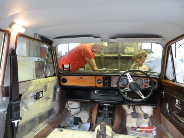

Saturday, 9am, me, Bruce and tom hit the car, 25hrs till we gave it to his dad...
21.45, Still no interior, Bruce and tom have fitted the electronic ignition and trying to set the car up to run, unfotunatly it was a dud dizzy so the original set up was refitted

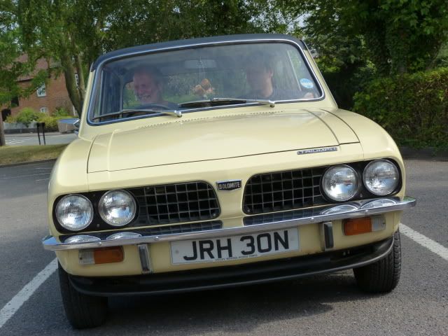

Finished, 2am sunday morning, 8 hours till we give to Toms dad

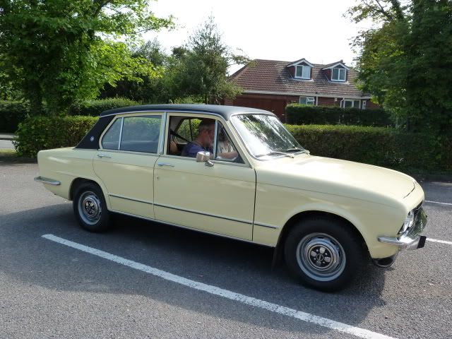

We done it, and got the car there, Toms dad was thrilled and dont think it has sunk in at this point that this was his car!!
The car was there and even completed the 50 mile Treasure hunt!!

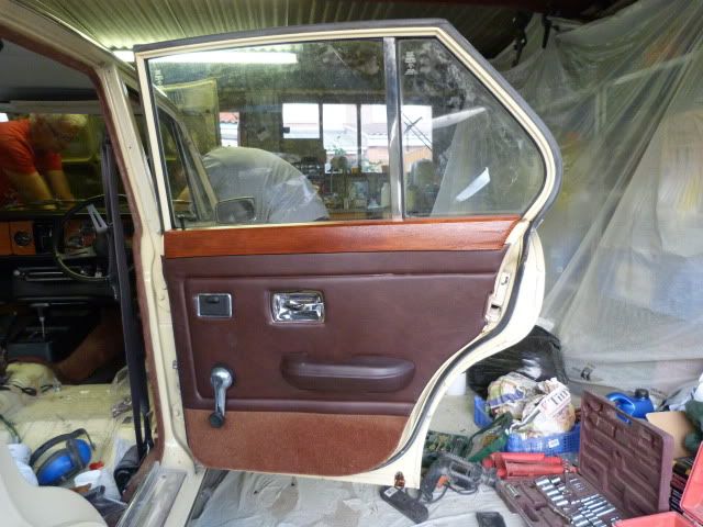

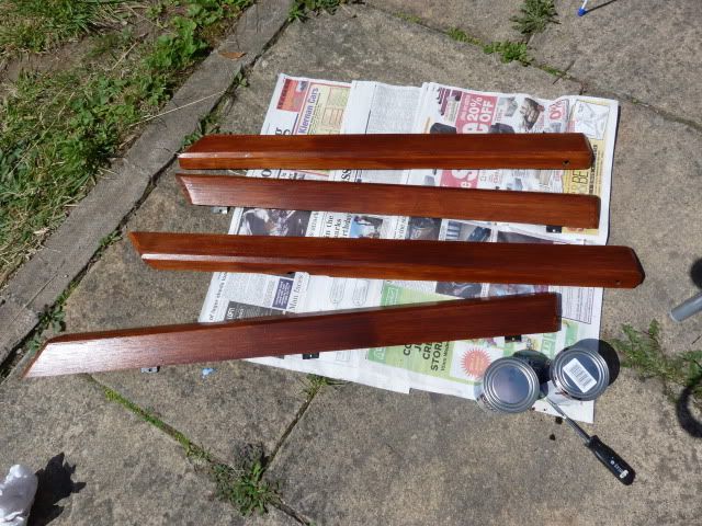

To be fair, Tom, Nathan and Owen did the majority of the hard work, with Yvonne doing a superb job of the door cappings.
