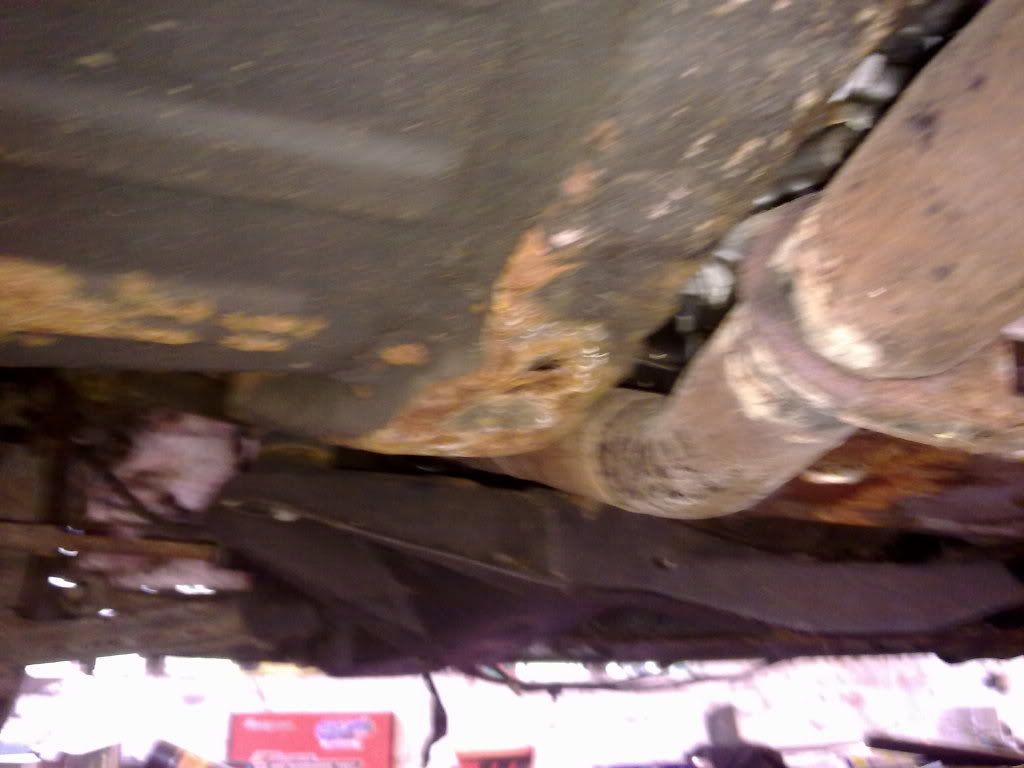

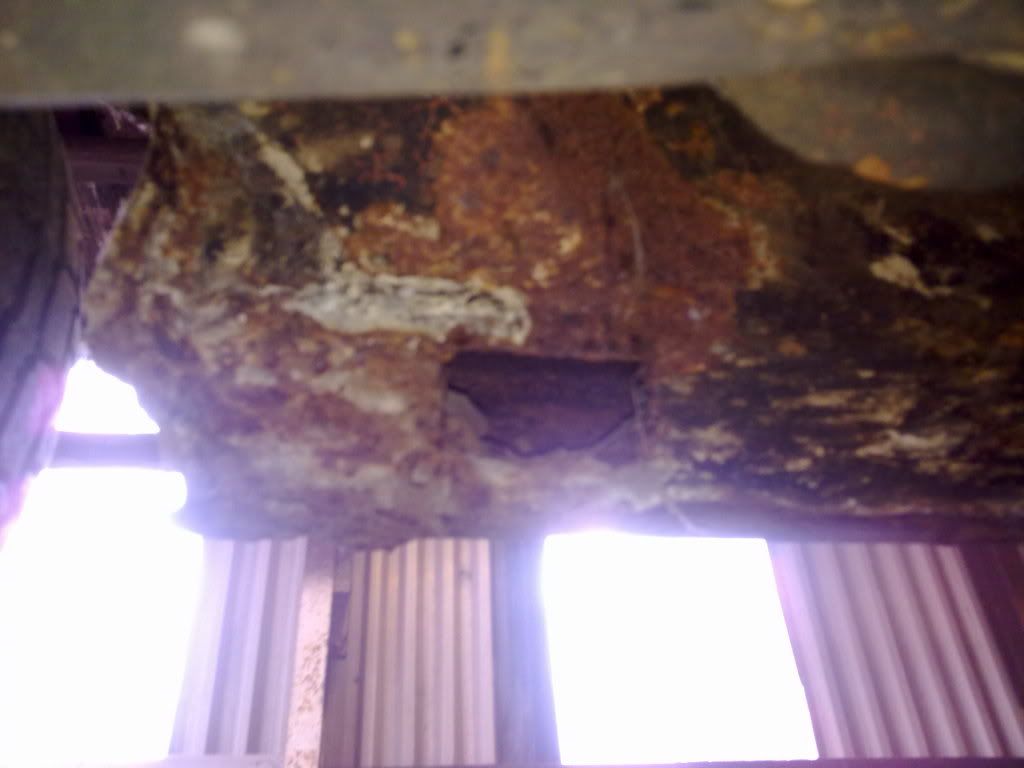

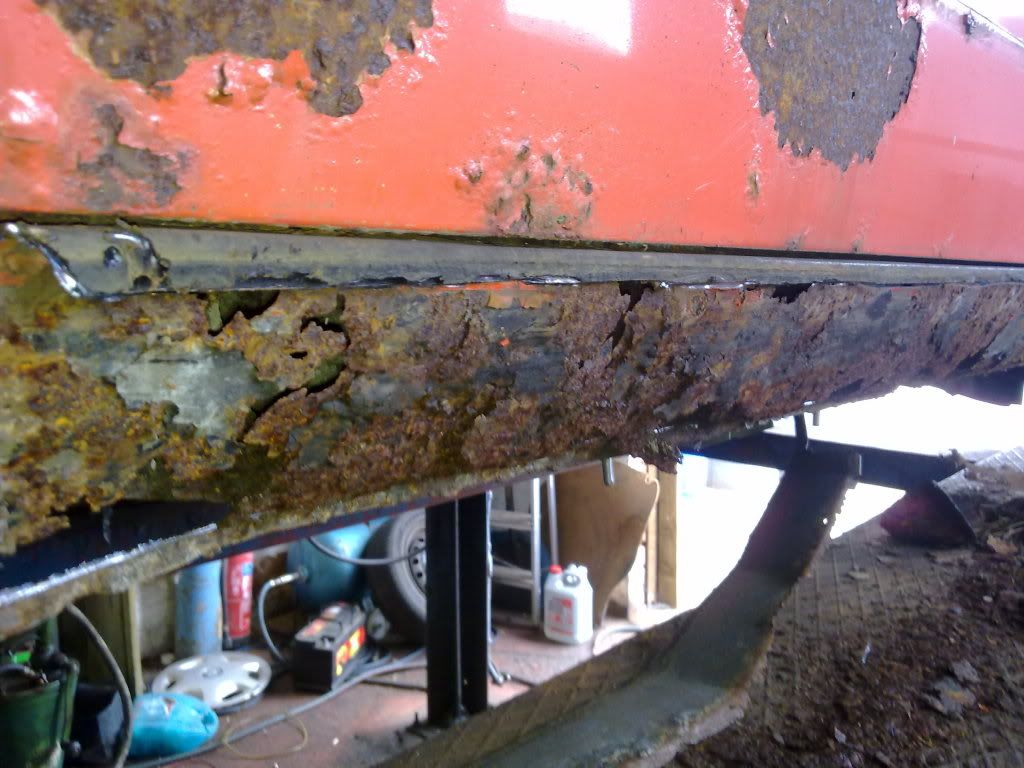

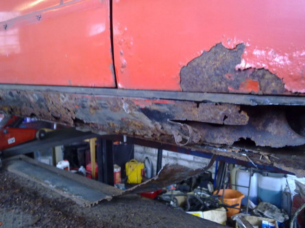

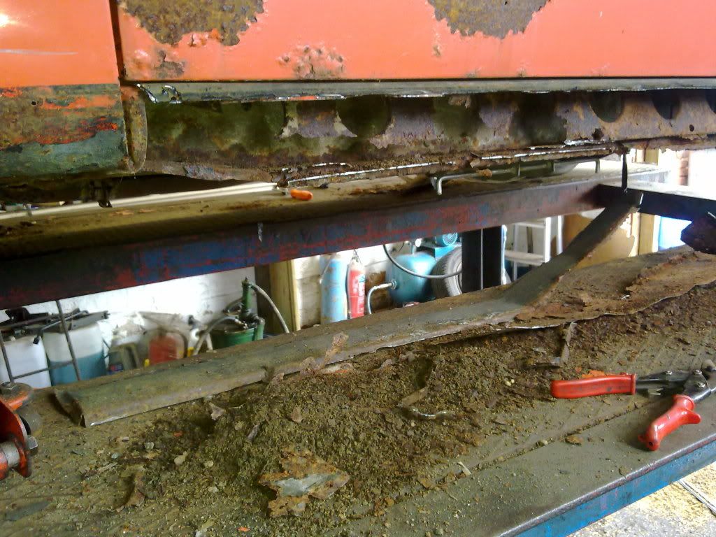

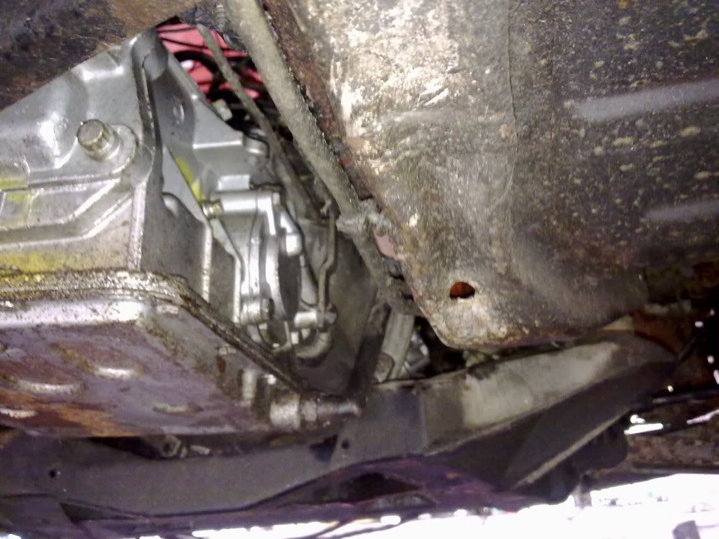

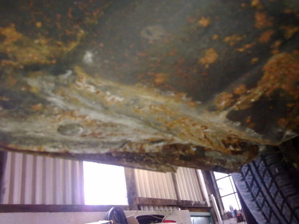

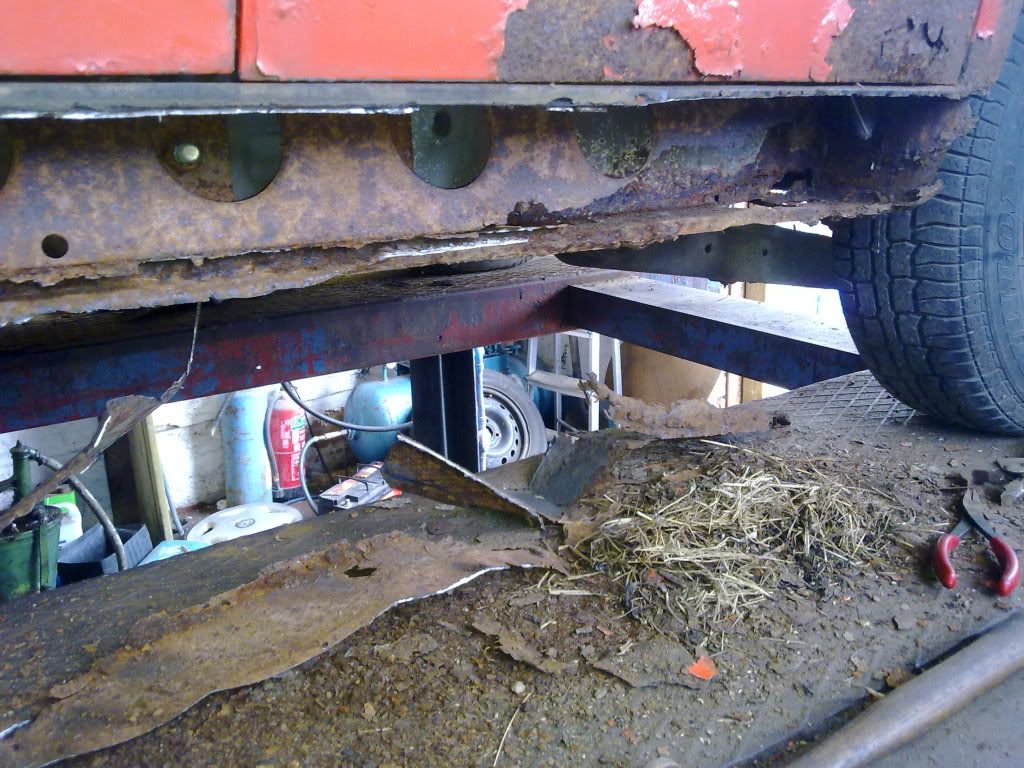

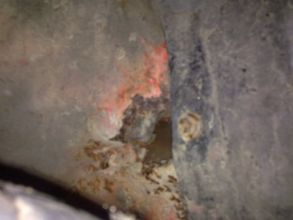

Well I've given it a really thorough going over and the verdict is in, ITS A KEEPER!!! But I wish I knew the name of the bodge artist who put a pair of cover sills on it many years ago, it might help me curse him more thoroughly! This muppet did the unforgiveable (but all too common) trick of hammering in the remains of the original sills then tacking a pair of cheap cover over the top! it wouldn't even pass a current MOT if the sills were sound due to the naff tack welding all round. I've chopped off the worst (NS) side for a look leaving the other in place for now in hopes of maintaining SOME degree of structural integrity!
Its had a degree of patching at the rear of the soffit and a very large upward impact (or possibly extremely bad jacking to judge from the state of the main rails behind the subframe) at the front which has crushed the internals and jacking point and badly bent the lower wing section. The front sill section behind the wing is also pretty rotten so with this and the hole I found in the rear upper corner of the flitch, I think the wing will have to come off but carefully cos its the one good panel on the car!

I know what your feeling right now with the sills. On my TC the same thing had been done, cover sill over the originals on both sides which made the reinforcer's rot like yours. It make's you want to find the bugger that done it :spar: . But then again we get challenged a bit more.
My n/s chassis rail was similar to yours too, but on mine it looked like they had run over a curb and hit the subframe 1st.
How is the rest of the floor and boot looking Steve?

Fear not, Alun, I shall be heading your way shortly with large piles of beer tokens (and a rack for core, I haven't forgotten) However I first need to compile a definitive shopping list! with that in mind, a couple of questions come to mind, 1) I understand that sills and diaphragms are available in Zintec through the club, i'm definitely up for those but how about the soffit section? If not it's no biggie as my next door neighbour is a steel stockholder and has the equipment to fold up sections as well, and 2) With regard to doorskin bottom repair sections, just how far up the door do they go? as you can see from my pix the rot extends at least 4 or 5 inches above the lower swage and though 3 of the 4 door shells are recoverable, its probably cheaper to get better 2nd hand doors than fork out for full skins (I saw a few at Stoneleigh this year for about £90 each!) Any thoughts welcome, Steve
