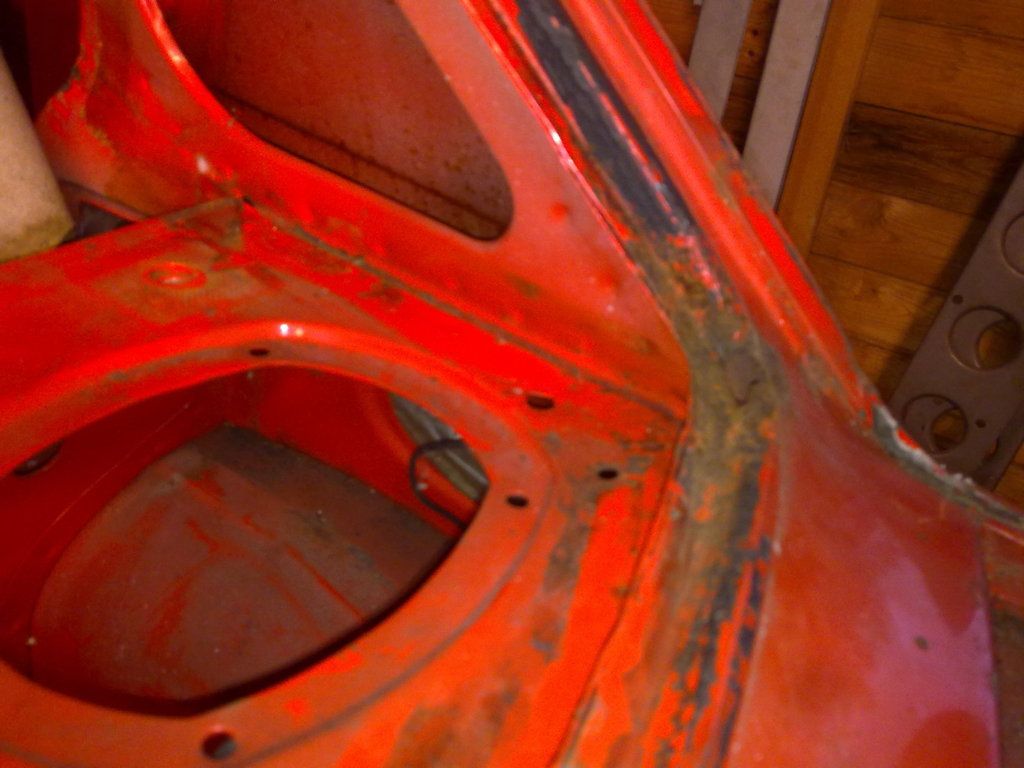

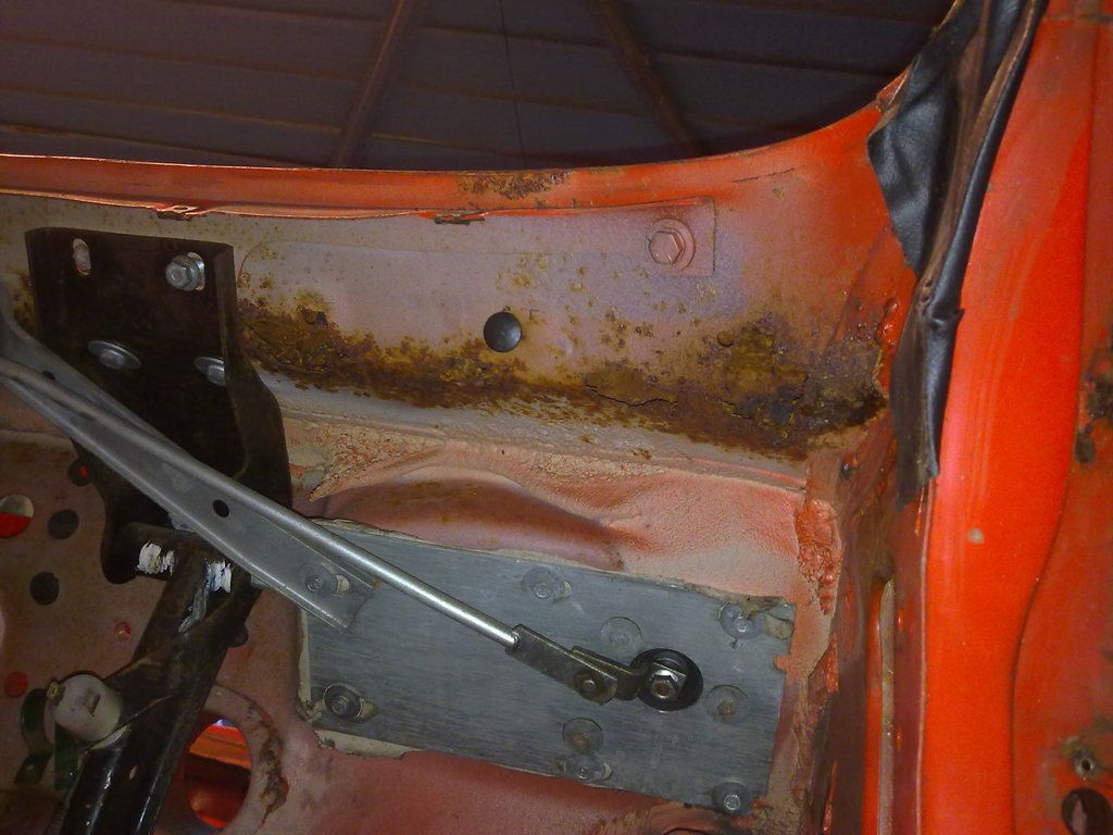

This one has me a bit baffled, I have been congratulating the car on the complete intact-ness of the front screen surround yet this panel inside is badly rotted, it's worse than the pic shows, all the brown bit is lace and holes and will need repairing

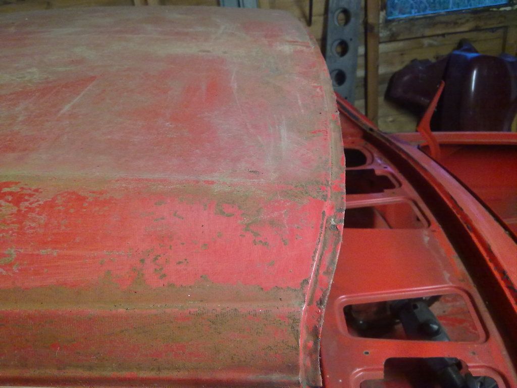

On the up=side, the rear of the roof is fine, both above and below

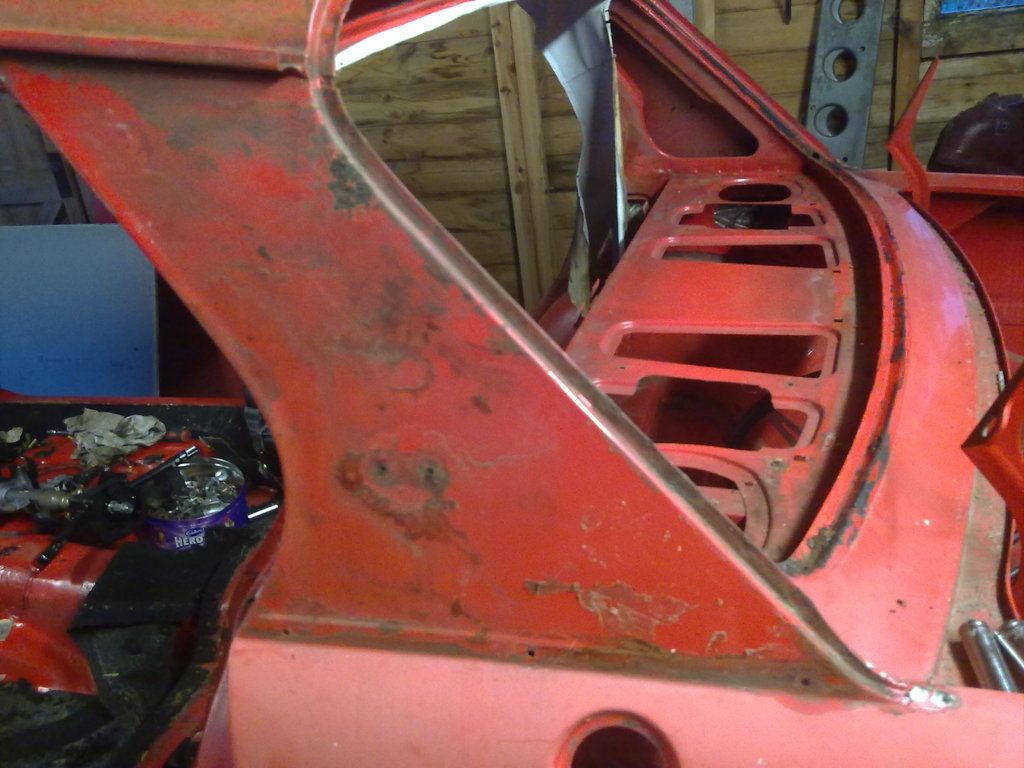

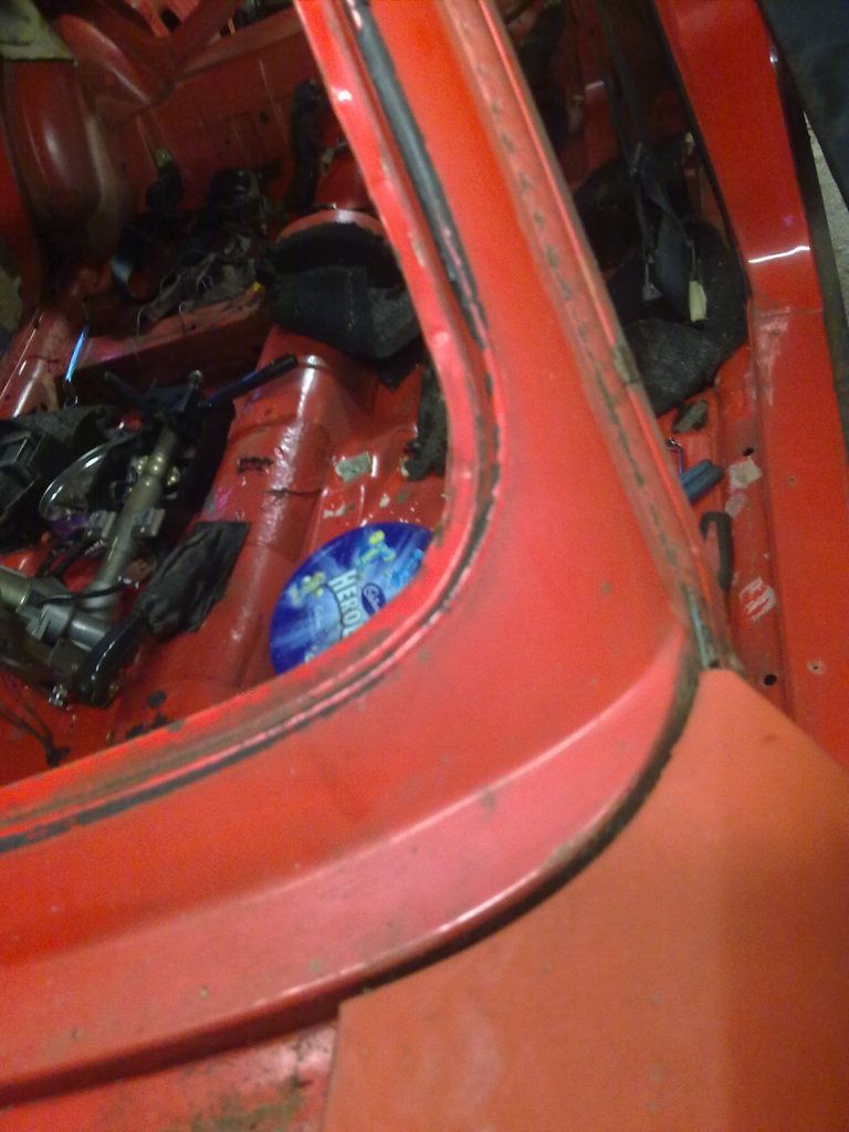

and the outer screen frame is very good

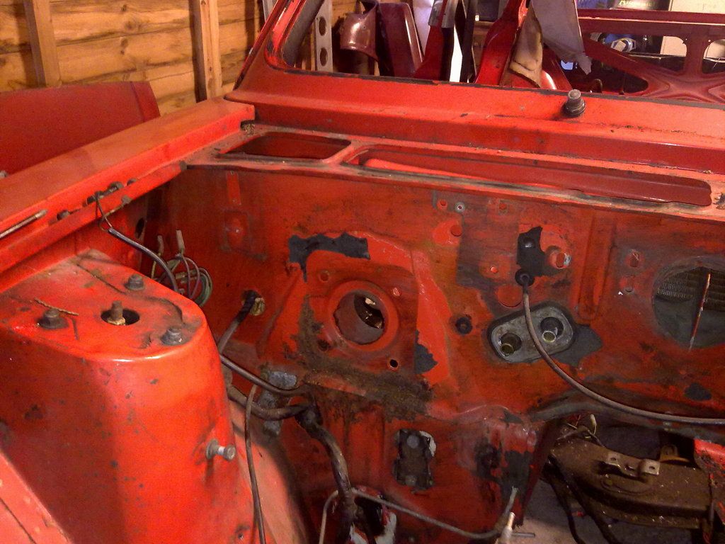

the bulkhead only needs minor attention behind the servo

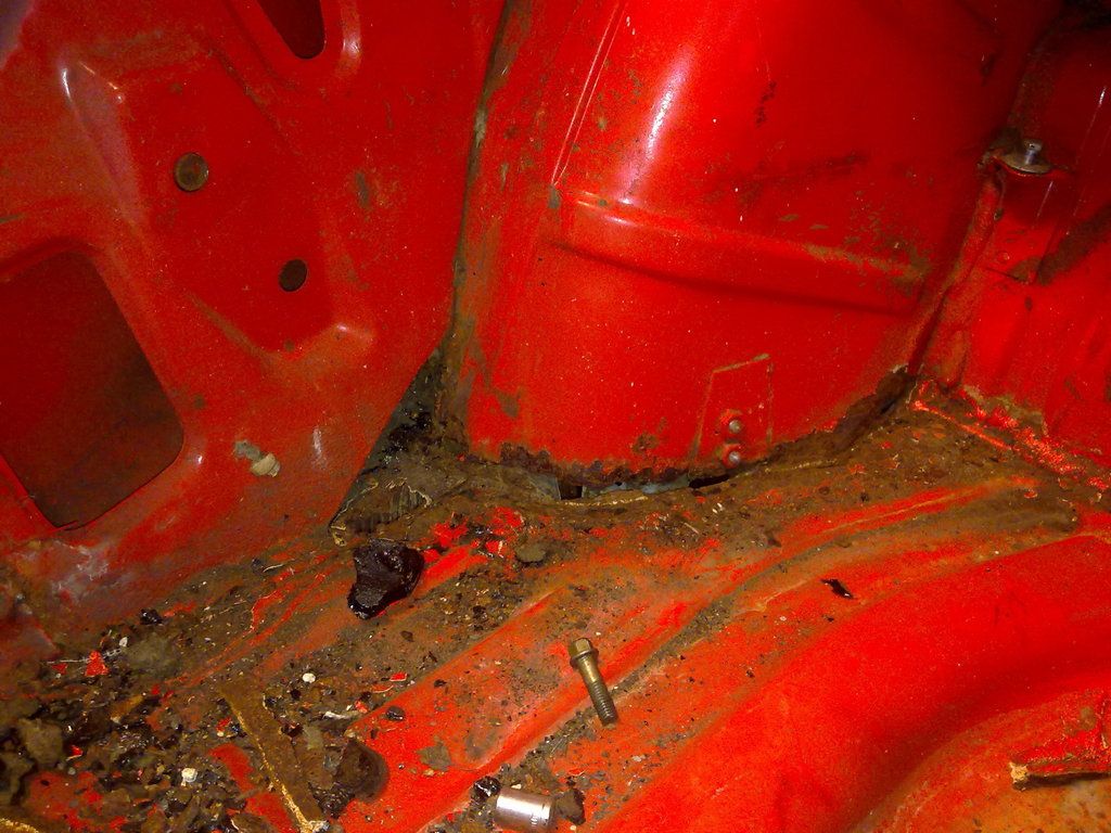

and though its worse than I first thought, probably due to the impact damage which has resulted in a new inner and outer rear valance being fitted long ago, the boot floor is almost certainly recoverable without recourse to a new panel

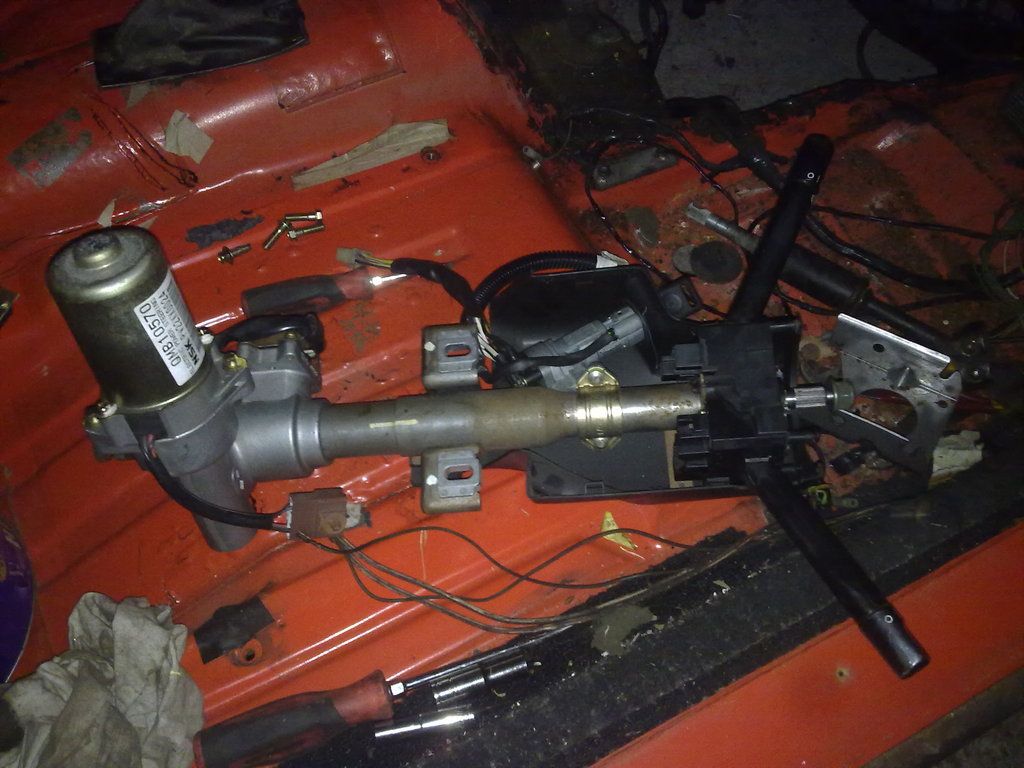

A couple more teasers, the power steering column
I reckon if I cut round the outer, between the motor an the support bracket and move the motor from its current 1-o-clock position (relative to the steering lock and switch gear) to something like 10.30 then weld it back together, I stand a chance of making it work!

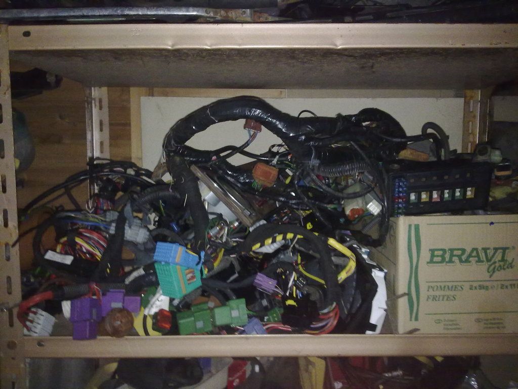

and the wire pile!
this is most of the engine bay and dash loom from the Omega (there is more still in the car plus what's attached to the engine and box) plus the MGF dash harness. It doesn't look much like this, I must lay it out on the floor to expose it's true epic proportions!
Has it rotted through from the other side? If it's where I think it is, are the drain holes in the bulkhead box section clear? There's a thread somewhere explaining where all the hard to find drain holes are.
The drain holes are very thin, like slits. They block so easily. When I was sorting my bodywork out I opened them up a bit - put a punch in the hole and used it to widen it (beat the thing through, including handle!)

I dug out this VERY helpful thread:
viewtopic.php?f=4&t=16792&hilit=find+drain+holes
Quote:

Quote:
Where this has rotted is much higher than the drain holes for the heater cavity (which are miraculously clear) they are about the level of the bottom of the wiper motor mounting plate (the rectangular grey panel, lower right of the pic) the rot is in what I suppose you would call the screen frame reinforcement and is an almost horizontal panel only an inch or two below the screen aperture. My current theory is leaks around the wiper spindles. The nuts on the wiper wheelboxes are solid and trying to undo them is turning the wheelboxes instead of undoing the nuts so i've covered them in plus gas and will try again later, with some big pipe grips on the wheelbox to stop it turning!

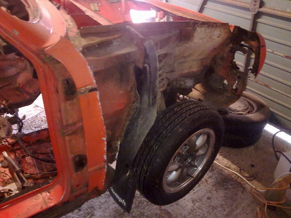

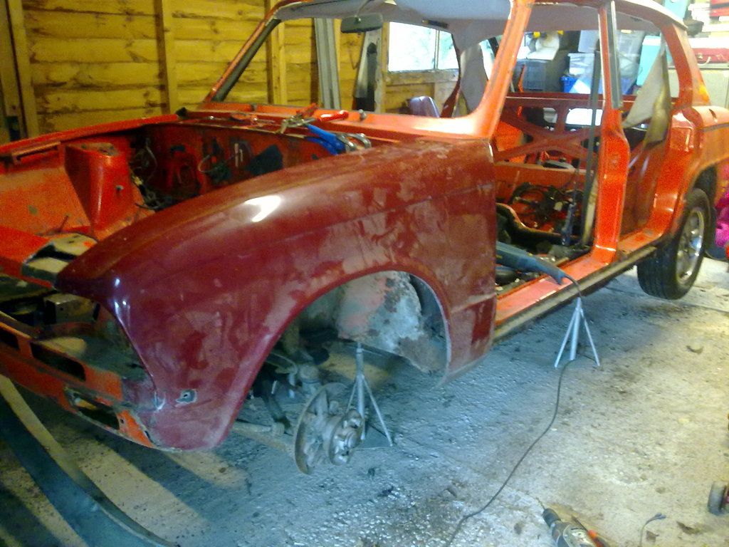

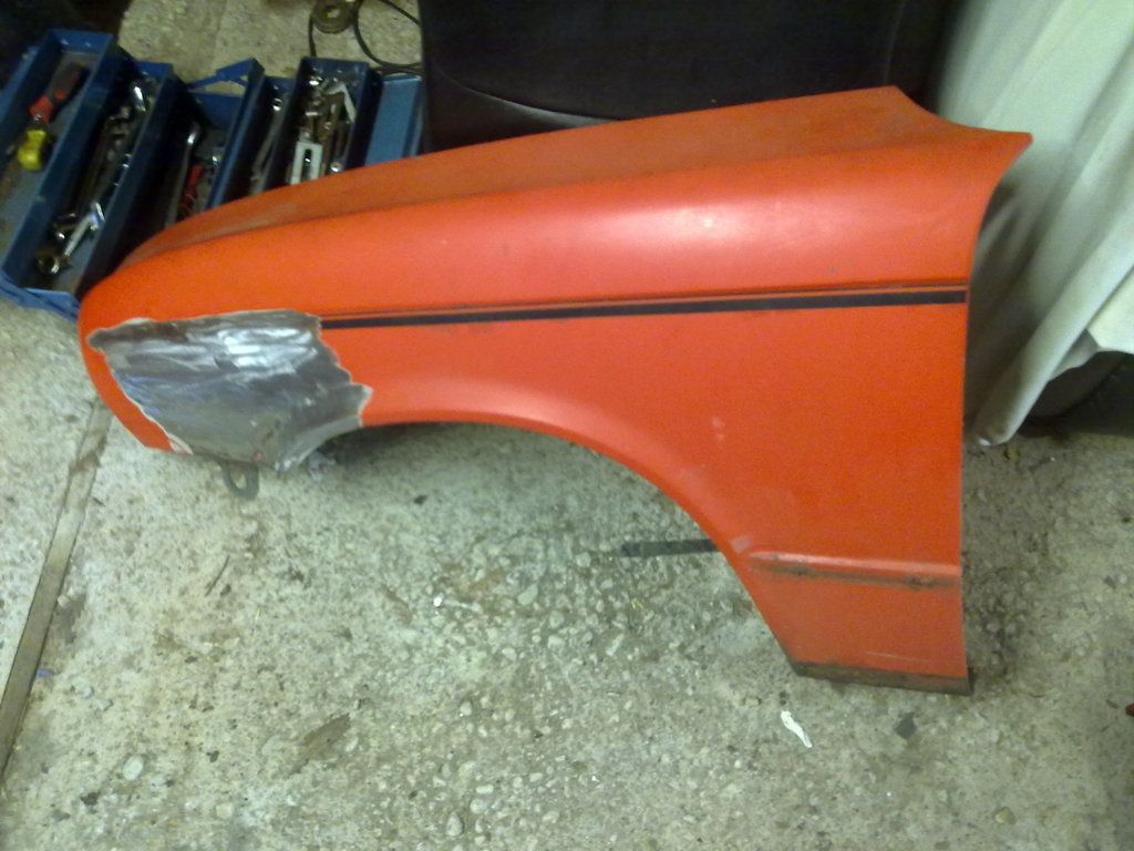

Bank holiday Monday rain has given me an excuse for a bit more progress and I happily spent the day removing the front wings.

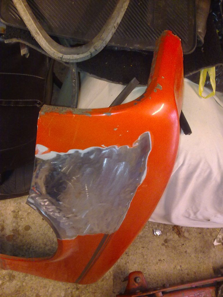

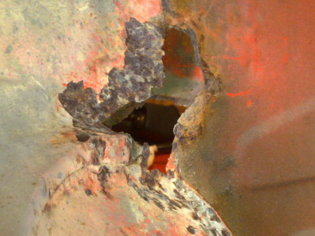

The N/S wing proved a disappointment, I had intended to re-use it (it's clearly not an original panel and was only roughly tacked on) but when it was nearly off I noticed a crack in the paint which, when investigated, revealed a load of filler and a very nasty dent which had been roughly bashed out, stretching the metal badly. So I'm going back to plan A and using the old wings off the Carledo which are only rotten at the valance join. Recycling rules!

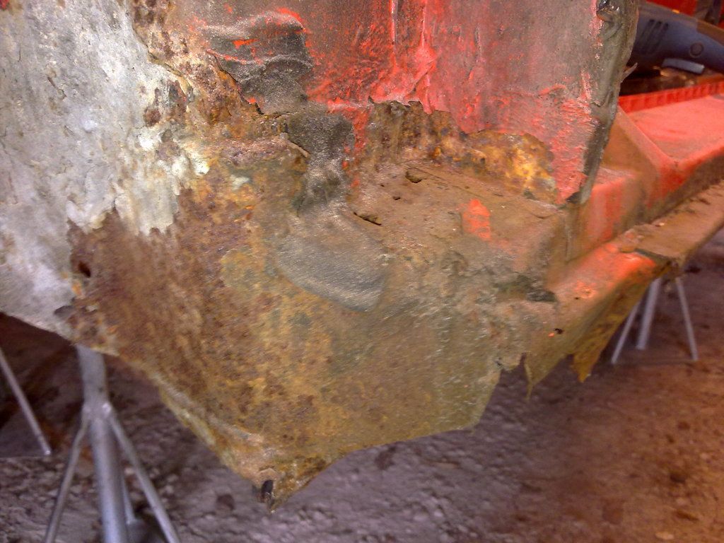

The bodged repair to the bit of the sill behind the front wing was no real surprise and can be dealt with.

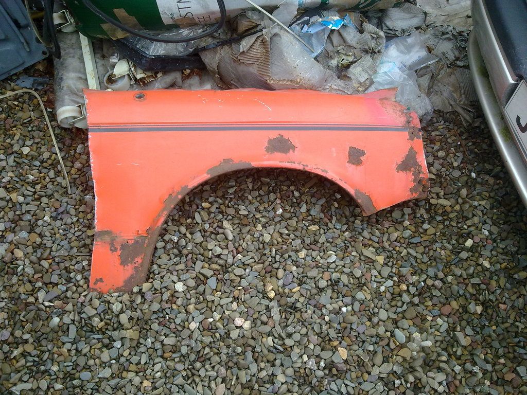

Whats left of the o/s wing, only fit for the bin!
The n/s wing, the damage is not very obvious but is around the front edge of the wheel arch and from there up to the coachline is like a relief map of the moon!

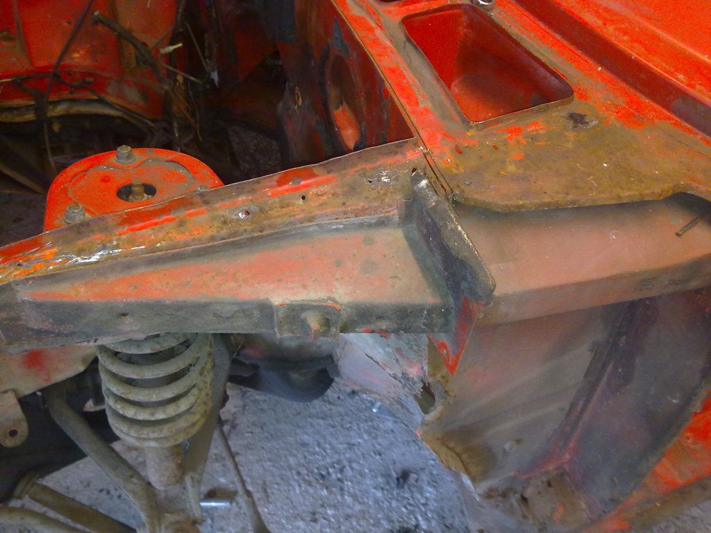

Both upper stiffeners are in good nick and don't need work!
But this does!

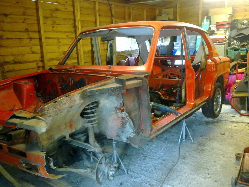

And this! The ful horror of the tricky triple seam rot in the bulkhead/flitch/arch.
Overview.
Couldn't resist a quick try fit of the Toledo wing!

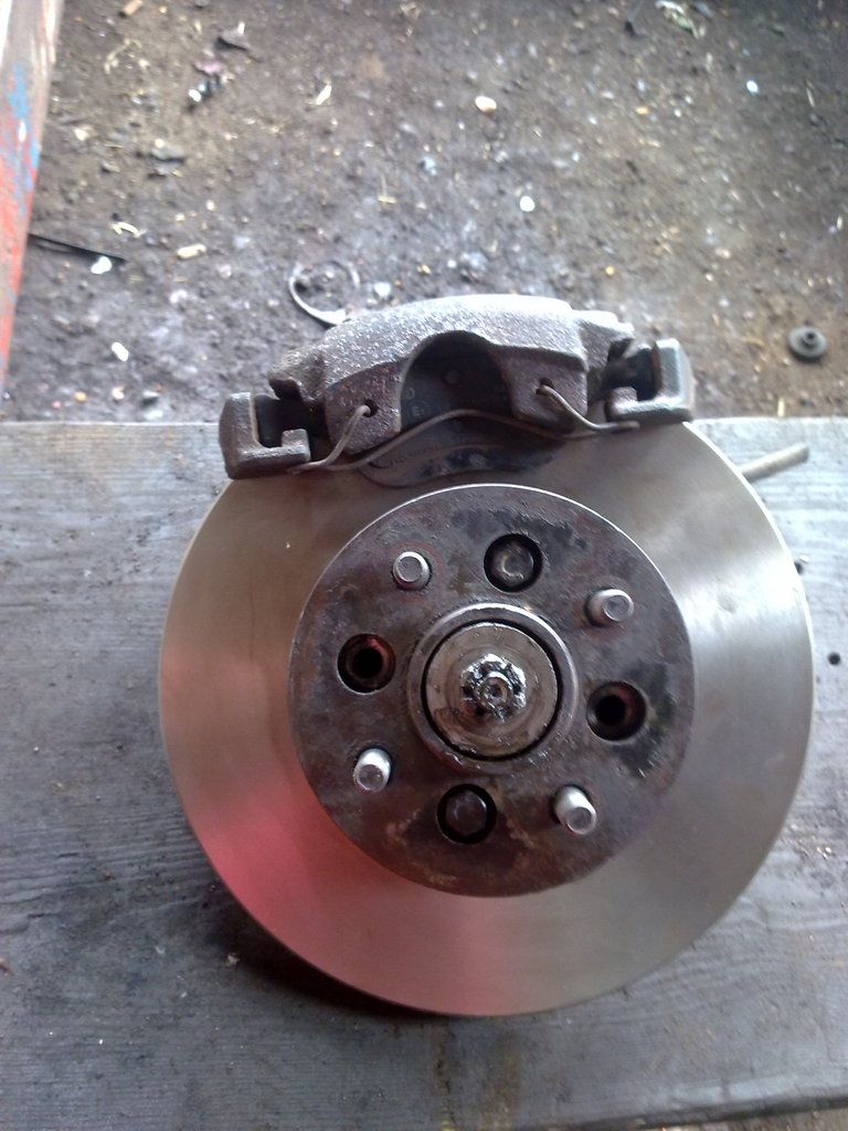

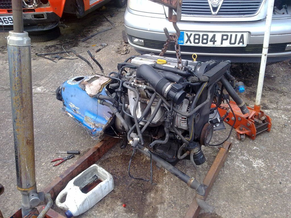

In the meantime, I have got my uprated TJ brake kit with its 256mm discs and Puma calipers and carriers all together and successfully try fitted

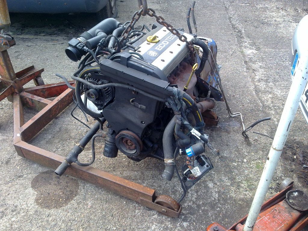

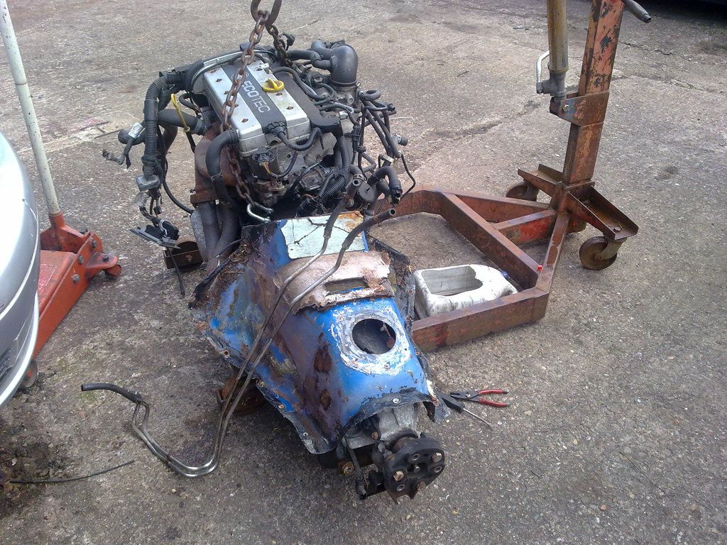

and a dry and unbusy morning last week let me get this massive lump out of the donor car - finally!
measurements suggest that the auto trans is 20cms LONGER than the manual version in the Carledo, which takes the prop joint back under the tunnel reinforcement, however the diameter is small enough not to need to chop the strengthener out - thank you God!
The tunnel housing in the pic is from a 1500 manual, so I think the auto tunnel will do nicely.
At least I don't have to worry about where the gear lever comes out!
