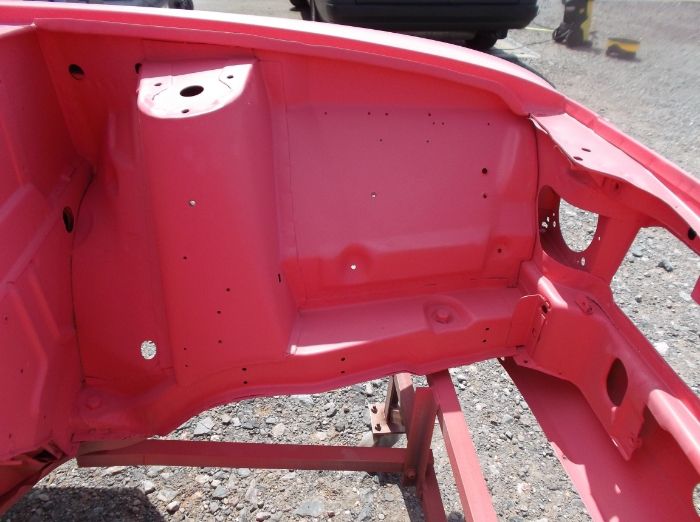

Location: Andover Hants

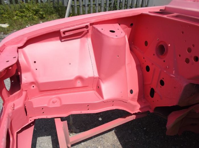

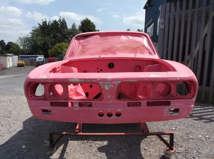

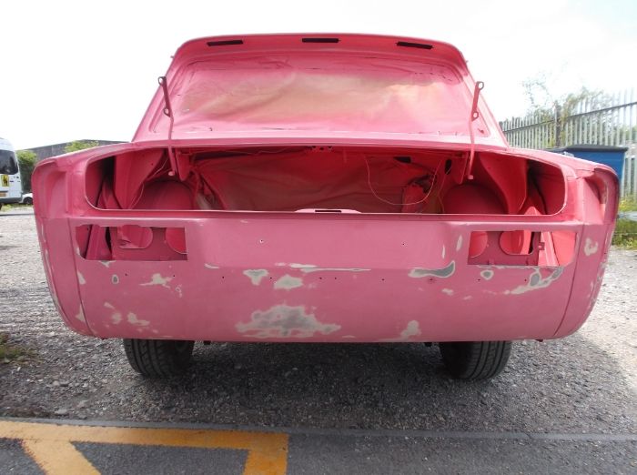

Few pics of current progress, the shell is in pink primer, top coats going on next week.

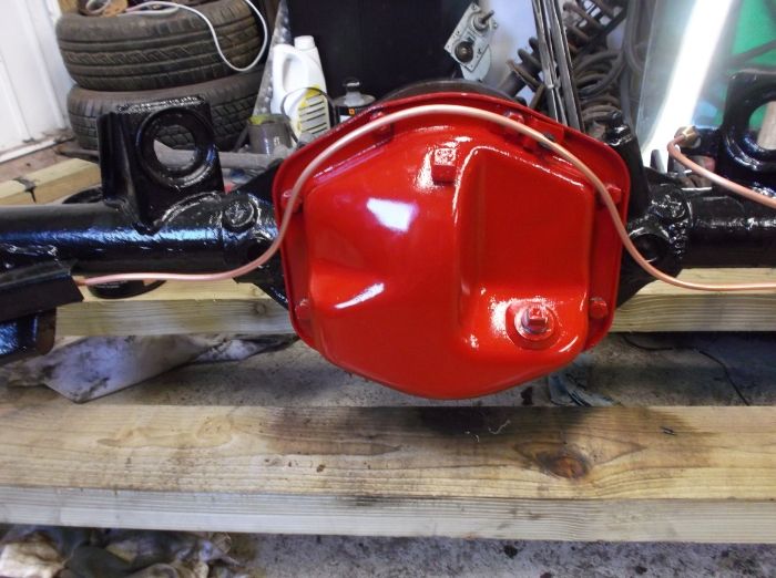

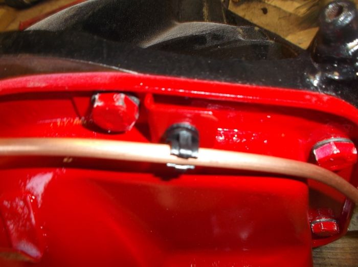

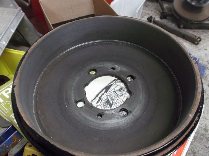

Finally finished the back axle, rebuilt the existing Girling wheel cylinders with new seals.
Had the brake drums skimmed by a guy at work (in his lunchtime of course :roll: )
New copper brake pipes, I made a bracket for the top of the diff cover, saw something similar on another resto thread, there is a folded bracket on the back of the diff case but I could see how to fix the brake pipe to it & I didn't want it vibrating & rubbing which could wear through the pipe.
Getting exciting now, I am going to the paint shop tomorrow, hopefully the shell will have been painted, so should have it back next week to start the rebuild.

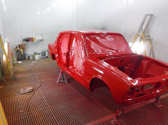

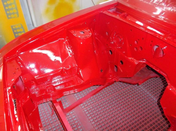

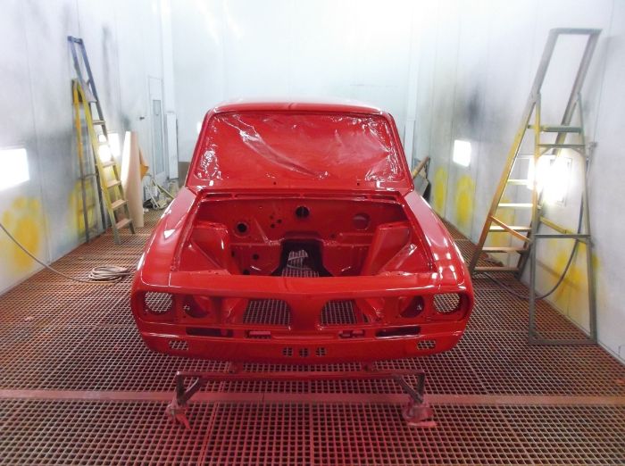

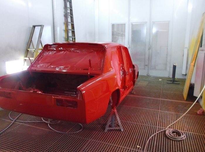

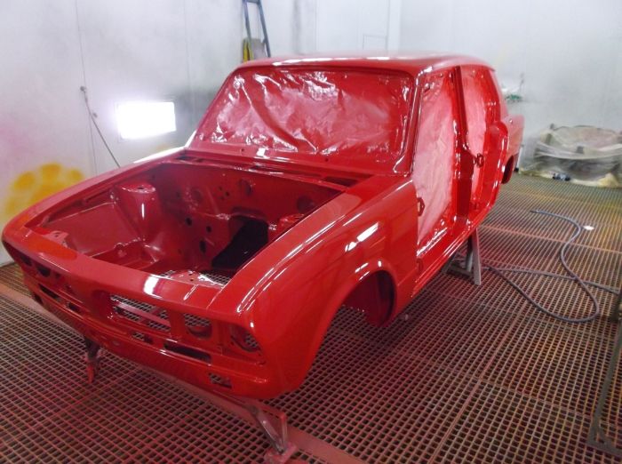

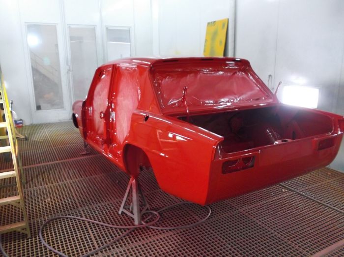

Mini Chilli Red, looks absolutely AWESOME!!!!!!!!!!!!!!!!!!!!!!!!!!!!!!!!!!!!!!!!!!

 Post subject: Re: MSO 662P
PostPosted: Sun Jul 14, 2013 7:39 pm
Looks very good, quick turn around time too! Keep the pictures coming

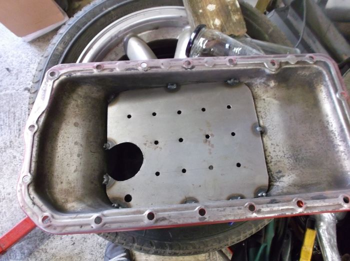

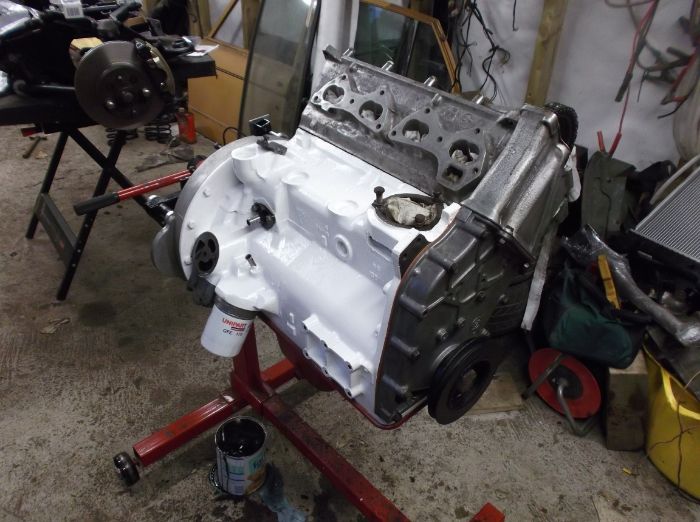

Cleaned & painted the sump today, the sump has had a baffle added at sometime in the past.
Front cover, sump & a few other bits back on the engine.
