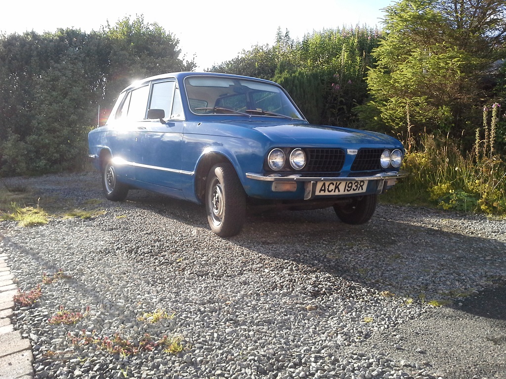

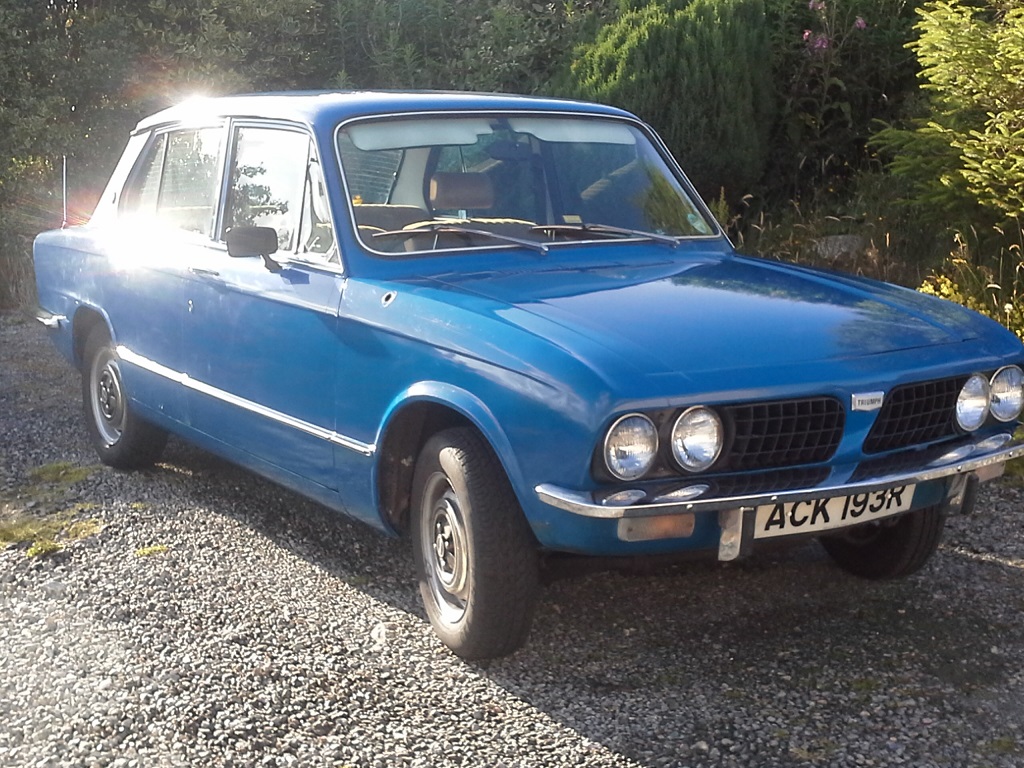

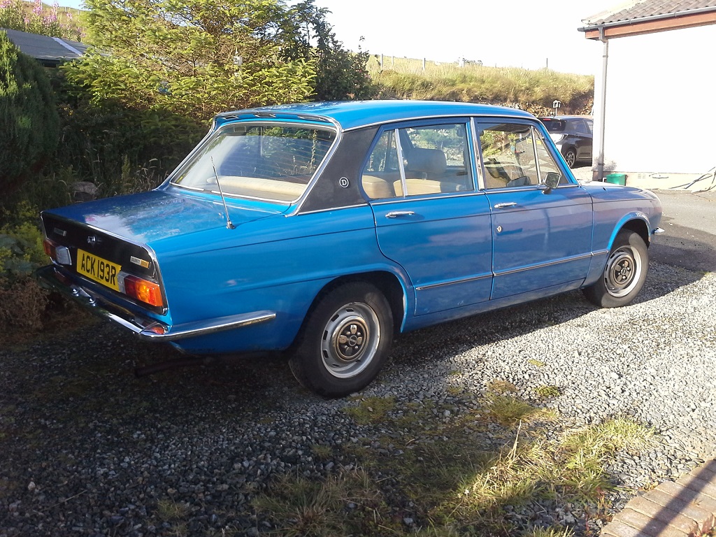

ACK shining in the sunshine ouside its new home on the Isle of Lewis, Western Isles, Scotland!
Many thanks to Bill for all the info & for driving it up to Inverness, it was a pleasure to meet you.
The journey to Ullapool to catch the ferry was uneventful, apart from the blinkin rain!
ACK didnt miss a beat and has drawn many favourable comments since, both at the ferry terminal and on the island :D
