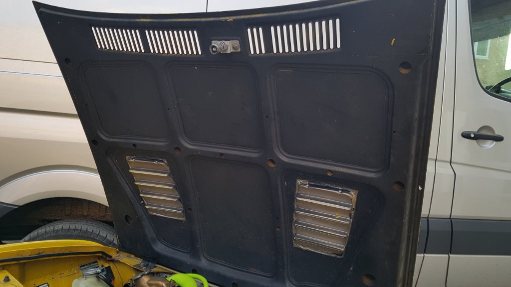

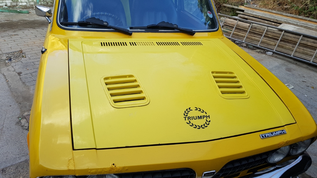

Put the louvred bonnet on today.
From cold startup nothing, but as soon as the temp gets to quarter the passenger side louvre emits warm air from the exhaust manifold.
Once up to norm half temp the fan cuts in and the driver side louvre emits heat.
So they are working, however front float chamber still being heated by fan, also all else in the same line.

Those louvres are back to front! They have been fitted to work as intake, not exit!
Which will work when the car is stationary, but not when it's moving!
Plus, they need a bit more material removing from the vertical faces of the vents to increase flow!
Looking at the underside of the bonnet, there is room for another pair in the rear sections too!

Thanks Steve,
Been looking at the louvres since fitting the bonnet, and kept getting a feeling somethings not right, but carried on telling
myself I'm too picky.
Turning them around is no problem, as the paint has already come off the edges and they are silconed in.
Done one this morning, no probs.
Have to do something about the colour.
_________________
Top

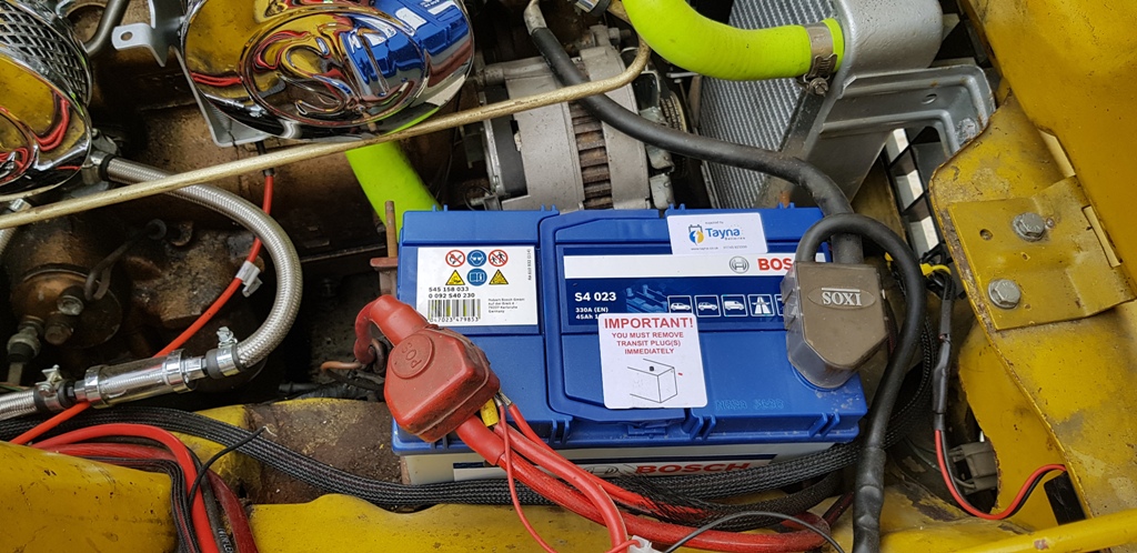

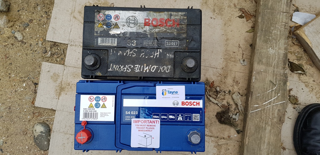

Not done much since I came back from holiday/suffering break.
The dolly batt had gone flat, rather than stick it on charge again, (it would charge, does everytime)
went for a new one, slightly wider, but a couple of mm narrower, with a bit more cold crank amperage,
and a range up.
One day I will replace the positive lead and tidy up the cabling.
