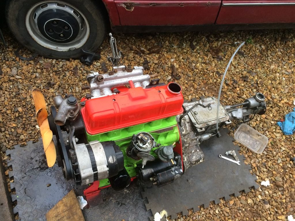

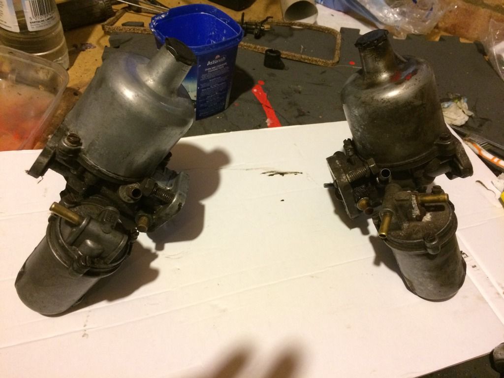

thats the before and after carbon cleaning
thats the engine painted up
I cleaned the carburetors not that it matters (the one on the right is before cleaning)
Putting the engine in

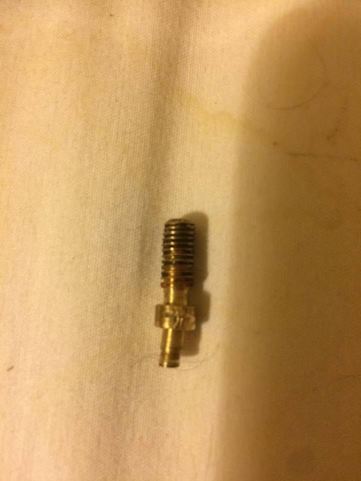

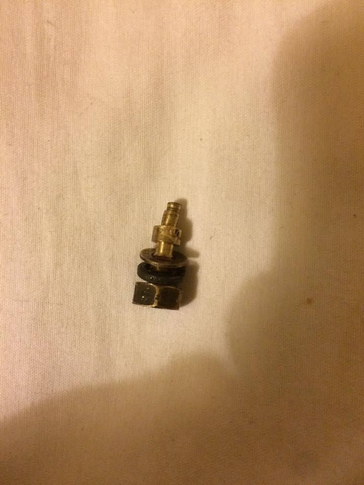

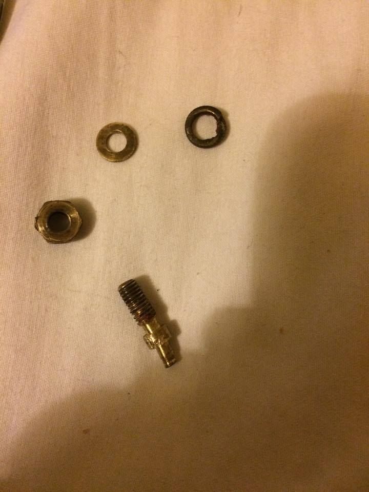

and finally the mysterious part
it had these nuts and washers on
when it was in the engine bay it was the top most connector with just one wire connected. Any help is much apreciated as it is very frustrating not being able to find any info on it

How broken is your solenoid? VERY! This damage is irretrievable you will need a new one. While you won't find one listed separately, a good auto electrical place should be able to find something to do the job. I think you have probably made a mistake wiring the starter, the big red battery lead should have gone on that upper outer stud.

Cheers Steve,
Im pretty sure I did wire it up correctly, I think i forgot to remove one of the wires when i removed the old engine and that subsequently pulled and broke the terminal. Various places online sell starter solenoids for lucas starter motors (http://www.ebay.co.uk/itm/NEW-LUCAS-TYP ... QVmU-HgYtw) but I cant find what type starter i have so I can see whether it matches up.

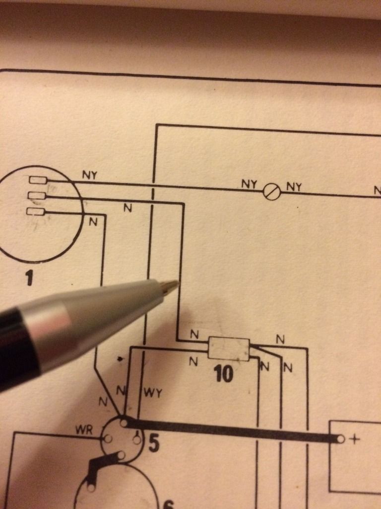

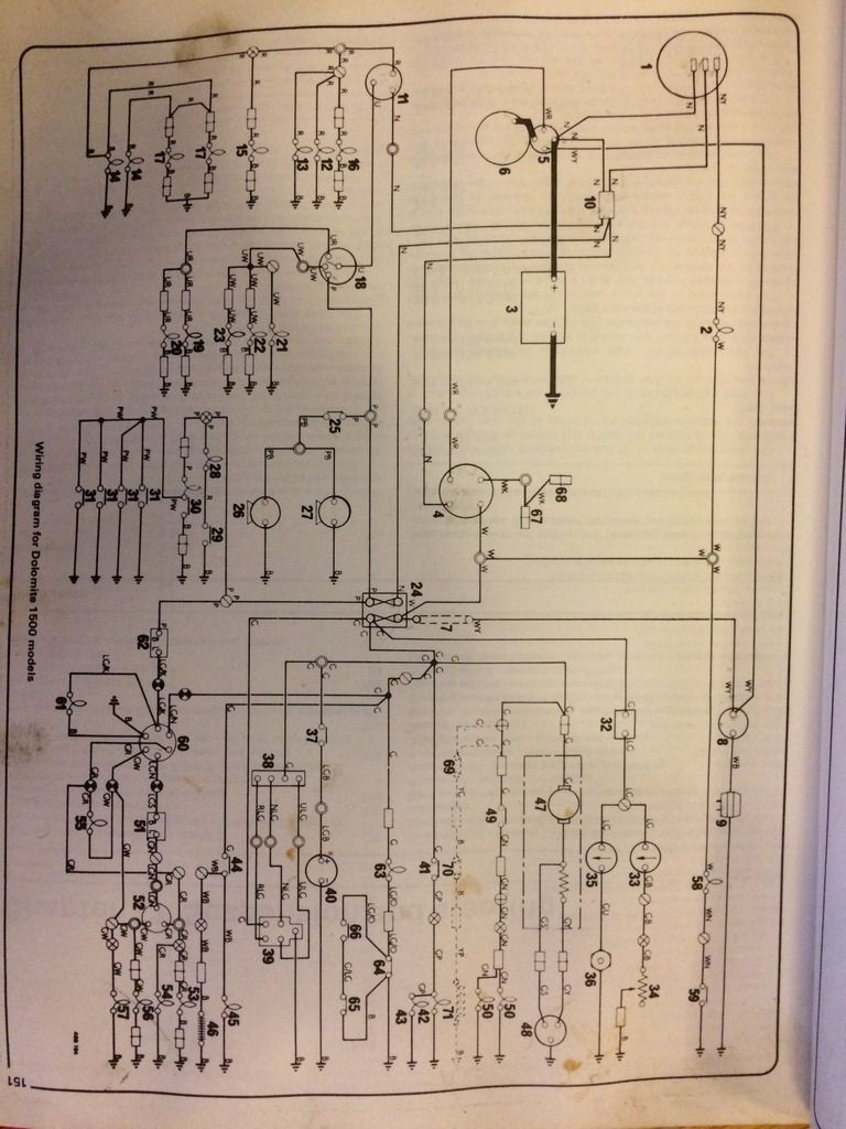

This is the wiring diagram I'm using, I managed to buy a new old stock solenoid

Noticed that this wire from the solenoid to the conveyor block was missing
Everything now works apart from the indicators don't work, only the front indicators come on when the hazard lights are turned on (and they flash quicker from the lower load), the oil light is always on when the key is tured (in both positions) and the ignition doesn't work

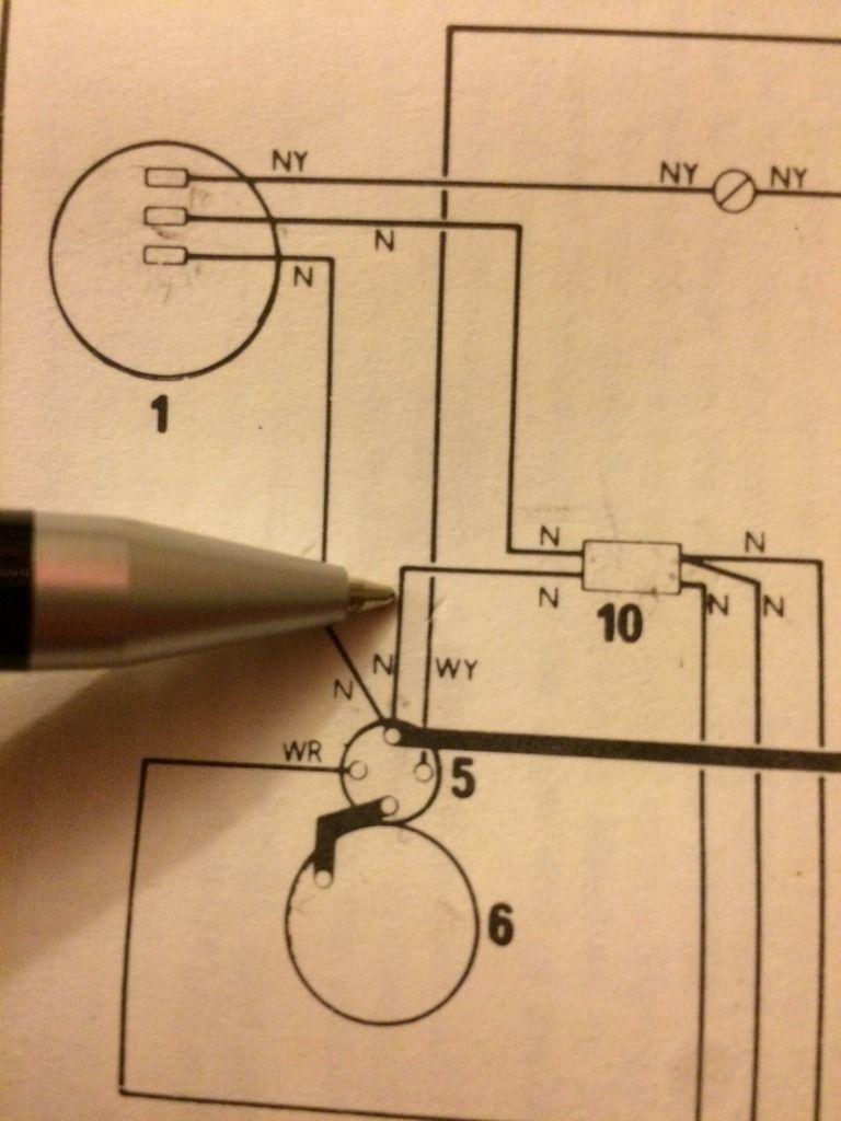

I forgot to mention this wire:
Instead of going to the connector block it goes back to the solenoid (the same stud as the other wire to the alternator) it's got a ring connector so it seems like it was made that way to start with? Could my wiring diagram be incorrect/a later model?
It's really not important which of the 2 it goes to. It has the same effect whatever.
I take it you have found or made a jumper wire from the solenoid to the conveyor block? Not much will work without it!
Check all the connections at the hazard light switch as a first step in your indicator problem, though there are 2 flasher units, they sort of interact if there is a faulty or bad connection or a sticky hazard switch. And check all the earths carefully for the indicator fault too, probably 80% of indicator problems are down to bad earths of one sort or another!
Oil light, I can't visualize why this should be doing this, but it may be related to "ignition doesn't work" what exactly do you mean by this?
