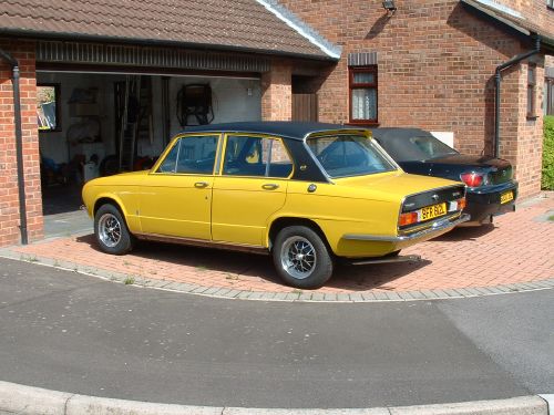

All done except the washer motor. If anyone knows where to get spares for these I'd be greatful. :D
BFRs first trip out of the garage since last October.

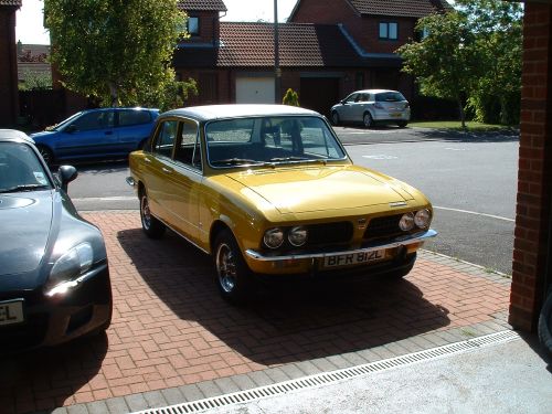

I finally took BFR to my Bro-in-Law's garage in readiness for the MOT test tomorrow (didn't take it yesterday as it was raining).
It's not pulling very well at lower revs but that's because I need to tune it properly. It seems very quiet, comfortable & wallowy (in a blancmange sort of way) compared to my track Sprint. :lol:
Fingers crossed! [-o<
