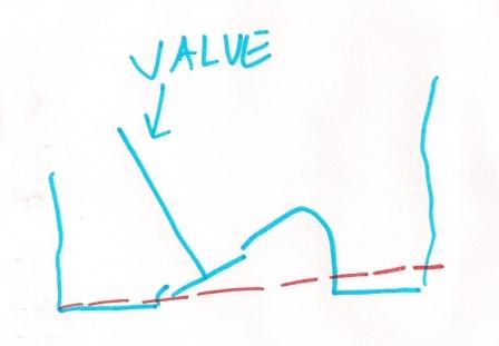

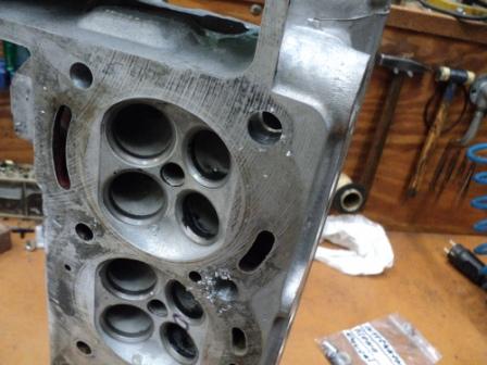

I do not see any problems. My 1850 had also almost a 1:12 compression ratio (at the start) :D . The deck was skimmed and the head. The head gave a few problems because you cannot skim a 1850 head a lot. You are going to hit the valve seats. My solution was to skim it under an angle. (see picture). This way i could have the desired compression. The only thing was that i needed to drill the angled holes in the head 1,5mm bigger because it didn't match the engineblock anymore. :|

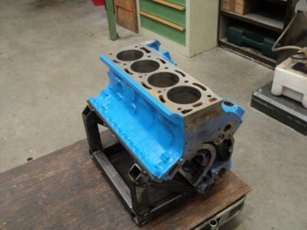

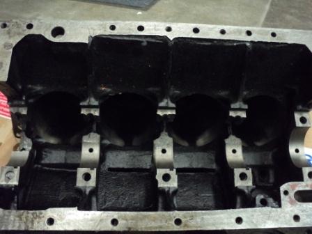

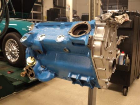

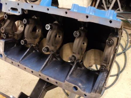

Saturday was a long but a productive day. I did have some new holes in my engine block and head and Hans has brakes again on his Benz Van.

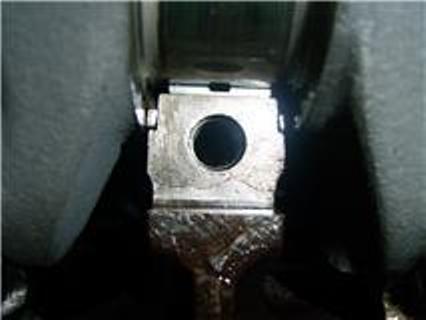

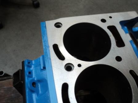

The first pictures do relate to the rounding of the sharp boring edges. The first picture is of a cracked engine and the second of a little burst where all the drama starts with.

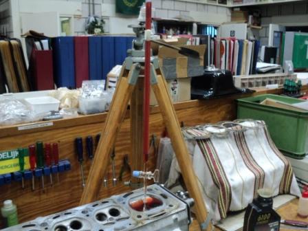

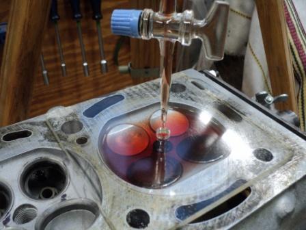

The block and head have 5 widened holes that have dowels in them for exact location of the head. The head cannot move anymore and the headgasket also not. When having the valves adjusted all stay's in the same place. The second set of the pictures is measuring the head chambers what the size is and the difference between. They have to be relatively the same and one was 2cc off so i have to grind something out of the head to match the rest. The rest had all 0,5cc difference max. I decided not to have a 1:12 compression but around the 1:11 for a more long lasting life. For LPG is more compression more efficiency but the pressure on the bottom end will be too much. My former engine did last 260.000km abuse and this one has to go over it ofcourse.

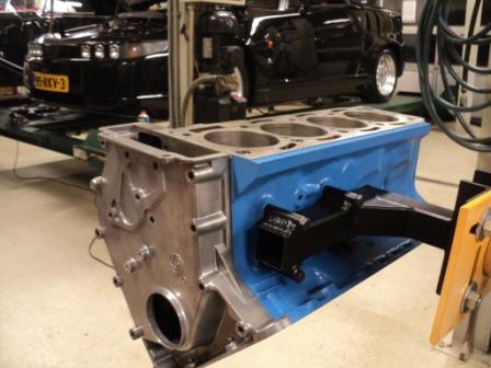

Yesterday i made a decent dolomite engine adapter for my engine stand. Normally it's a bit akward on the stand, not centrated and not easy to turn because of the heavy side at the rear. This way it's nice in balance.
Tonight did some minor fitting. Some new plugs, waterpump bush and the arp main cap studs. Also made the fuel rail and the throttle valve on the plenum and made the injector keep plates.
There's not much to fit right now because the flywheel is being machined and the cranckshaft has to be balanced first with this flywheel and freudenberg damper. I have to make a little alu bush for the oilpump this week to have it centrated in the engineblock. The county can move quite a lot and off centre gives wear to the pump, driveshaft and gear. It would also my hole matching do no good.

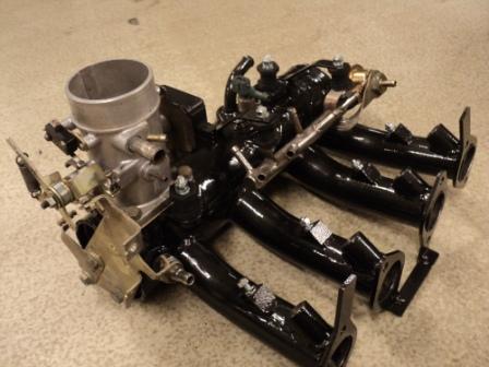

Plenum with original TR7 EFI hardware.

Ha Jeroen,
Nice standard of work! Out of interest: how much cc volume are the combustion chamber volumes now? Broadspeed had 45cc with a 10,35 cr (+/- 0,35) but I’m sure you and Hans have better ideas about that :wink:
About the new extended inlet manifold and TR7 EFi plenum: I guess these will give a massive improvement in torque (longer inlet tract = higher torque) but maybe limits the maximum power a little, as does the relatively small TR7 throttle body. Did you choose the length by calculations or a theory?
And when are you planning to do the test runs on the Dyno? If needed I’m available to help :D

#24 Post by soe8m »
Ha Ronald,
It's not all high tech but also some farmers wisdom and the best of the worst constructions possible because of lack of space or parts and more importand: time...
I could have made me a whole new plenum with a bigger throttle valve but the easiest was to reuse some parts. The length of the pipes are actually determined by the place of the plenum, see the first few pictures in this topic. It's on the same spot as it was on my former engine. This way i do not have to make a new airmass metering unit bracket. I also fabricated a special curved black silicone intake hose between the throttle valve housing and airmass metering unit what i all can reuse now like the wiring loom.
The volume was at cil 1 44cc and the rest slightly more than 45cc. I'm having all the same and then determine how much the head is going to be skimmed. Then check again and finetune. This engine was already build about 10 years ago and has run about 10.000km but it's also build with 10 years less experience from now. I've learned a lot of my former engine also what can be achievable with LPG. You must have read the LPG article in the triumph magazine how it all started.

About 1:11 max with skimming. The rest you have to obtain by block decking. The project has a little pauze in it. Just fitted a new design auto drive plate on my wife's 2500 what will stay in one piece. When this car is ready the roof is going off my house and when the new one is on i'll go further the project.

My new project has a little progress. I did try fit the cranckshaft with the freudenberg damper and it does fit but have to modify the alternator bracket. I use a tr7 EFI one that puts the alternator further away from the enginebecause of the injection parts. The flywheel is leightened again and there's no possibility to have more of it. Will weight and put pictures soon. It's now being balanced all together.

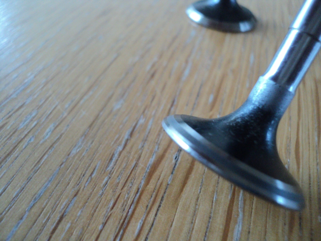

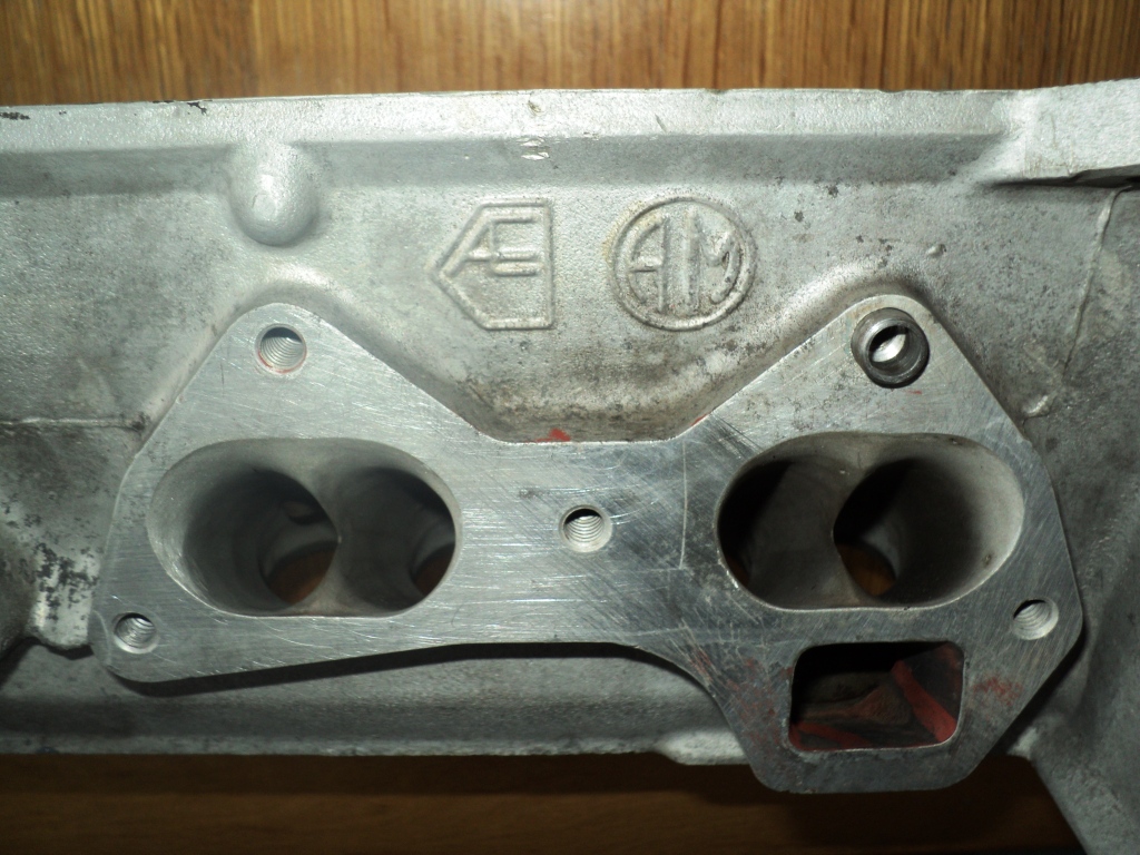

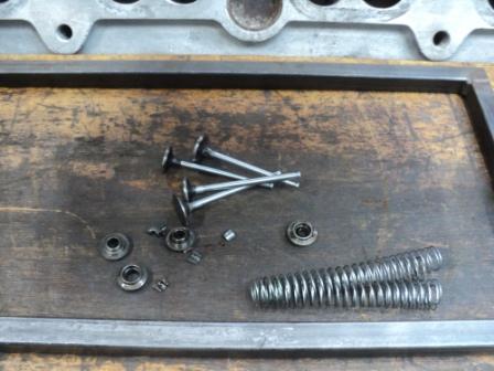

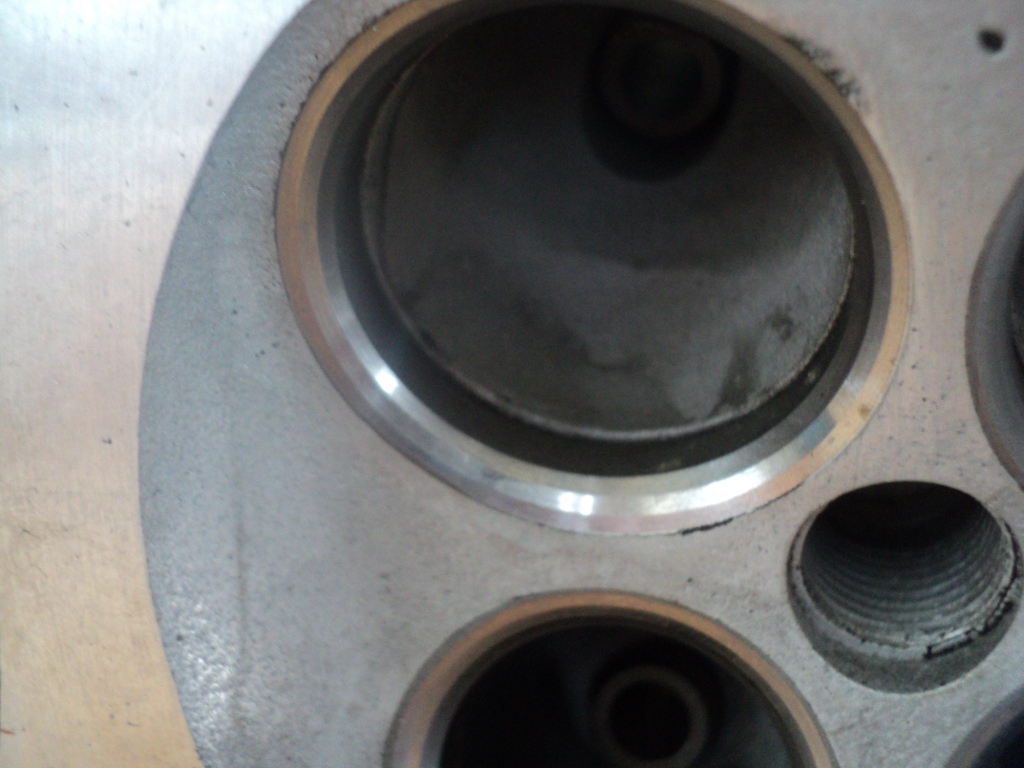

The head/valves are ready. In the pictures you can see the dowels for the inletmanifold. It's matched with the head. The red paint is for matching. Fit and spray. Take off and see what to grind out. The valve seats have a three angular pattern. This for better flow. The valves have also a three angular pattern for max flow. I did lap 1 valve to check the contact area if it was 2mm and it was.
The next thing to do is to make the extra oilfeed in the head and then it can be put together after measuring the combustionchambers again. The head was skimmed so there can be a little difference in cc's.

soe8m wrote:Saturday was a long but a productive day. I did have some new holes in my engine block and head and Hans has brakes again on his Benz Van.
This damage is exactly what happened to my engine after 10 years of track days, the really annoying thing is that if you look at the design of these Dolly lumps and compare them with a Pinto you note that the web that connects to the main bearing is solid on the Pinto and Triumphd could have easily beefed up their webs (they have holes in them!) and do away with the huge lump of cast iron that makes a flat sump then make the sump go up the side which would have created a more reliable and lighter engine.
