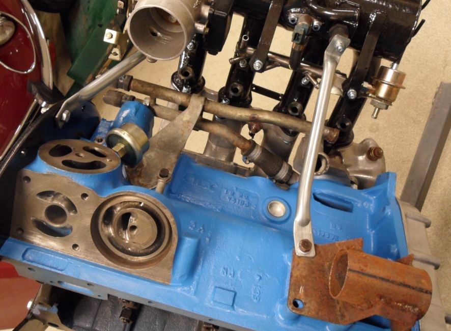

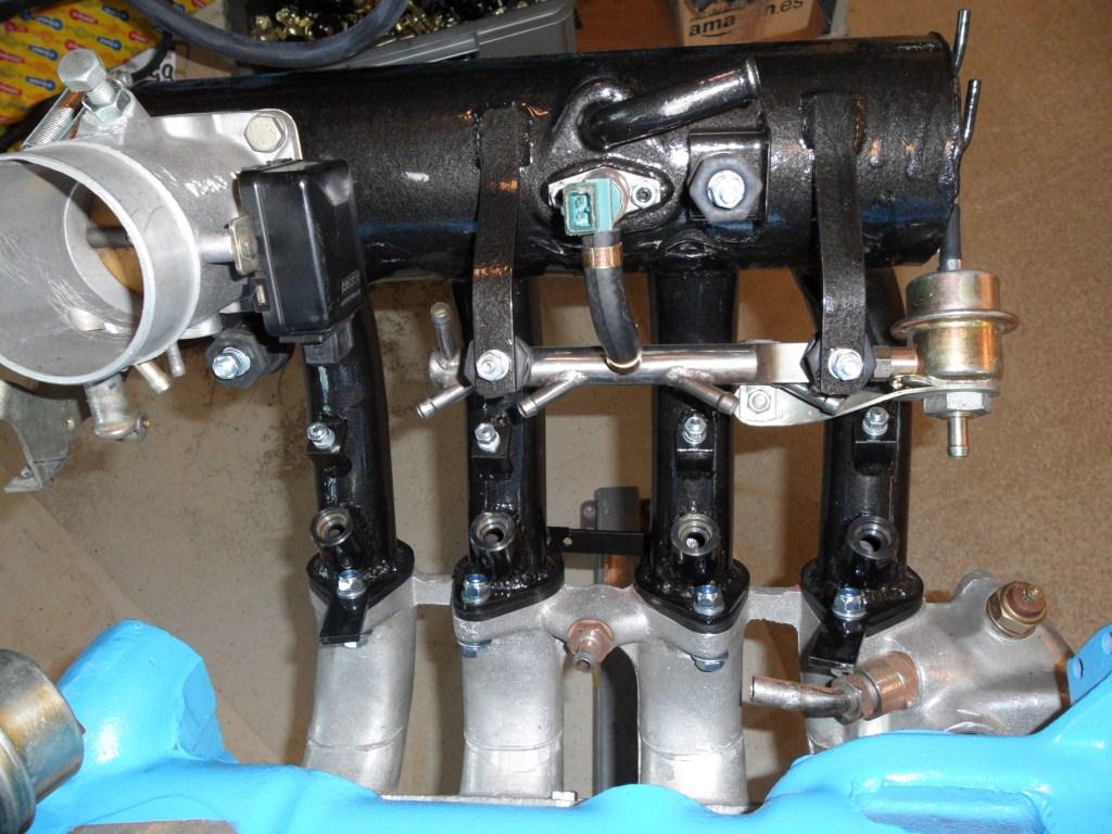

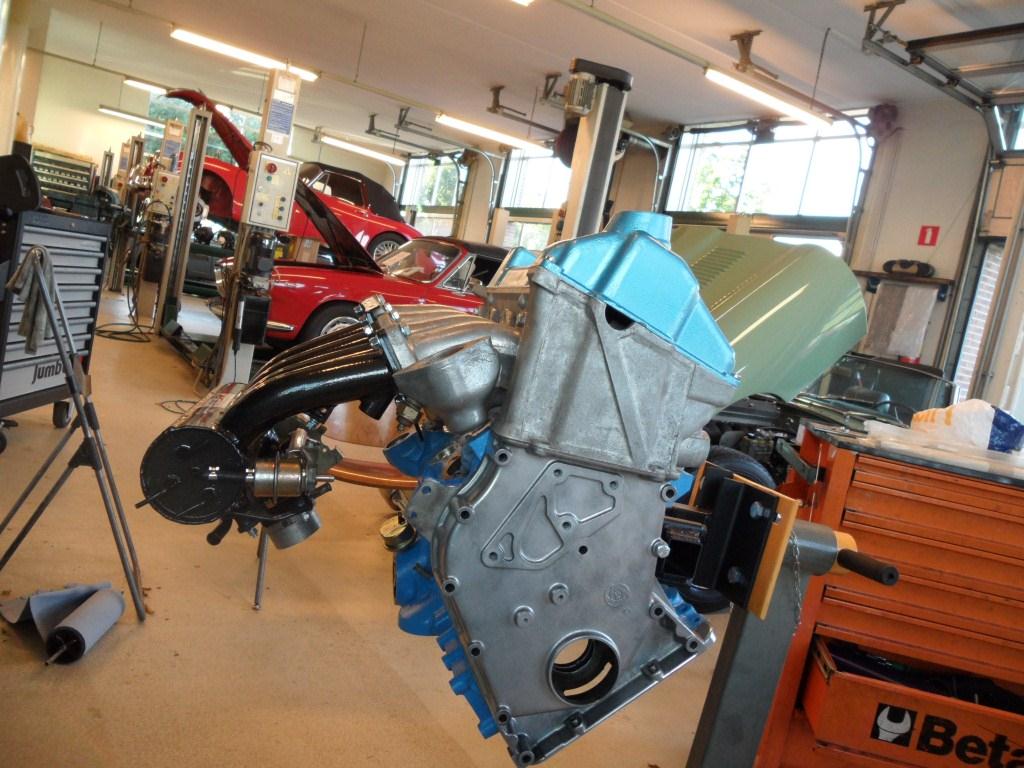

Tonight i made some brackets that hold the plenum. Also checked the heater pipes but these are also going to be different. It was with my old engine a bit messy between the bulkhead and rear of the engine. just enough space for heater hoses and T pieces for the evaporator take off. I make some new ones, a bit shorter and the take off already welded on so no tight curved hoses etc.

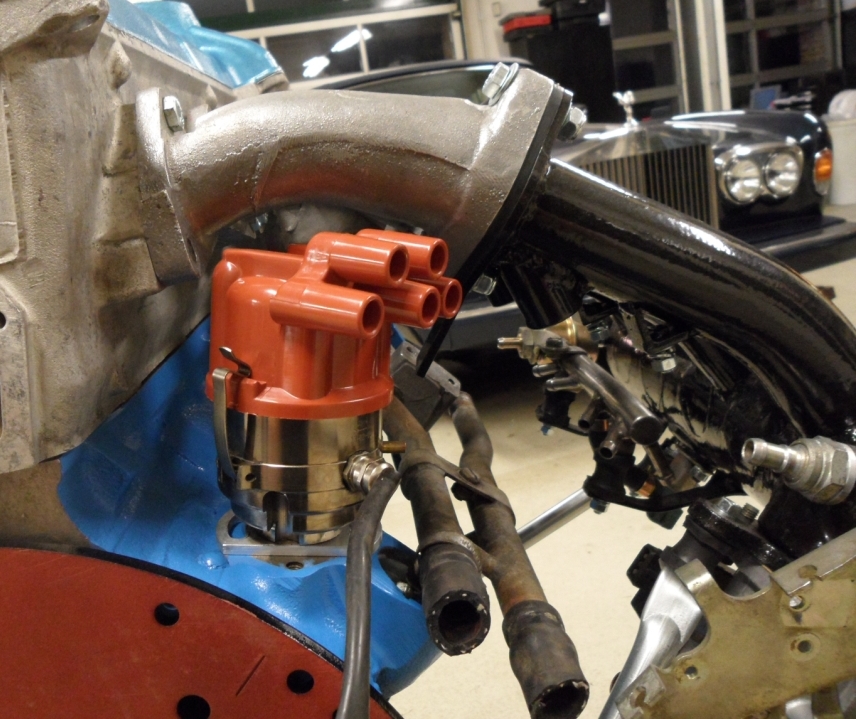

Also tried to fit the 123 ignition with a new angled cap from a Fiat what's a straight fit and does fit under the manifold.

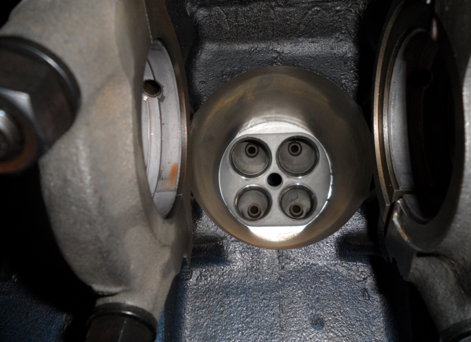

I love the pic looking up the bore. Engineering artwork!

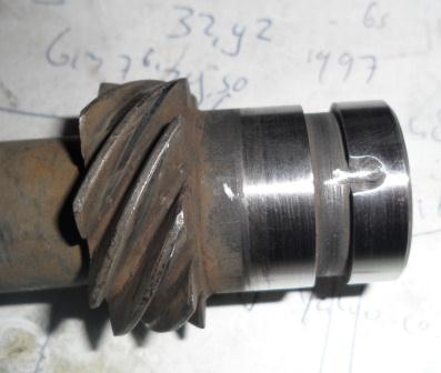

Tonight i did finish my extra camshaft oilfeed. As you know i'm not a fan of the extra oil feed type of the ohv engines because they take a lot of amount of oil from the mains and rods only to spill it under the rocker cover. A 1850/sprint has three flat spots at the front journal of the jackshaft that creates a pulsating oilflow to the head. Three times per rotation of the jackshaft. (an ohv has one flat spot at the rear of the camshaft to have a pulsating oil flow to the head)

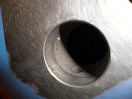

The sprint suffers from oilstarvation of the rear camshaft bearing. I wanted the same pulsating at the rear at the exact timing as the front. I did drill an extra take off in the rear jackshaft bearing. To know how the front is timed it was very simple. I had some airpressure in the oilfeed hole at the engine deck. It was very audible when the hiss started and ended. I made some marks when it started and ended. The same thing i did at the rear when the flow had to flow.
Then i machined some slots in the rear journal. I did check again with airpressure in the new rear take off and finetuned it. the front flat spots are not all the same so every puls is not the same. The timing is now max 2 degrees off at one puls and the two others are the same. I can have that one exact then i have to machine the front flat spot but 2 degrees is fine for me.
