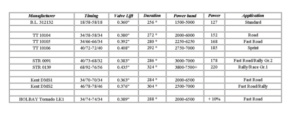

My first question is about camshaft
I have a STR 91 (i think the duration is 290°)
I want to upgrade with a str 139 model and weber 48. Newcam propose me 2 models 1 is a 290° (the same of mine) and a 340°?
I think that the str 139 is a 316° or 324° is it true?
And if it is true, what is the 340° model
Thank you

My reply from the other forum...
Hi Christophe
The STR139 is 324 deg duration.
Changing to this cam isn't as straight forward as changing to the STR91 cam, there are quite a few other mods. required to the head (and probably the bottom end) as I'm sure you are aware.

Also, I've updated the cams list a little:
Good luck with your Dolomite!
