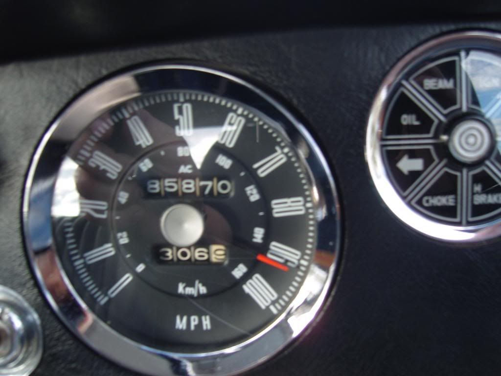

A standard well set up 1300 with a good ignition side and properly set up carburation will easily pull 70+mph. The low gearing however, makes it rather busy at those sort of speeds. Without an oil cooler (and thermostat) you would probably settle for a 60-65mph cruise. This keeps you usefully ahead of the lorries, and still gives 40+ miles per gallon fuel economy.
You can get higher gearing (and more relaxed cruising) by fitting overdrive, but you will have to fit a 1500 flywheel and ring gear, and a 1500 clutch. By the time you have bought a decent secondhand overdrive box and done all of this it will have cost you the thick end of £400 and that assumes that you do the work yourself and do not pay labour charges.
The photo below is a bog standard 1300 but properly set up and with an oil cooler and stat. The car was travelling up a very, very slight incline at the time. It shows two things. First, what a standrad 1300 should be capable of, and second the rev counter tells its own story.

by heck! must been on the noisy side at those revs and speed - thanks for the pictures! their excellent! :D
