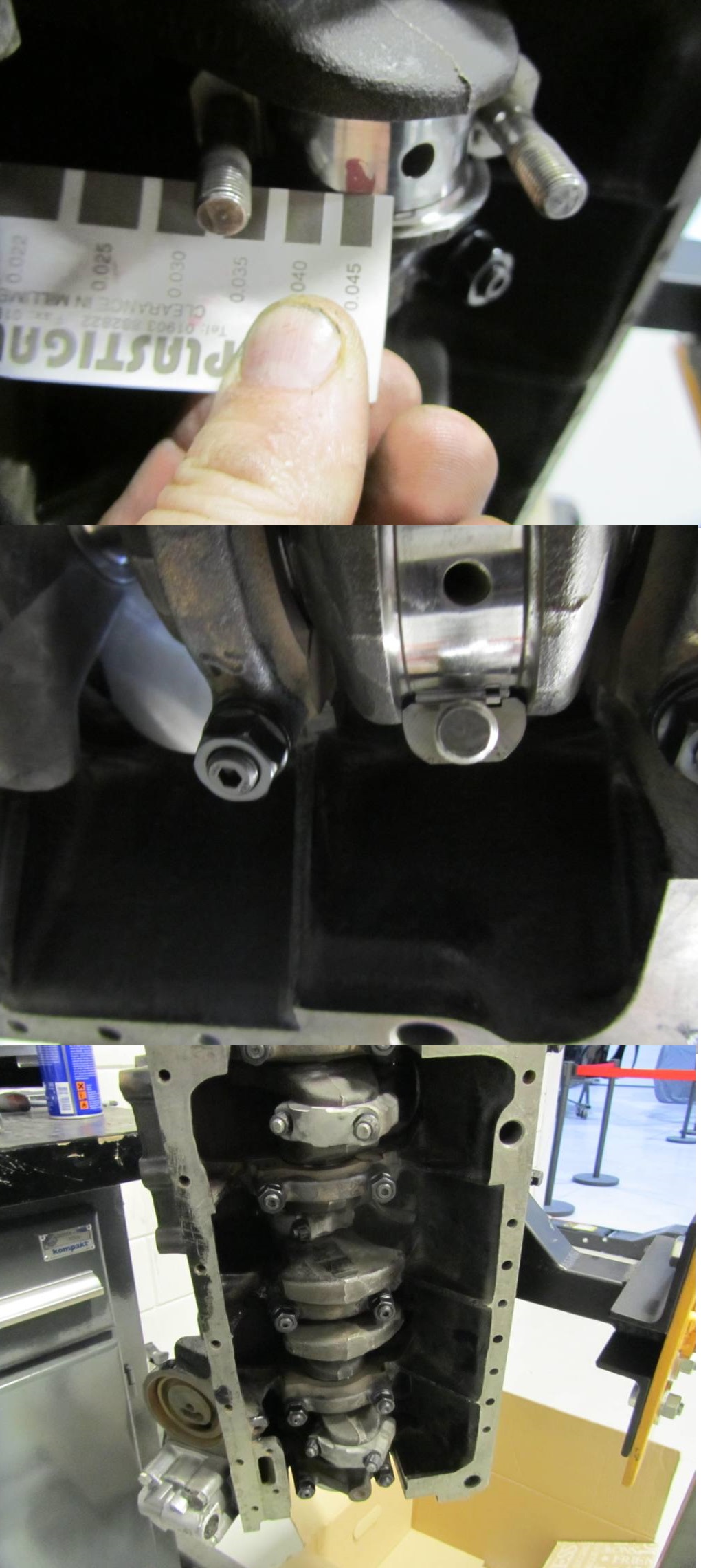

Howard81 wrote:Oh so that's how plastigauge works!
The Plastigauge is a certain diameter (you can get different diameters), so when it is deformed (squashed) it will measure a certain width depending on how much it is squashed.

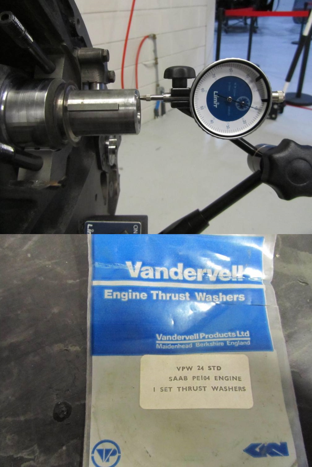

Tonight was fitting the cranckshaft and pistons. The axial play has to be 0,07-0,28mm. With the std size bearings the play is 0,10mm. Sometimes the play is that big that std bearings have too much play and the first oversize too less. You can combine one std and one oversize to have the right axial play or sand some of the back of the oversize bearings to obtain the right play. The best is to start with the minimum. It is maybe some sanding effort but it can save you early replacement in the future.

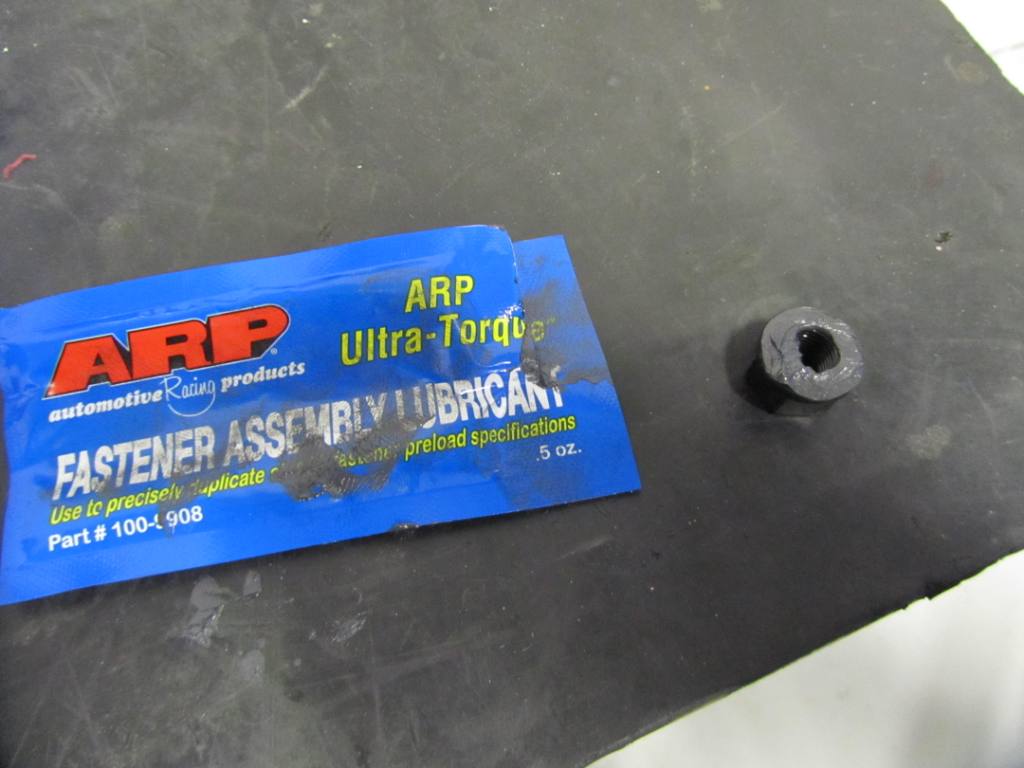

When fitting the ARP nuts you can use the special lube. Don't only lube the thread but also the contact area. The less friction the nut/bolt has, the more accurate the torque is. Your actual tightening torque is the total of the friction and tightening itself. ARP bolt/nuts/studs have a different torque than the original ones. There's also a different torque rate when tightening ARP without the special lube.

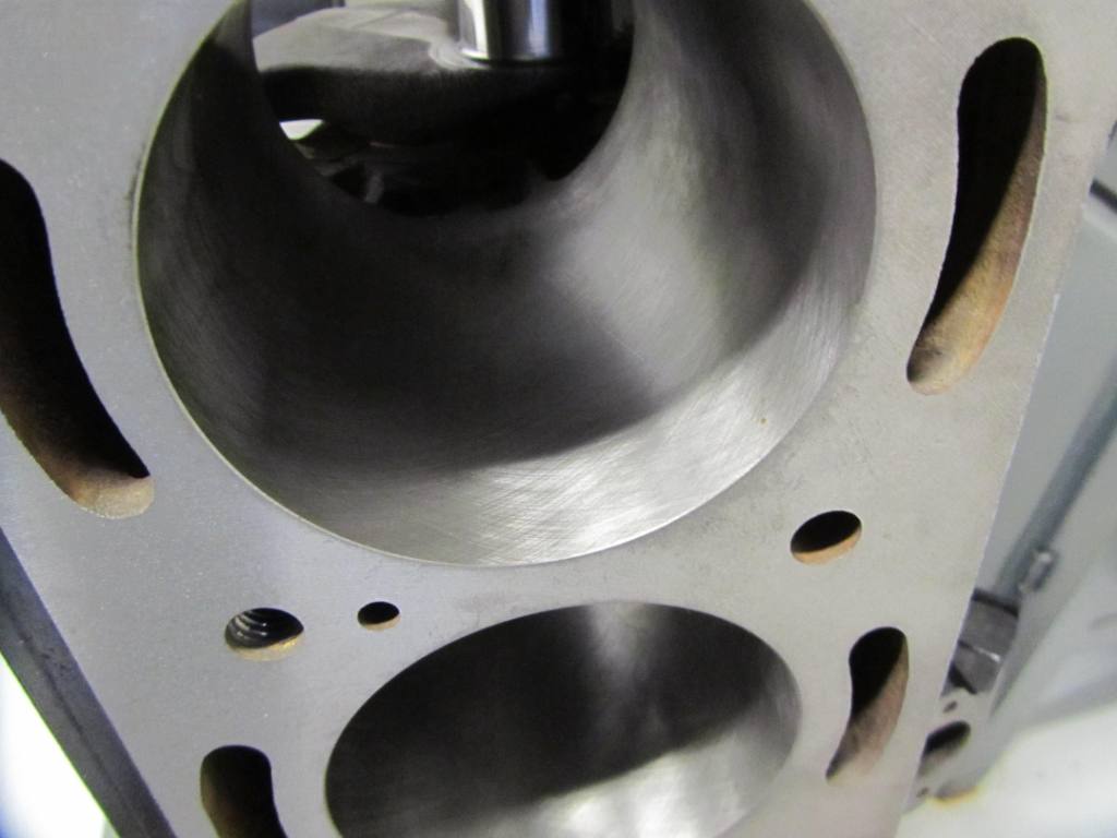

A normal honing cross pattern

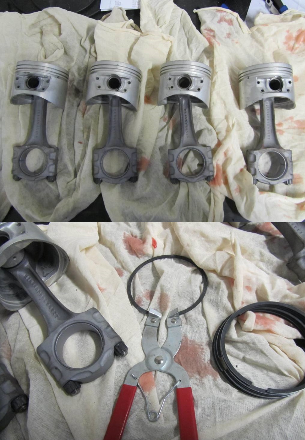

Fitting the rings you can do with a special pliers. It saves some fingertips. This one does cost about 4 euro.
The rod bearing play measuring goes the same way as the main bearings. There is a difference in bearings. When the cranck is on size for example county's can have sometimes too much play. vandervell, glacier and AE are ok to use. Sometimes it's only a different box and have AE vandervell bearings in it.The bearing slot of the rods are on the opposite of the main bearing slots. It can happen that the numbers on the rods are on different sides or on both but this is the way it should be fitted.

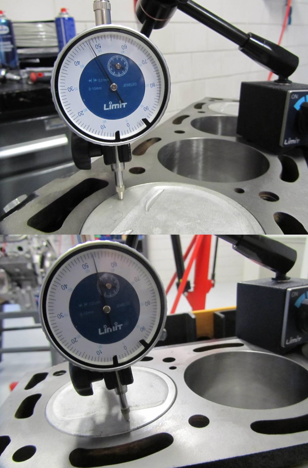

After fitting all i had to check if the deck was skimmed enough and flush with the cranckshaft bore. Most of the time it is not and you can measure a linear deviation between cilinder 1 and 4. My machineshop has a special rig that clamps the engine in the main bearing bore. If that is adjusted level the deck wil also be after skimming. Only a 0,05mm difference and that is ok. The hight above the deck is about 0,5mm.
