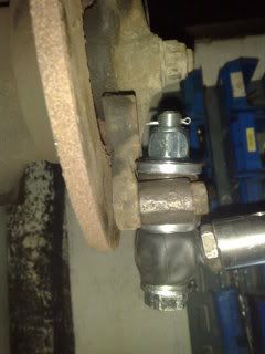

Discs on hard cornering i have replaced the bottom arm and ball joint

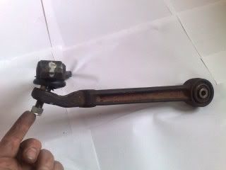

The old set up was at the limits of its travel as i have my car quite
This is how the ball joint sat on my car and touched the disc on very hard cornering

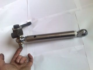

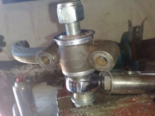

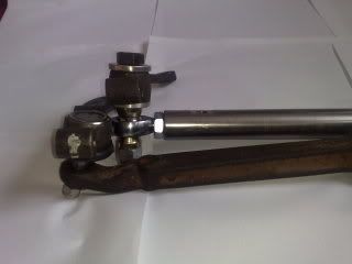

I have used 5/8 rose joints and solid aircraft quality stainlees steel rod as i wanted strength and reliability over weight saving as i use the car more on the road than track and having to do an emergency stop in the pot holed british roads
I still have a bit of work to do with the spacing of the joints but hope to have it on for coombe
So easy to set your camber up as well
