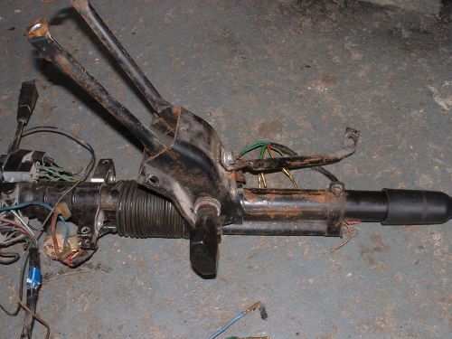

As promised in another thread, I have done extensive research into this. :lol:
Q. Do you need to slacken the column adjusting knob to be able to retract the lower section of the column?
A. No.
As I said, I have done this many times before & here are a few pics to prove it (ok, you'll have to take my word for it :D ).
Steering column extended as far as it will go...
Steering column retracted as far as it will go...
Clamp tightened up & lower section moves freely in & out...
Image Image
The clamp only clamps against the top outer section.

#2 Post by Spunkymonkey »
If you think about it, that would have to be the case. If it didn't clamp the top bit then the wheel would be free to move and, if it did clamp the bottom bit, then the shaft couldn't turn because it'd be clamped to a fixed point on the car :shock:
Nice pics to demonstrate though :P

#3 Post by JPB »
Ah, I see, I've been talking about a column that's still attached to the car, so the bearing/bush type thing at the end of the lower section isn't free to move, so where I've been popping the clamp apart, you've dropped the brackets from behind the dash to achieve the same result. Ta for clearing that up.

#4 Post by Mad Mart »
I only did this demonstration as some where saying that you have to loosen the steering clamp when changing the bulkhead bush.

#5 Post by Mad Mart »
JPB wrote:Ah, I see, I've been talking about a column that's still attached to the car, so the bearing/bush type thing at the end of the lower section isn't free to move, so where I've been popping the clamp apart, you've dropped the brackets from behind the dash to achieve the same result. Ta for clearing that up.
:thumbsup:
No John, it works the same as this without undoing anything. :) This is just a spare column I have lying around & thought it would be easier to demonstrate.

#6 Post by JPB »
I see what you mean, but knowing my luck, if I'd tried to pull the column inwards like that without first clearing the clamp out of the way, the bearings would have moved and I'd only have ended up needing to remove the whole thing to re-site them which, I'd guess, is why the book states that the clamp needs to be split. :wink:

#7 Post by DavePoth »
I've done it too, and as I said the only reason I loosened the clamp was to make a slide hammer.

#8 Post by MIG Wielder »
Thanks for that Mart; I see what you mean. One large serving of humble pie for me.
May I have some curry sauce on it, please nicely ?
