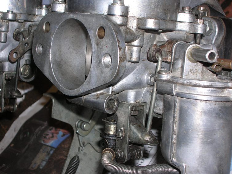

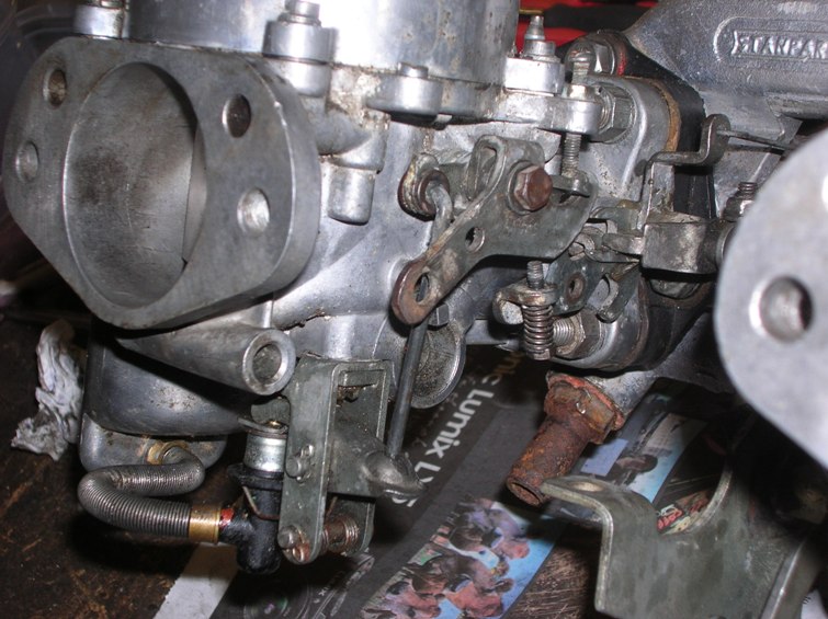

About 8 years ago I acquired a pair of 2" SUs all set up on a manifold for a Sprint. It came off a car that had been used for racing. I am about to put these on the car I am restoring, but while cleaning them up, I noticed that unlike the standard 1 3/4 " SU set up, the choke only appears to be set up for the rear carb. There is no connection to the front carb. These carbs appear to be quite different from the smaller, standard ones.
Left, rear carb showing choke set up
Right, front carb with no choke
I am assuming in its current set up it is going to be difficult / impossible to start from cold? Some advice / suggestions would be much appreciated. Anyone got a 2" SU set up using these carbs?

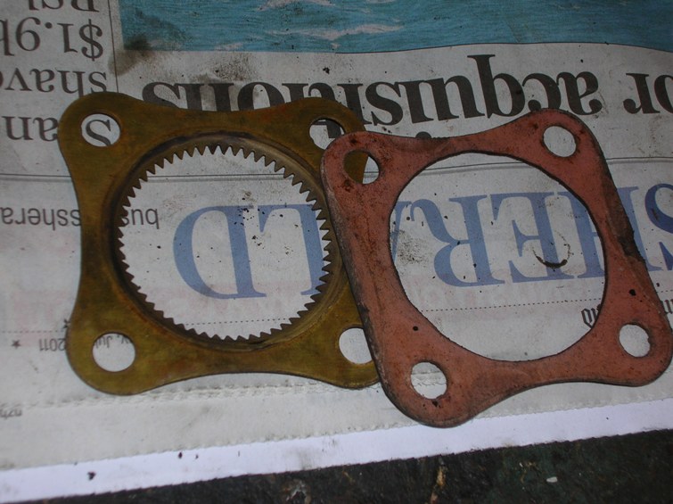

Incidentally there were 3 gaskets between the rubber mount and the carb including this copper one with a serrated inner edge.

Probably a not-so-smart answer: shouldn't we be looking at the other side of the front carb for the choke mechanism?
Because the rear carb choke mechanism has this holes in the 'arm' I suspect that a connection linkage could be / should be placed.

Nothing at all on the left side of the front carb

No, there is no linkage at all. In fact the actuating mechanism to richen the mixture is on the right side of both carbs. I did wonder if i could change it over from right to left on the front carb, but that would require some drilling a tapping threads and I would still be short of some bits.
