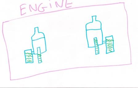

On drawing one you can see how the engine is hanging in our cars with the carbs attached. The floats nicely adjusted by the book :evil: and the front carb's just not flooding and the rear much too low. The rear will give a lean mixture. It can be adjusted at idle with the jet adjuster to have at idle a decent mixture but at driving revs the mixture does look like nothing.
When adjusting NOT BY THE BOOK AND THE ONLY WAY TO ADJUST, the front fuel level in the jet, the level can become too low in the floatchamber and then you have to change the floatchamber. This is noticable by driving at speed there's not enough fuel supply.

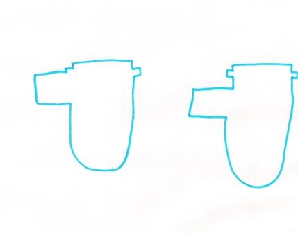

There are different types you can fit and all have the same connection but the offset is different. You can have after changing the fuel level in the jet ok and enough in the floatchamber. Or the other way, the level in the rear jet cannot get high enough without seeping fuel trough the housing and cover. You have to change floatchamber also.
The different types are used on every vehicles with SU. Maybe your spare set has the right floatchambers to use.
