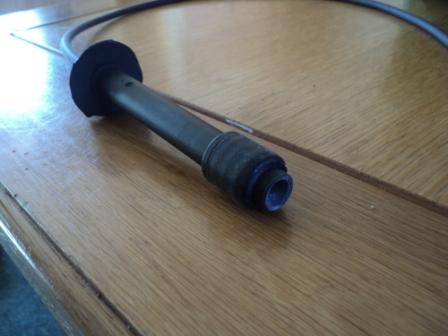

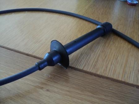

There are some nice sets available from Magnecor. A suppressed type with decent plugcaps.
They also sell a very nice and original set for the sprint. Quality plugcaps and if you replace the original hat's that seals the camcover the looks are original but with a modern cap. I did develop this set with magnecor as for some sprints i would like to have the original look so with a bit of experimenting their side and tryfitting my side it became a nice set. MikeyB did send an original plugcap at that time for me to magnecor so they had an example. I do not have any shares in magnecor but if you ask for a dolomite sprint set original type you will receive it. If you are so very very happy with it and overwhelmed any donations are welcome ofcourse :woohoo:
You can have them made with the plated copper core black non text non resistance leads or with the black resistance lead they use in the normal set.
