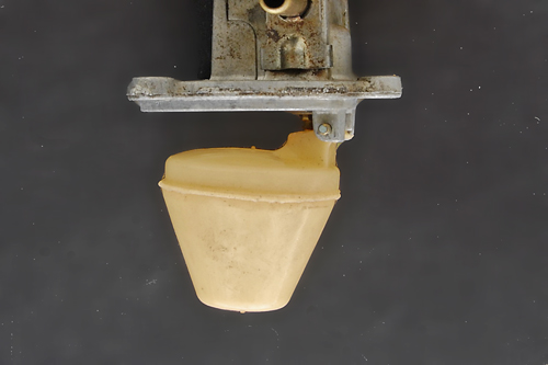

I have checked Jonners Wiki on tuning carburettors and I have read the “Bible” according to Jereon (various comments elsewhere and e-mails to me) and I have reviewed the older thread “How to Build & Power Tune SU Carburetors by Des Hammill” viewtopic.php?f=4&t=8037 but nowhere can I find someone who can tell me what the float level should be set at.
Yes I realise that the float level will need to be adjusted to get the level sitting correctly in the jet but there must be a nominated starting point which is roughly correct. Then I presume you add or remove washers under the float needle assembly to adjust or fine tune the level.
I have purchased a couple of new float needle assemblies but I fear they are quite wrong for in their shut off position the float is nearly touching the cap and is sitting much higher that what is shown in this picture.
20130906-4347Ptw Sprint float valve assembly.jpg (92.74 KiB) Viewed 5054 times
Jonners, Jeroen can either of you two, or is there somebody else out there who can, offer a suggestion.
Thanks, in anticipation
Robert

Hi Robert, I've had a look through the Sprint and 1850 workshop manuals and there is no mention of setting the float height so I reckon it must be "fixed by design" as they say. But I also have an Autobooks 1500 manual here and that describes float level setting on the HS4 by using a 3.0 to 5.0 mm drill shank across the centre of the cover in the inverted state and bending the float at the hinged point until it the float body just touches the drill shank.
The early MGBs have the setting given as 1/8 in for their HS4 s.
HTH
Is that right Jon ?
Re: Setting the carburettor float levels
#3 Post by Jon Tilson »
The float level on later SU's HS type carbs isn't adjustable....
Anything with the plastic float with the raised moulding on it basically.
All you can do is raise/lower the float valve by sticking washers under it. If it aint right with just one or maybe 2 washers....mine all have none
then you have the wrong float or valve.
Jeroen made some interesting points with his slopey diagram, but I've always managed to get any slant running reasonably without altering float levels.
The crucial thing is to have unblocked jets, float valves that work and no air leaks on the pumping side so the pump can actually deliver more fuel than
the engine can use, so the float valve actually has to work, and an unblocked pump filter.
Then tune each carb and be sure its working individually. Not much more I can add....except most later slants seem to be set to run too lean at the top.
ERO works well on stock early TR7 HS6's and standard 1850 exhaust plumbing and is about the only one Ive looked at recently that isn't lean at the top.
HOH was also good as well, but havent seen it for a while....Jeffers could you tell us what needles are in HOH if you see this?
