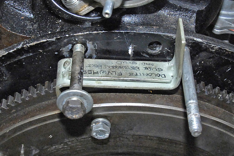

It is six months since I last posted on the running of HU 5000 which has been my daily driver except for a period of a few days when I removed the engine and sub frame assembly from the car for what is now the 8th time to replace a leaking front crankshaft seal.
In hindsight I should have replaced it prior to installing the engine during the restoration. I assumed, quite wrongly, that I had replaced it some years before when I reconditioned the engine.
The workshop manual states that once the radiator and fan have been removed that the crankshaft pulley on which the seal runs can be undone and removed. I suspect some have been able to replace the seal with the engine in the car but I would imagine that it would be very awkward to do so. The manual makes no suggestion as to how you undo that bolt which is very tight. I did it the easy way, dropped the engine and gearbox out on the sub frame, disconnected and pulled the gearbox back and using the tool that I manufactured to hold the flywheel, undid the retaining bolt, removed the pulley and replaced the seal.
20130520-4111Ptw Dolomite ring gear wedge.jpg (149.56 KiB) Viewed 3799 times
Then reinstalled the complete assembly. All without any drama at all.
Some of you might think that this is a fairly long winded way of accomplishing the task but aside from removing the front spoiler, the entire engine, gearbox and sub frame assembly is dropped out without even disturbing the radiator. It is of course necessary to replace the engine coolant and brake fluid but I regard both items as expendable and which should be changed on a regular basis anyway.

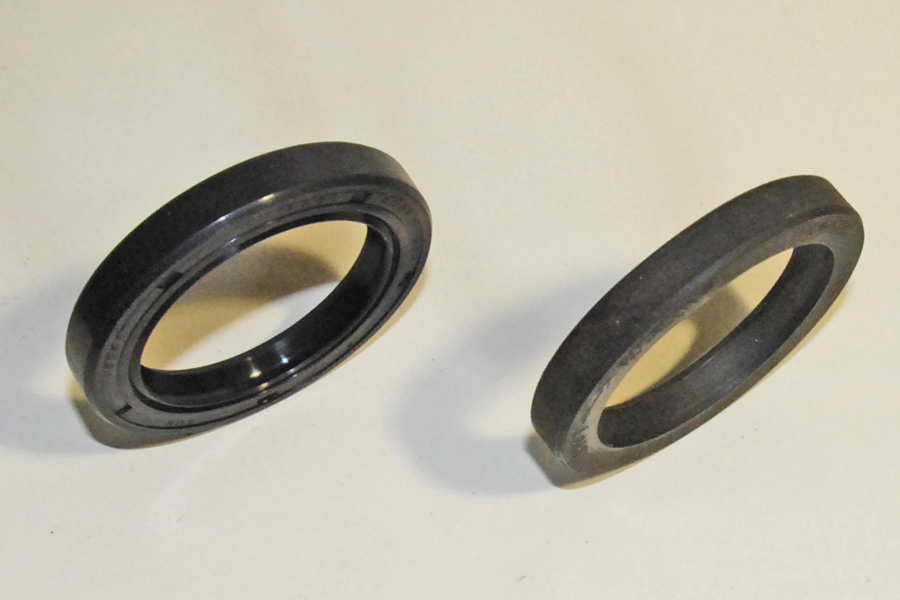

The seal was well worn but it was replaced with a more modern double lipped seal, seen here
20151017-5507Pw Double & Single lip front crankshaft oil seal.jpg (190.19 KiB) Viewed 3799 times
it is the one on the left while the one on the right is the standard seal The new seal was packed with grease between the two lips. The surface on the crankshaft pulley on which the seal runs was also lubricated with grease as well, before it was slid back into position and the retaining bolt retightened to the nominated 130 ftlbs.
The failure of the original seal had allowed a fine oil mist to be sprayed all over the engine for as it came past the seal it was flung up by the crankshaft pulley into the draft caused by both the air passing through the radiator and the engine fan, which on my engine is currently an early 1850 non viscous type. The result is a now a rather dirty and grimy engine.
I can report now though that the engine is not dropping any more oil and for these past few weeks the drip tray which lives on the floor under where it is normally parked, is dry. Long may that continue to be.

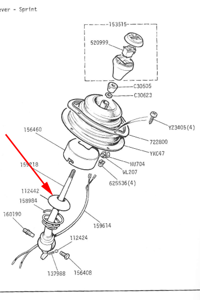

Over the last period it became increasingly difficult to engage reverse gear and I traced that to lack of lubrication on the cupped washer that holds the gear lever in place. I had cleaned everything in that area some time ago as I was working to try and cure the oil leaks on the gear selector rods and never bothered to put a smear of grease over that cupped washer shown here.
201509P Dolomite Sprint gearlever.jpg (109.48 KiB) Viewed 3799 times
The surface and the surface over which it runs were binding. A smear of grease has transformed the engagement of all gears.

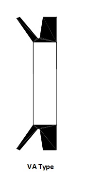

Paul
There is supposedly 2276 plus folk who have registered to be on this Forum, all waiting to hear what you have done, how you have accomplished the near impossible and that is to stop those gearbox selector rods from leaking. If it can be done, and you have done it, then I suspect there are many out there keen to find out what you have done. I suspect that many of those who have watched their gearbox mount fail will have realised that oil leaking onto that mount may have contributed to the failure in some way.
I would encourage you to share with us, show us how you managed to do it for that photo you show above is superb, not a trace of oil anywhere.
Well done!
va type seal.jpg (7.38 KiB) Viewed 3553 times
Now tell us where to go to buy and how to fit that crafty little vee seal which you used in place of the o-ring fitted by the factory. The drawing is somewhat oversize for something that slides on the 1/2 inch diameter shaft but it will serve to demonstrate what you used.
Perhaps you could start a new thread headed gearbox selector rod replacement seals or something similar in order to catch the attention of the wider Forum membership.
