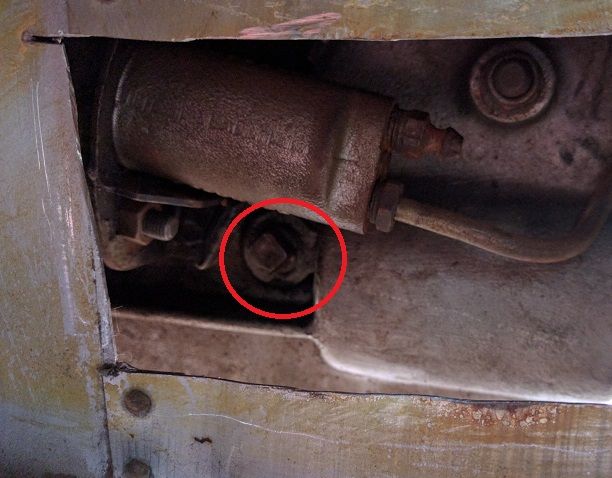

Just to make sure Im looking and checked the level at the right filler plug...
Circled in red....gearbox oil filler plug? Fill to the level until it just dribbles out?
Gearbox and OD share the same oil (same as the A-type) is that correct?
BTW..trouble with getting to it from underneath is that the strengthening gusset below the plug blocks getting a spanner on it from underneath as the plug sits back almost behind the gusset when looking from below...

#13 Post by Galileo »
That's the one, I just undid it with a ratchet socket!
