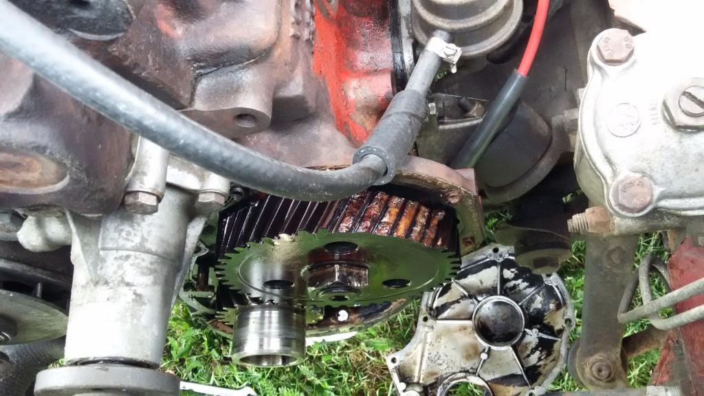

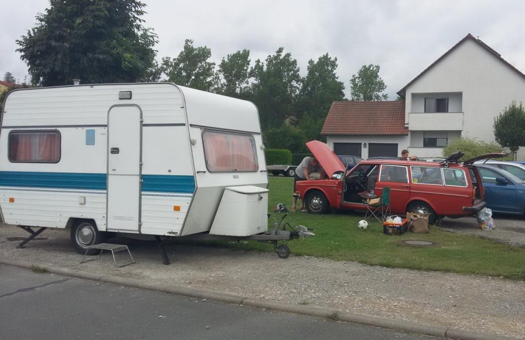

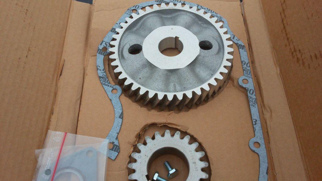

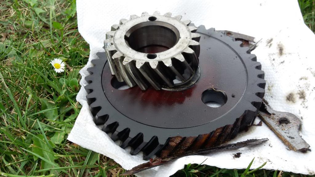

The car had it's moment before Munich when the camshaft gear did strip it's teeth. Sturdy valves and a bit flex in the pushrods was all i needed. At a parking place i did check the valve play and nothing was wrong after the valve/piston contact. I did find an enthousiastic classic Volvo parts supplier Autoteile Albert about an hour from where we were stranded and with one day delay we arrived in Italy.

Yes. About 200 km to the camping on three cilindri.
Next week some new valves arrive to drive it home. Those are one of the easiest and robust engines I have ever seen. I drive about 40.000 a year with this one and it seems it doesn't like holidays.

Brought it home today. Thanks to fahrzeugteile albert again and the family who lend me their workshop. It was a good experience for both parties. The son's of the family were in to two stroke motorcycles and were happy to see how a four stroke volvo engine did work.
As only two strokes there it was a bit improvising how to compress the valve springs.
Some tell you it's a lost day of a holiday but I did enjoy.
