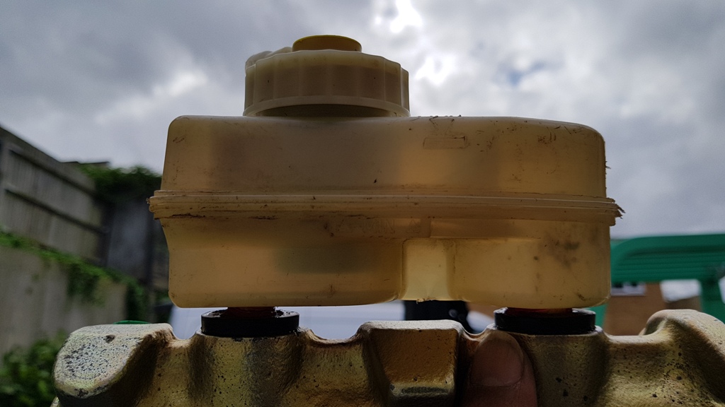

I will check how much the displacment is in the next few days,
the picture is taken that way to show the bottom of the float shroud,
it does look like the trip will occur with enough fluid in the reservoir.
