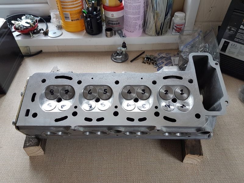

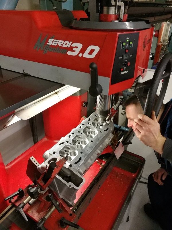

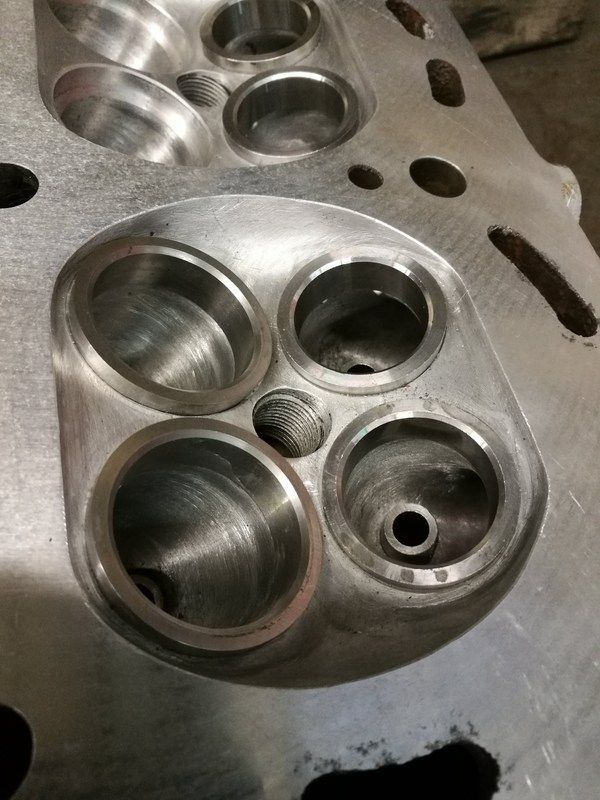

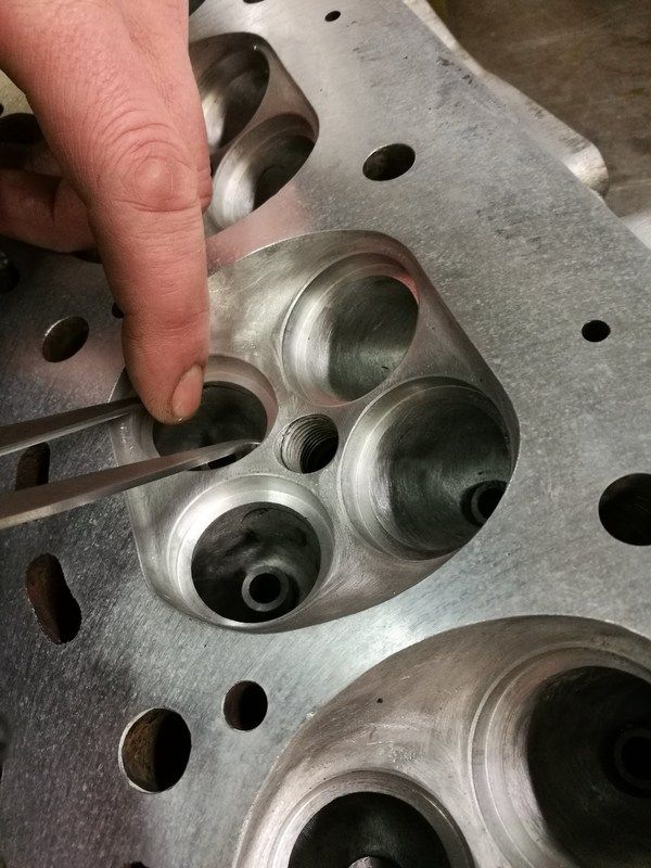

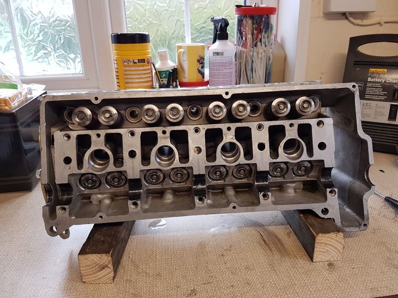

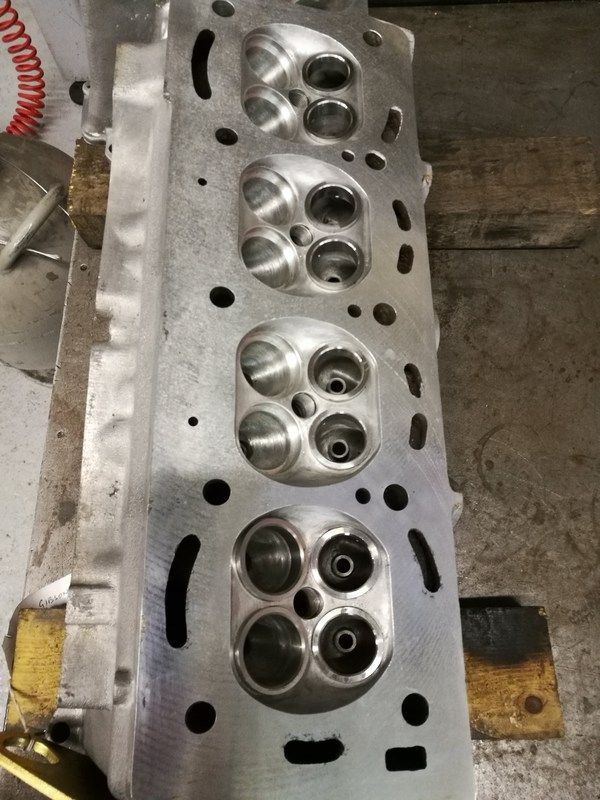

Picked up yesterday having had 16 new valve seat inserts fitted. Very pleased that the chap there seems to 'get it' and did as asked. He had all the bits so was able to cut the seats to a size so I can then shim it up properly.
Back on the bench it's definately much better than it was

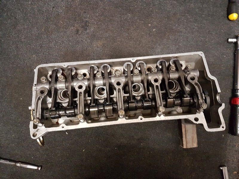

Valves, springs etc all fitted and today I did my first set of trial shims and calculated what I need. I now need to check my tin of shims and see which ones I need. All nicely in range, some can be swapped around. I suspect I may need some specific ones but wait and see.

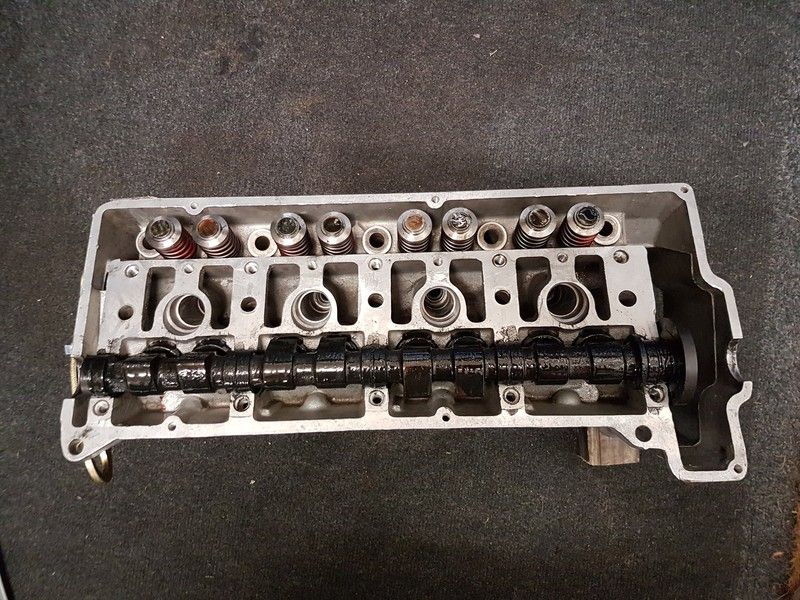

Sadly we didn't have the shims I required at work so I figured I'd order some new ones from QED Motorsport as they're not very expensive. They arrived pretty quickly so I shimmed up the head and double checked. As is my luck I had 3 shims incorrect for some reason. Perhaps I had not measured correctly or consistently, the workshop manuals I don't think are very clear. Anyway another 3 shims ordered.
I was determined this would be the final build up so gave the buckets and cam and journals a good coating of cam lube and graphogen, placed the shims and went for it. All re-assembled it seems good. A couple more times round checking and I'm quite satisfied with the end result. Brushed on a bit more cam lube and the head is now ready to be fitted to the rest of the engine at some point.
