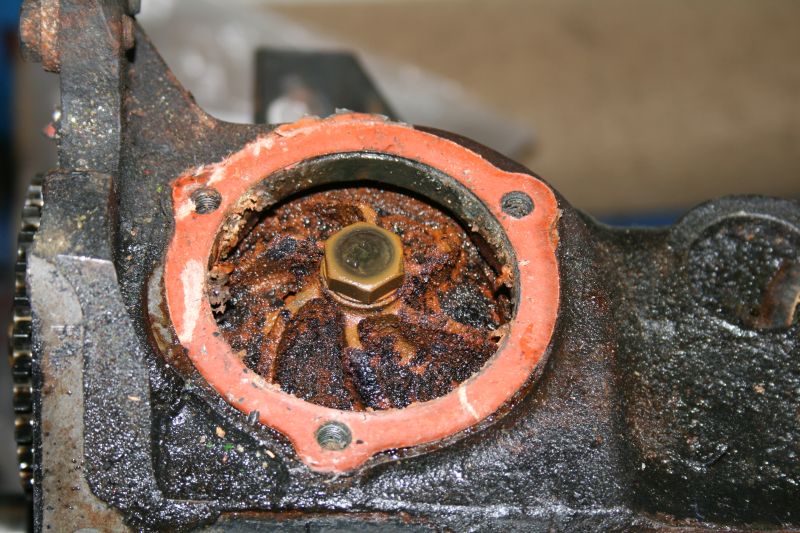

That's interesting Saab redesigned the water pump as that was IMHO the Dolomite's biggest issue. It is the heart of the coolant system... I know you can buy large fin radiators but can't see how they improve the coolant when the pump was substandard.
Top
 Post subject: Re: Early 1850 advice
PostPosted: Sun May 03, 2020 10:46 pm
Offline
Posts: 691
Location: Ayrshire, Scotland
I agree, the water pump is such a ridiculous design. What was wrong with a bolt on module on the front of the engine as most cars had in those days. This is what the pump on my 1850 looked like when I stripped it down. And talking about the strip down, what was the idea behind the angled head studs? It took me hours to get the head off when number 4 stud just would not budge.

The pump (and jack-shaft in general) seem bat-5h1t crazy to me... but if carefully rebuilt with QUALITY parts and LOOKED AFTER I don't see the cooling system on an 1850 as a problem.
But a pump thrown at the engine from 20 feet away by British Leyland millitants over 40 years ago with a hit-n-miss maintenance history... that's going to be a different story!
Presumably no-one has thought about making an upgraded pump for the slant 4, or could you use one from a Saab on a Dolly?
