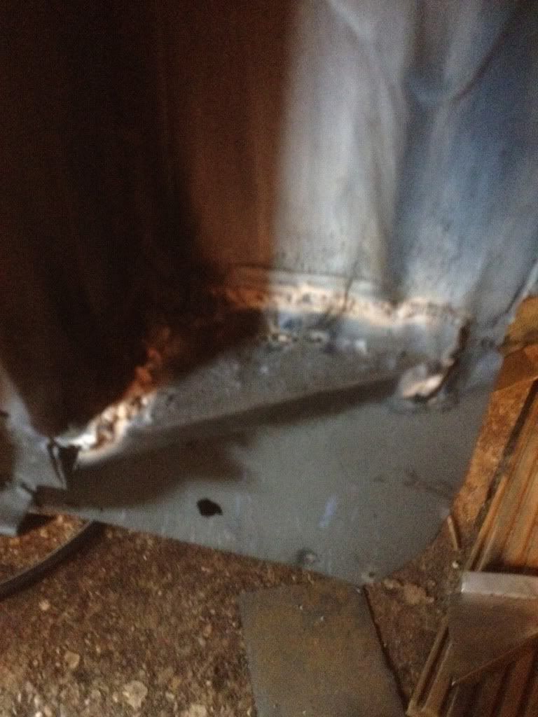

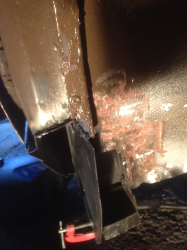

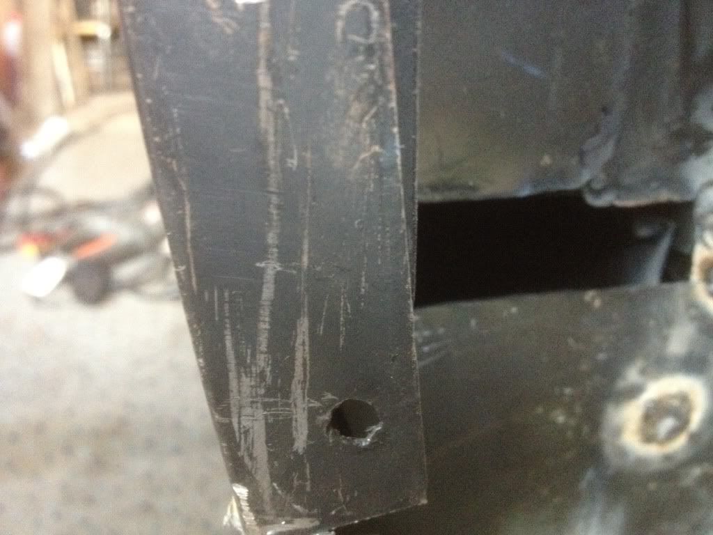

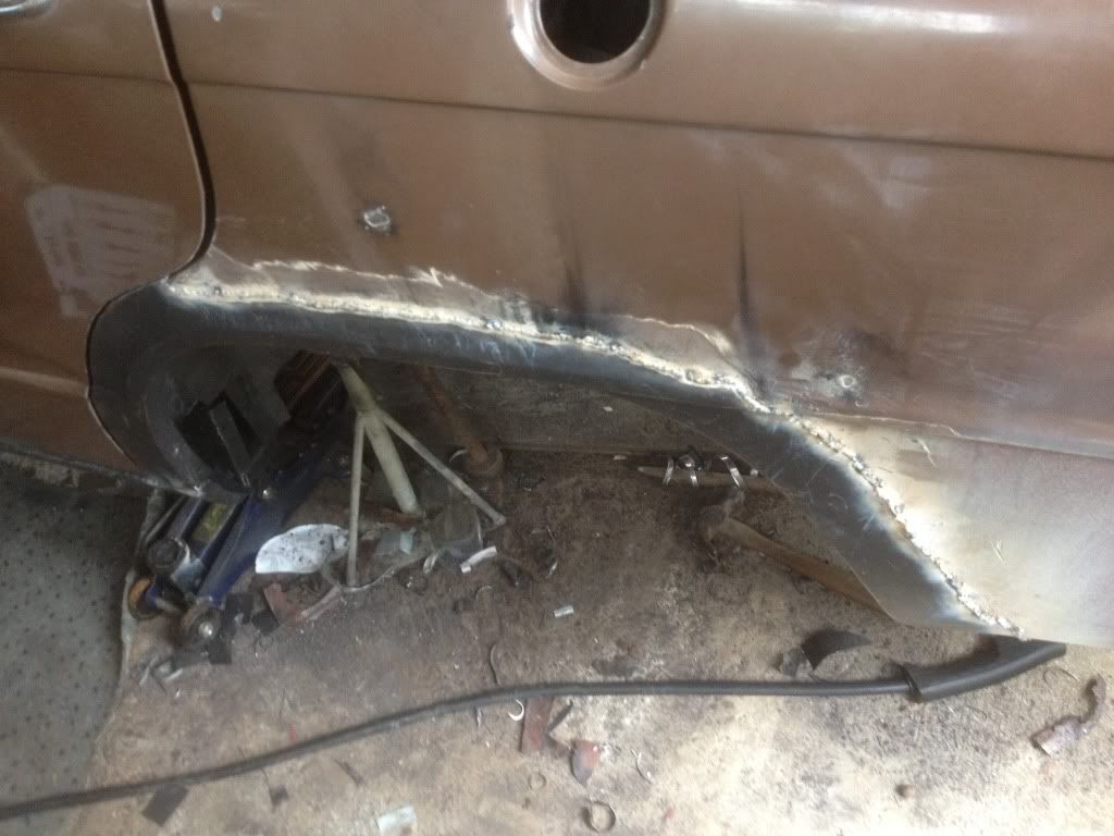

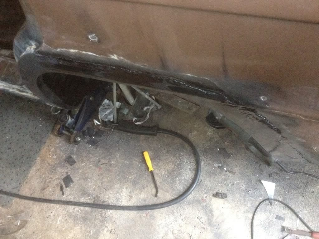

I'm getting all excited, things are starting to take shape and I'm loving this TC even more now, welding is taking shape and a I can see the light, just a little but I can see it.
I'm not posting up any pics of the engine yet, a few things to do before I do that.
So more welding done, basically I have sealed up the n/s sill and made a plate to go on the inside of the rear arch to close the sill up, I have got to seal the front but need to find some pics of the shape to help me out a little. Also fitted the rear arch repair panel and it is bloody strong, just got to flatten the welds.
Once those little jobs are done I have to finish the inner arch, not much welding to do there, but I needed to have the arch in place to do this. Then it's just a case of finishing the o/s end caps and rear arch, similar to what I have got to do on the n/s.
Pics:
All the best
Darren

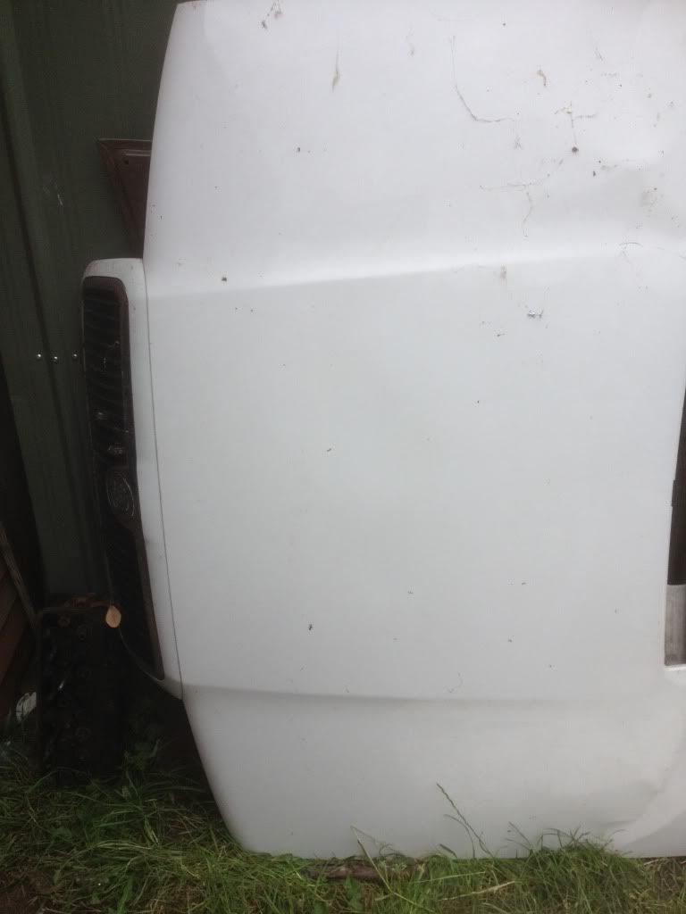

Is that a Skoda Fabia bonnet you are cutting up? And why didn't you take the repair panel right up to the top instead of leaving that gap?
Top
PostPosted: Mon Jul 09, 2012 8:07 pm
Offline
Future Club member hopefully!
Posts: 1162
Location: Colchester, ESSEX
Ha ha close Alan, Skoda Felicia, it was of my old car, I was going down the local dual carriageway last year and the bonnet catch failed at 70ish in the fast lane. the bonnet was badly crunched in the corners.
The gap is there because I need to make it with the lip for the arch, once I have done tomorrow I will post a pic.
Many Thanks

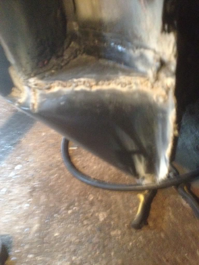

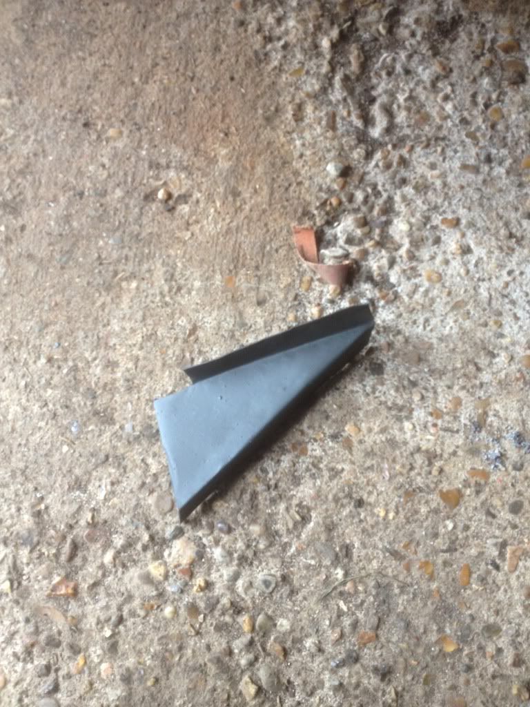

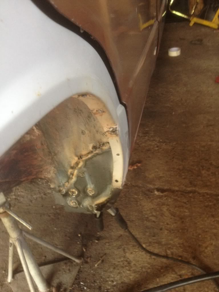

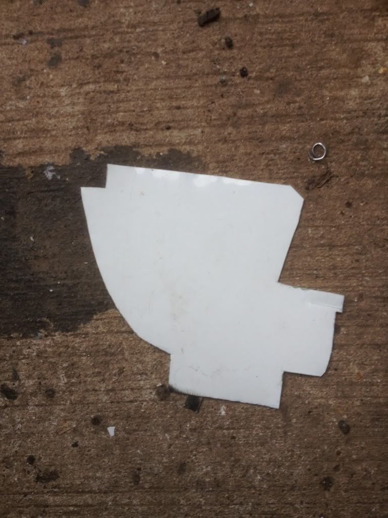

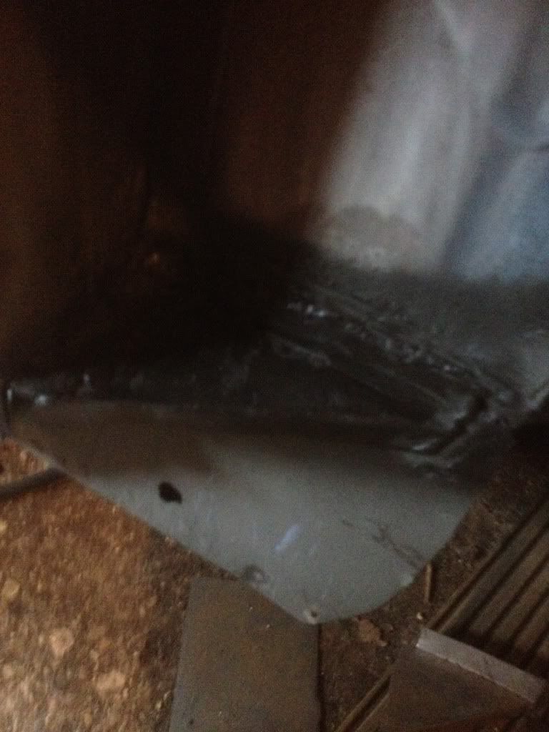

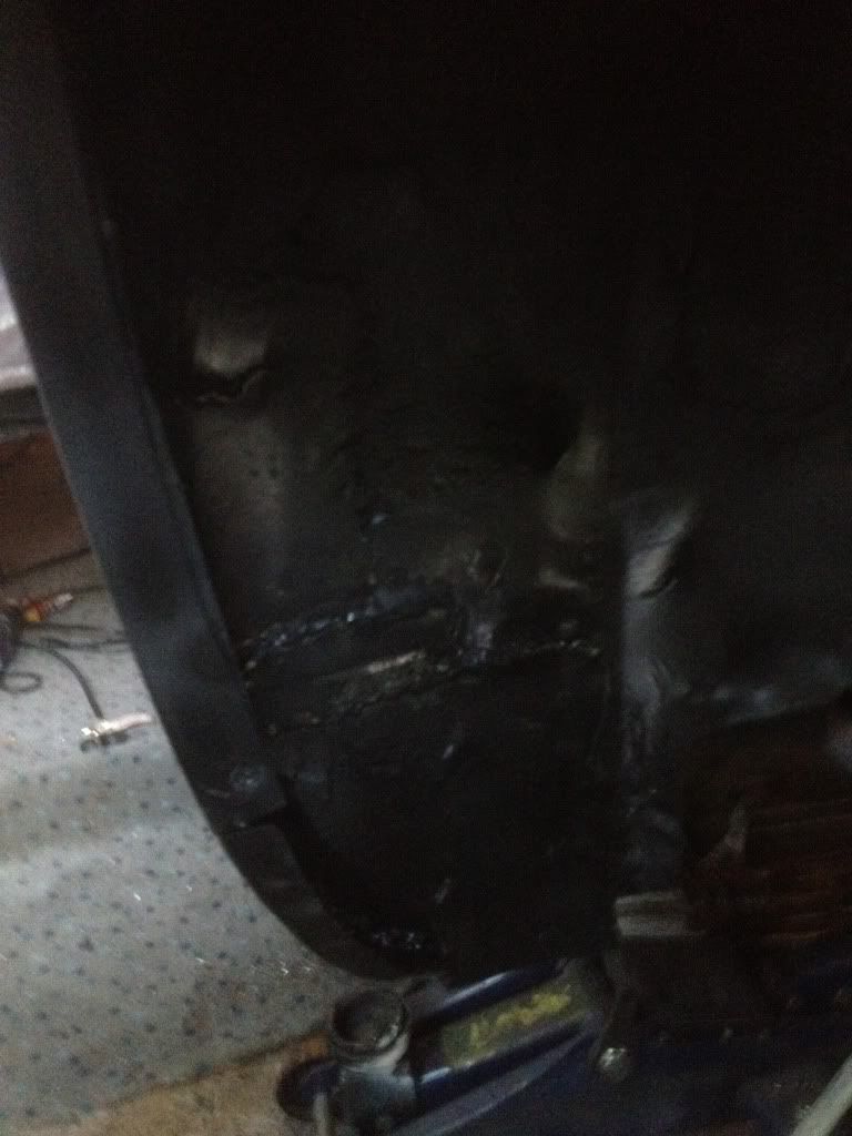

Today I finished the small plate to the arch that Alan picked up on yesterday. It took a while to get it right but it was worth it as it fitted really well.
Then I flattened the welds on the new arch and also the repair plate to close of the sill. Not bad for an afternoons work.
pics:
Getting there
Many Thanks
Darren

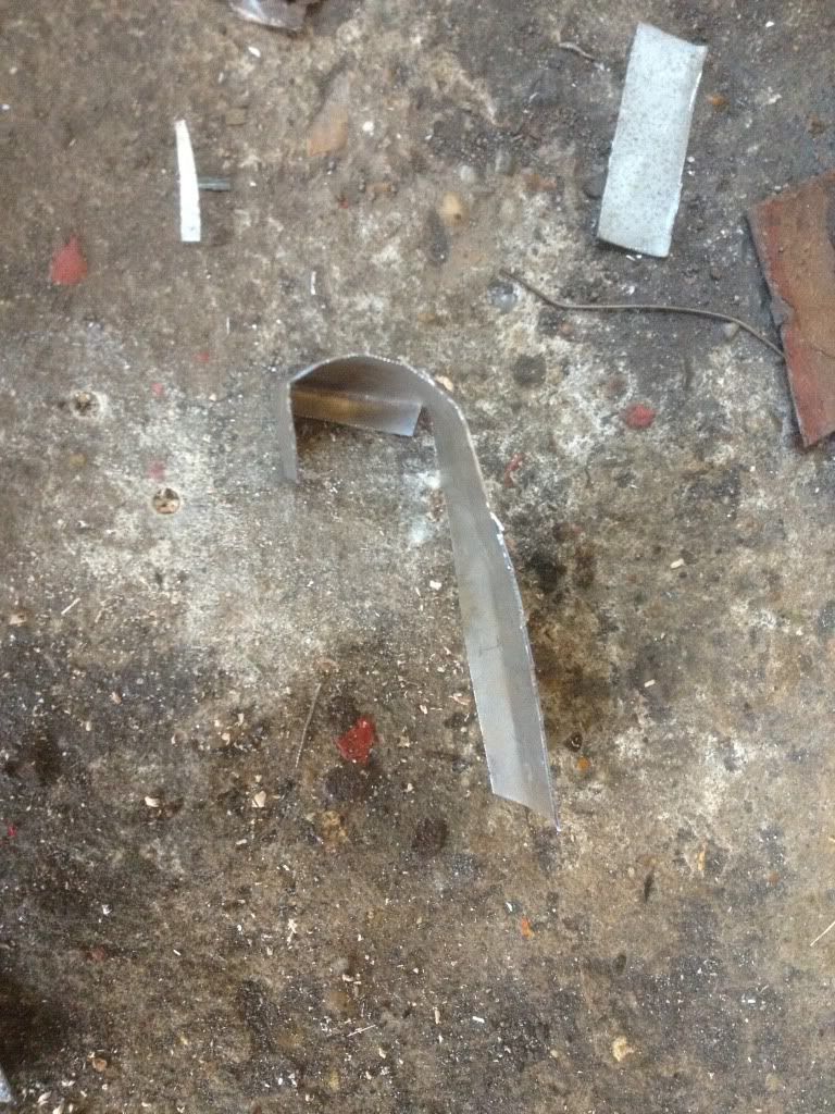

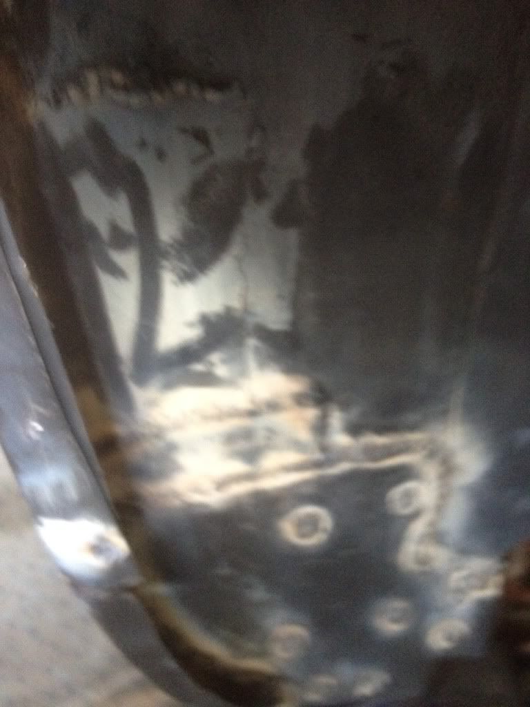

In the week I concentrated on closing the sill joints with the body and the soffitt, and also sill to soffitt, now you can really see and hear the strength.

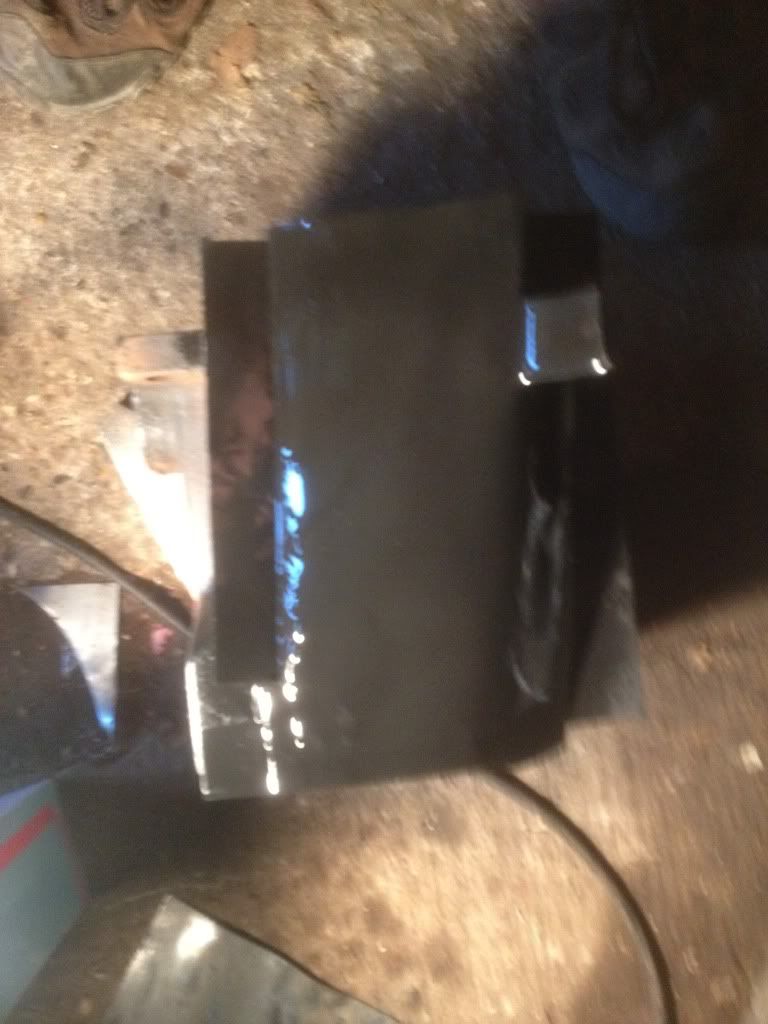

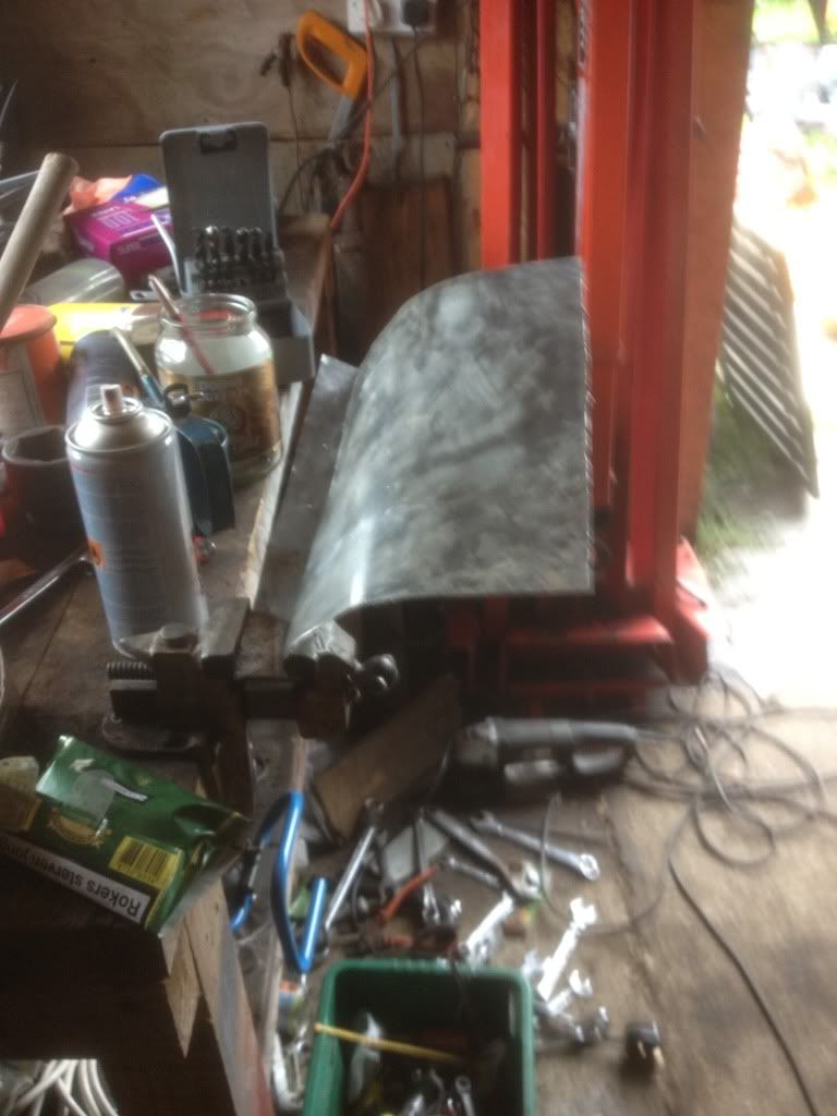

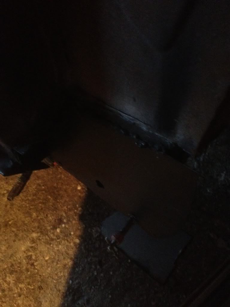

Well last night and today have been pretty tough making the end cap for the driver's side, which took around 8 hours to do today. It was worth it though as taking my time it has come out quite well.
One small problem with it though. I'm struggling with getting the wing to sit right with the section I have welded on. All the way through fettling the wing fitted fine until I welded it in. Still bloody pleased with it though.
Some Pics, the last pic shows the wing in place.
This is the pic of the wing on.
5 weeks to go :shock:
All the best
Darren

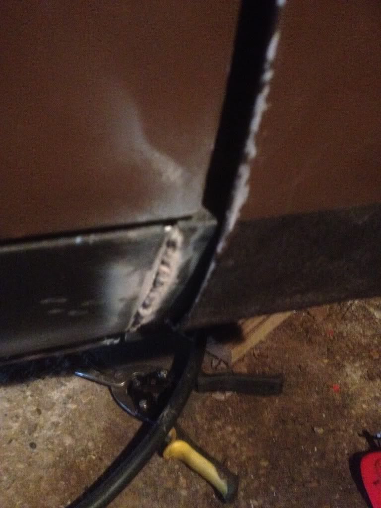

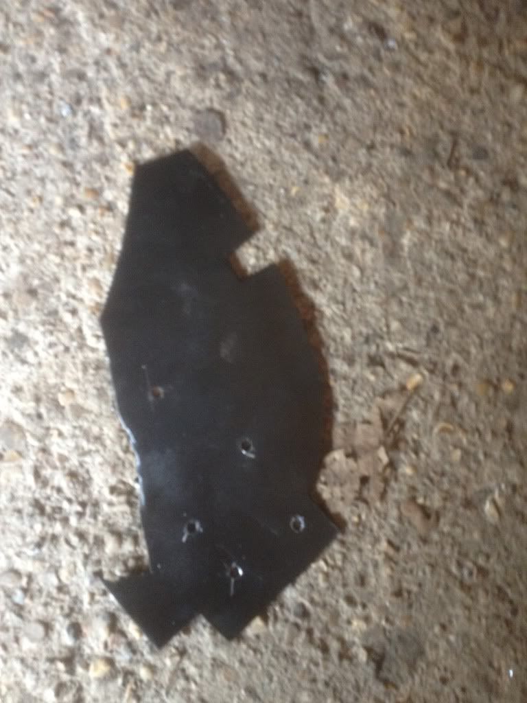

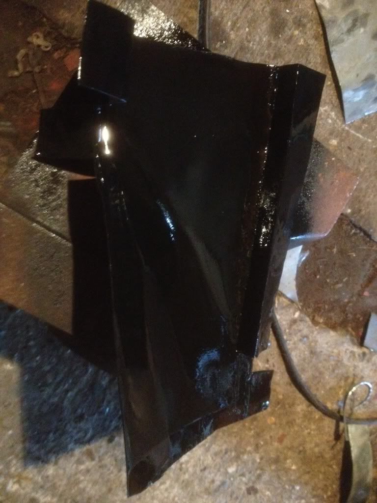

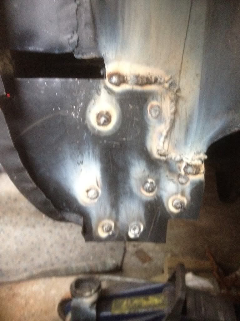

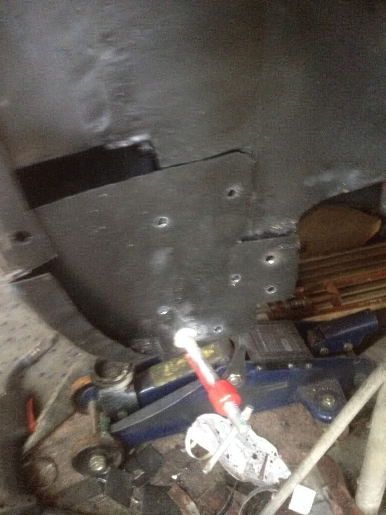

Been a busy day again forgot to take some pics of some of the painting I done on a few bits and pieces. And also of the front o/s inner wing end cap that I welded in, will do a pic tomorrow.
Any way, made and welded in the end cap on rear of the o/s sill. I have got to do a little bit of fettling there, also put a patch on the join in the rear footwell from the inside, also going to put a plate on the outside as it's a join I want it to be ultra strong. Just wish panel making didn't take so long. Getting well bored of welding now, but if I'm going to get some paint on bits I need the welding finished. Just got the n/s front end cap to do then I can finish the inner arches.
Some pics:
All the best
Darren
_________________
