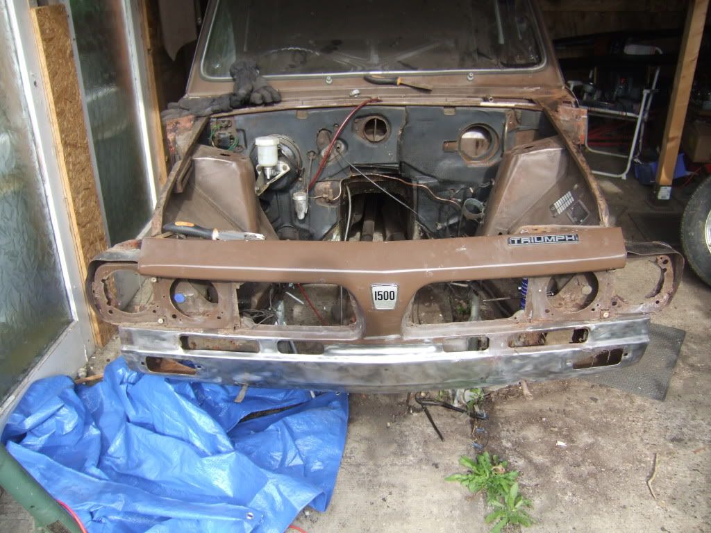

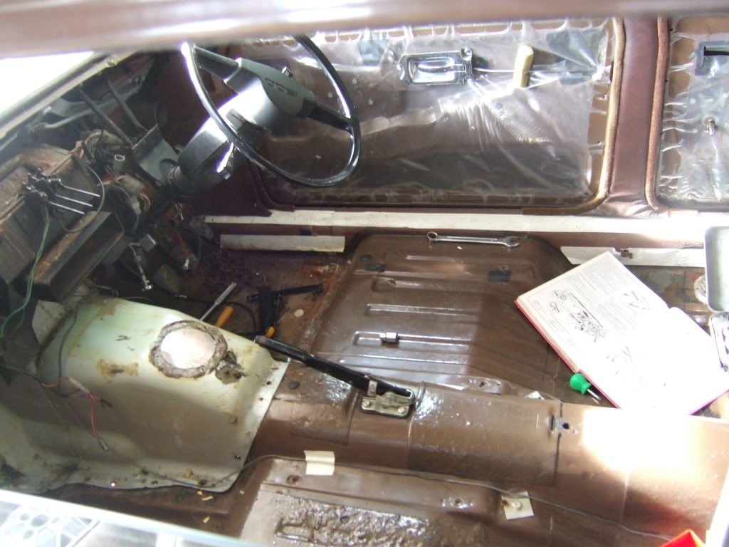

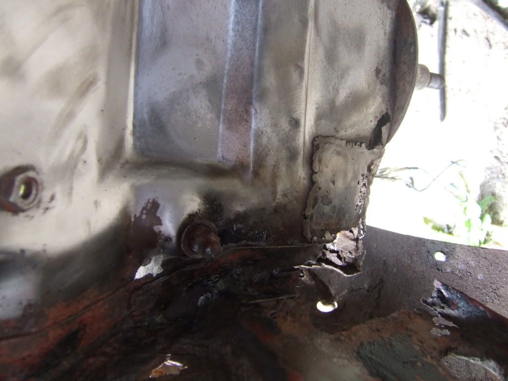

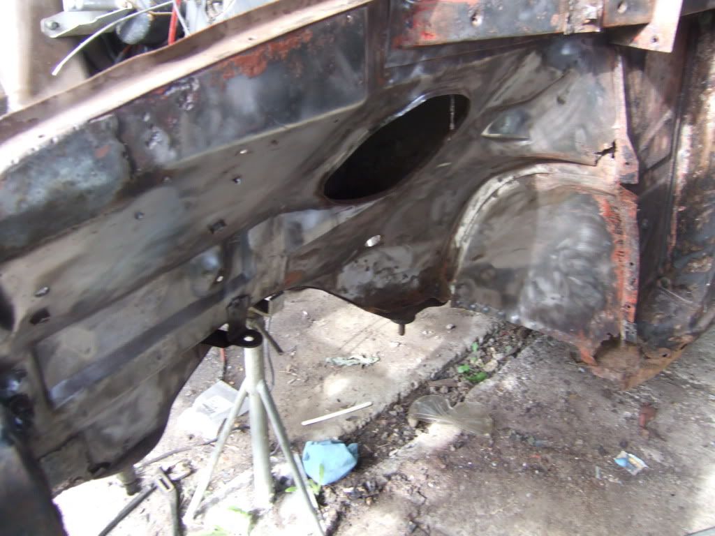

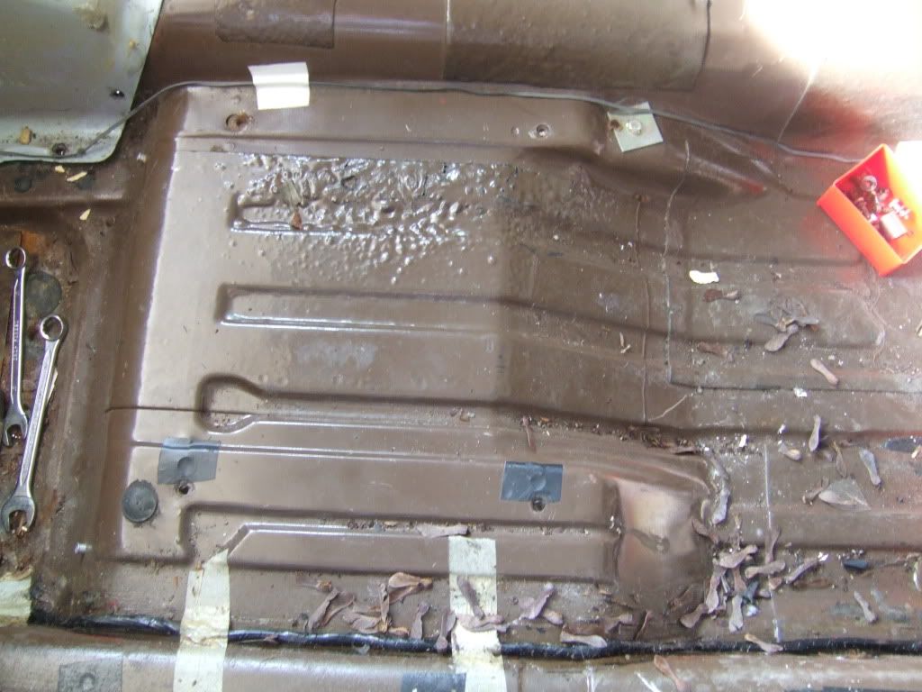

Hi Guys
I thought I would download some pics, to show you the progress that im slowly making.
Ready for welding, just waiting for the mig to come from my mates.
regards
Darren
_________________
Top
PostPosted: Fri Jul 02, 2010 10:58 pm
Brilliant stuff. This car probably wouldn't have survived without your kind of determination, keep the updates coming please.
:thumbsup: :thumbsup:

Thanks for kind words John.
It has been hard work, especially on these hot summer days we are having at the mo.
Also the colour isn't Sienna brown like I thought, its Maple, so hopefully will get a good match from paints4u. Also struggling to find Hammerite Brown to go over the stonechip once she's been welded.
I am aiming for spring 2011 to have her on the road, so fingers crossed.

PostPosted: Sat Jul 03, 2010 8:19 pm
Fingers crossed here too. Fantastic work there, cannot say how pleased I am to see a brown 1500TC receiving this amount of work and dedication. :thumbsup:

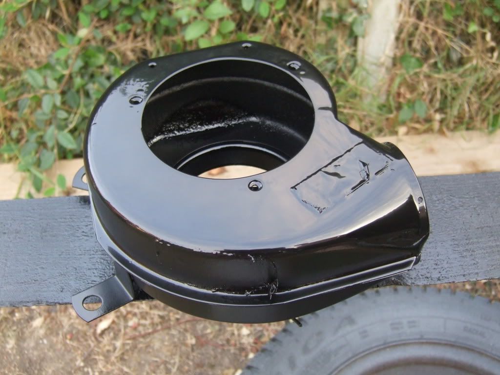

Not done alot this week, due to me being on a course for work, had to study.
Mig welder has finally turned up, im dreading this bit. Never used a mig in my life so its going to be a big learning curve.
Also I have now found that ronseal do a brown paint similar to hammerite, but also hammerite do a chestnut brown, so i will give them a look.

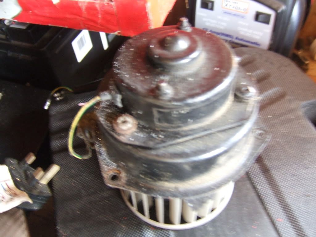

The rest of the heater is now painted, I will take some pics at the weekend and put them on, it look bloody good :P
