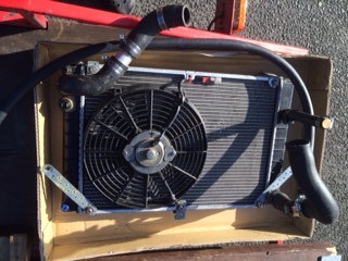

Photo shows Porsche 944 set up for installation. Brackets are rudimentary but fine. Standard hoses cut and extended. Note inbuild temperature sender ideal for contolling fan on/off.
944 rad.JPG (49.85 KiB) Viewed 2357 times
