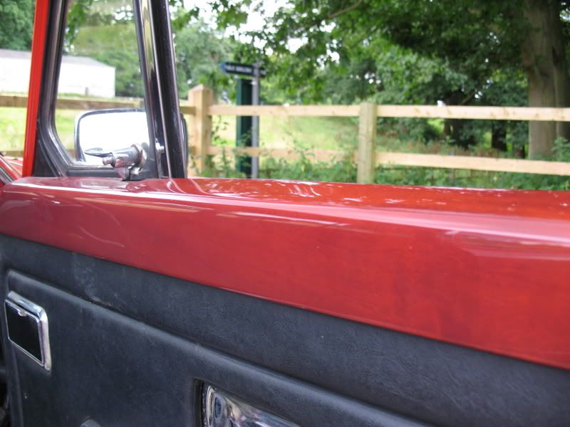

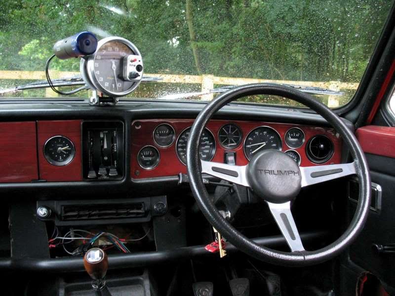

O/T that's an interesting finish on the dash?
Lewis
Re: Sprint headgasket replacement - and questions....(Pic heavy)
#8 Post by Lewis »
Thanks - Yea, nice, isn't it. Unfortunately the glovebox has a nasty crack in it. I'm not responsible for it, unfortunately - but I did see what it was done with (recognised the finish and colour) in Homebase so I'll track it down for reference!
Door cappings are done in the very same, almost like glass!
