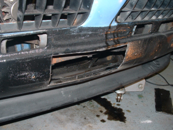

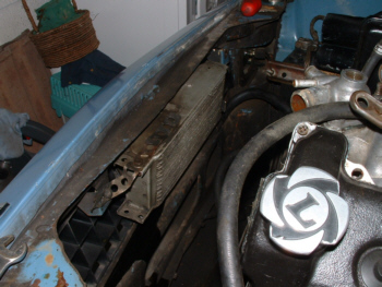

I have seen them fitted along side the rad as you've mentioned. Mine was fitted in front of the rad but I've now relocated it to behind the number plate. Don't think you'd want to do this on a nice road car though. <!--EZCODE EMOTICON START :eek --><img src=http://www.ezboard.com/images/emoticons/eek.gif ALT=":eek"><!--EZCODE EMOTICON END--> <br>
<br>
<!--EZCODE IMAGE START--><img src="http://www.dolomitesprint.com/images/oilcooler1.jpg" style="border:0;"/><!--EZCODE IMAGE END--><br>
<br>
<!--EZCODE IMAGE START--><img src="http://www.dolomitesprint.com/images/oilcooler4.jpg" style="border:0;"/><!--EZCODE IMAGE END--><br>
