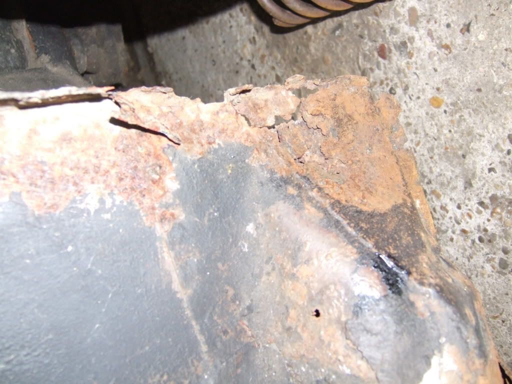

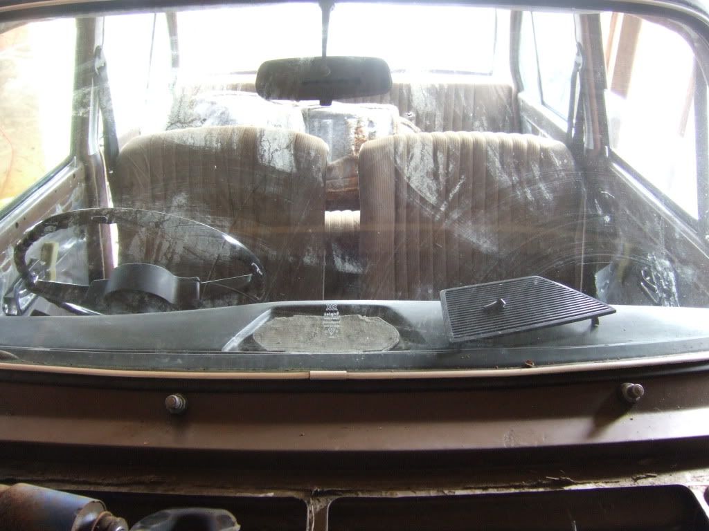

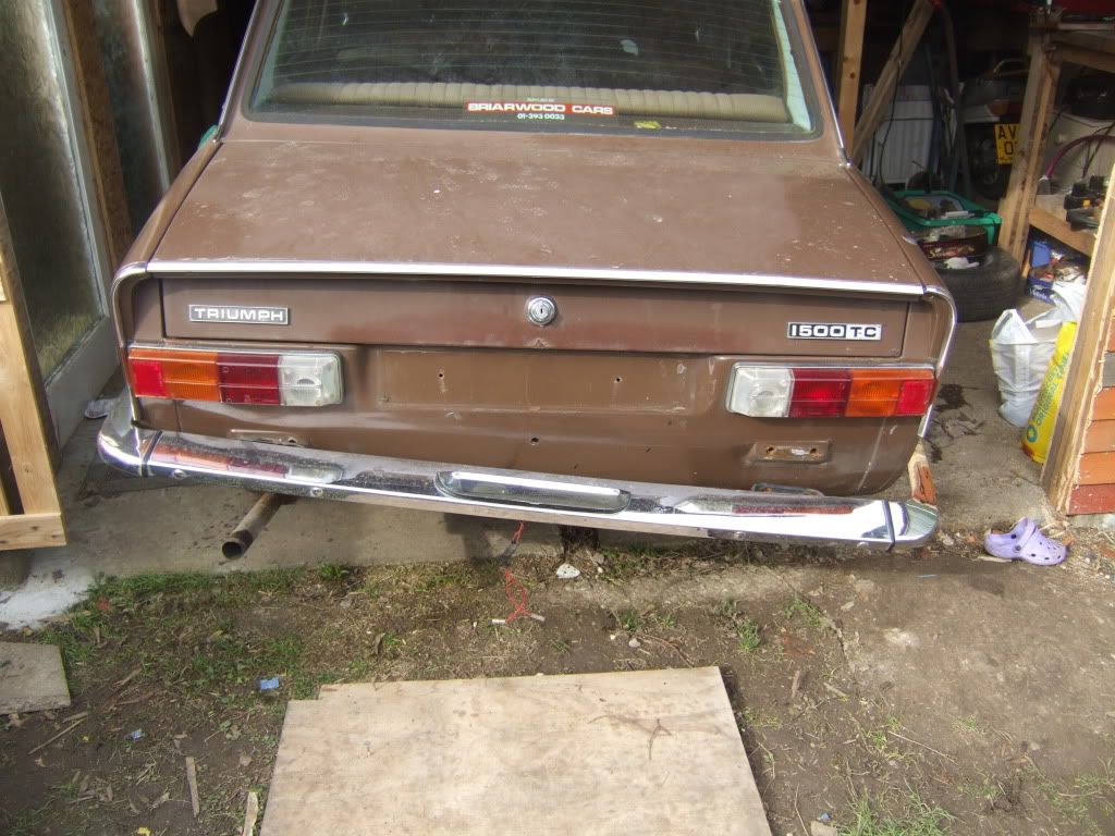

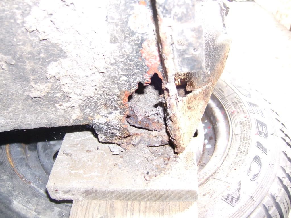

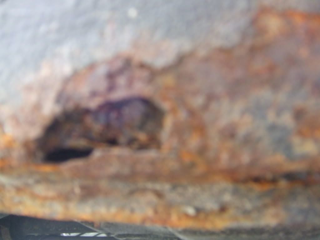

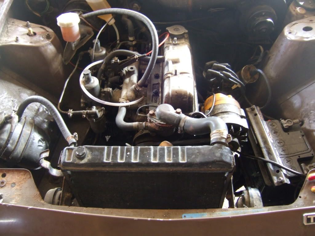

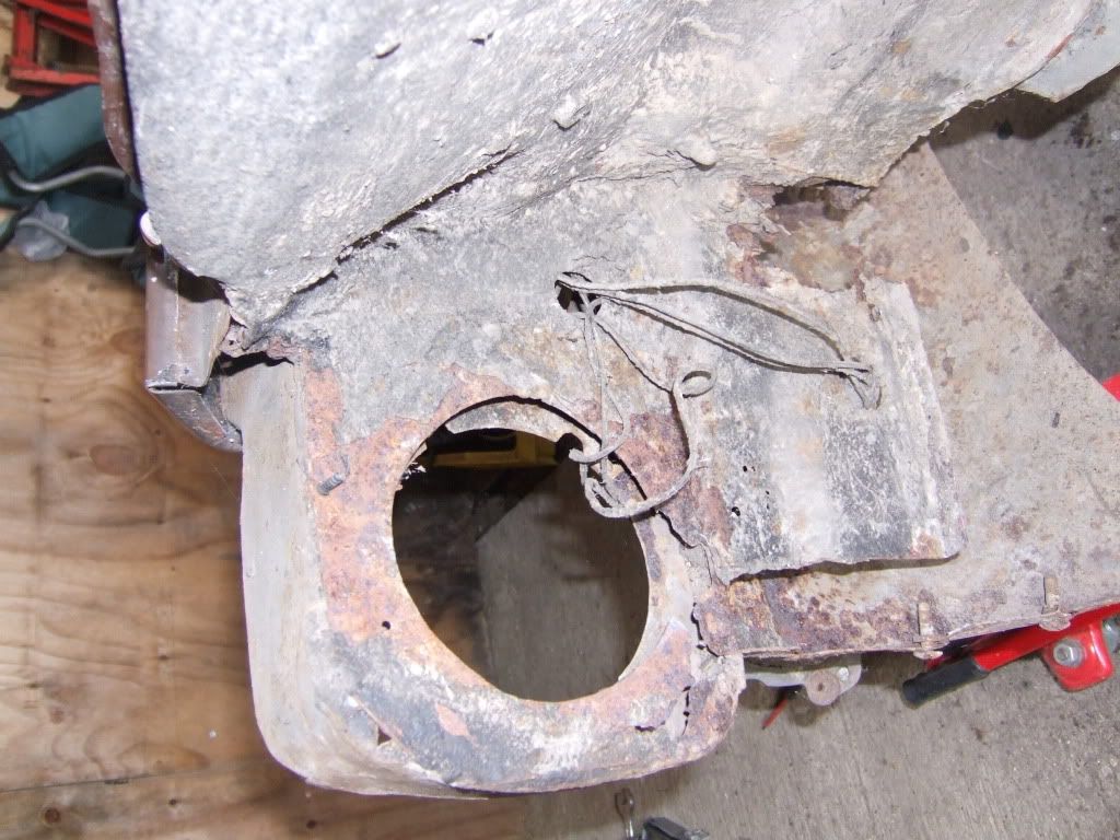

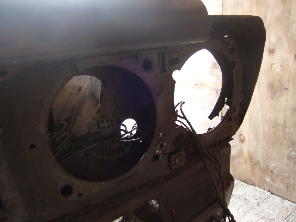

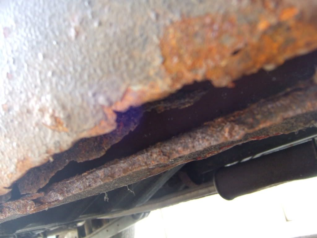

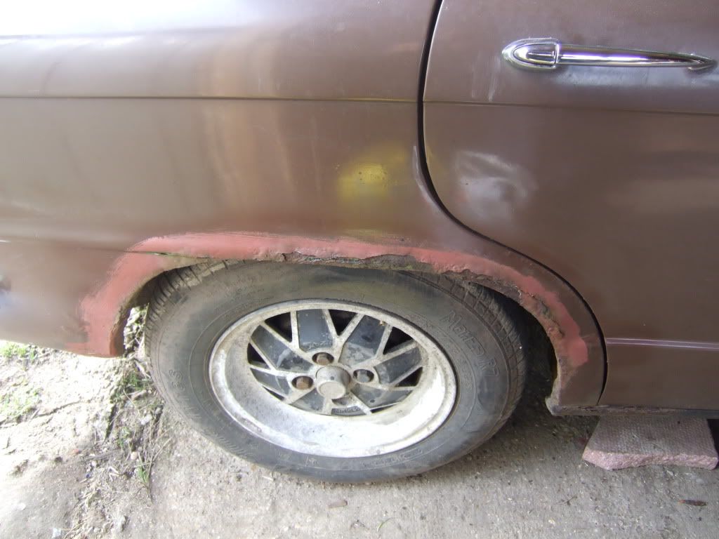

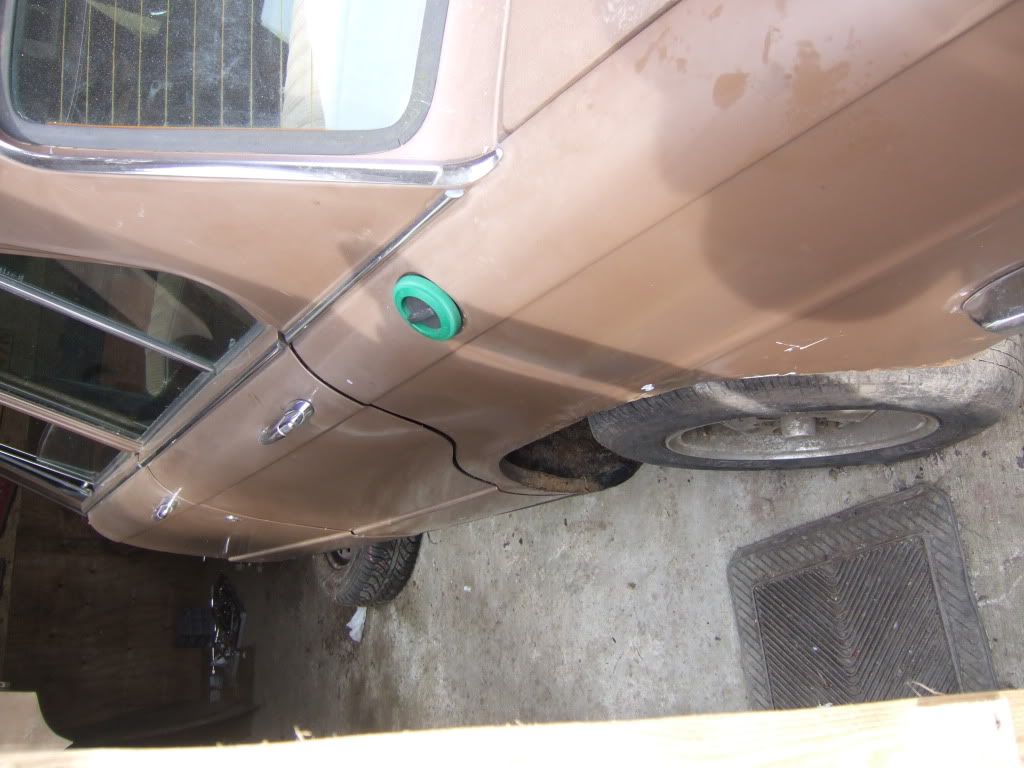

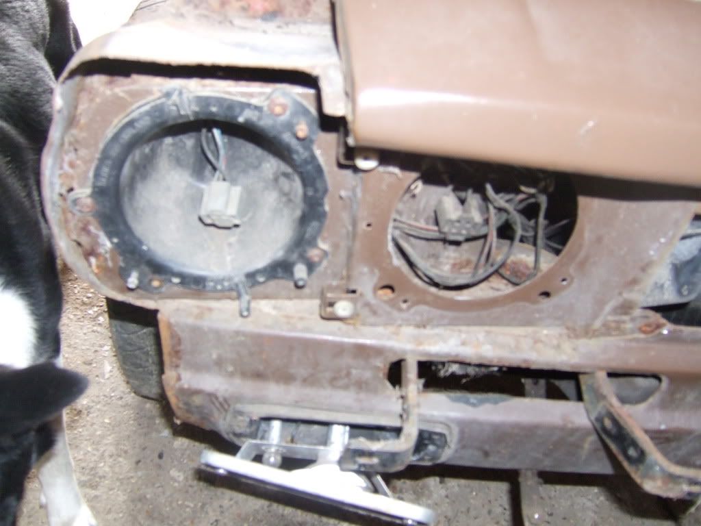

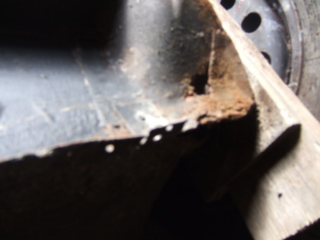

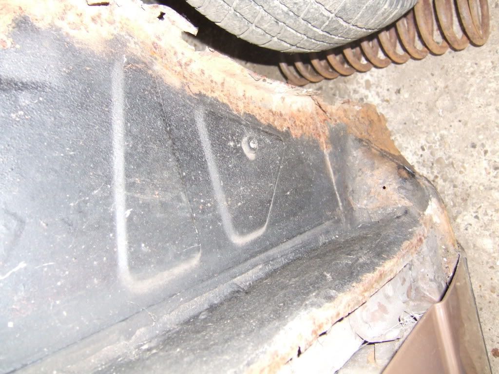

Hi guys some pics as promised
Regards
Daz
Purplebargeken
Re: Restoration Triumph 1500TC
#21 Post by Purplebargeken »
Seen worse.
Phil_G
#22 Post by Phil_G »
likewise.. good luck with it mate!
#23 Post by DoloWIGHTY »
Headlamp panels have survived really well - result! :thumbsup:

Thanks guys,
