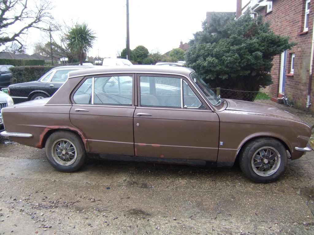

Hi to everyone
I am trying to renovate my triumph 1500TC 1974 (N), that i recently bought :lol: but where do i start. The guy i bought it off was going to way it in. So another Dolly saved from the crusher.
I thought trying to get the engine running would be the way to go, but turns over and I have got spark but nothing else. Next door neighbour told me it was down to low compression, and squirt redex down into the pots, i tried nothing, then i was told to put diesel down there which I done but nothing. Then on reading the haynes manual, I found that the firing order was wrong and was set too 1243, when in fact should be 1342 anti clockwise but still nothing. I then got tdc and rotor arm pointing at bottom left of dizzy, then when i turn pulley 1 full circle i then get rotor arm at the top right corner, but still nothing (i need help)!!!
So I have started stripping the front end, both wings are fibreglass and both sills have been done at some point, but off side sill now has more holes then the titanic :roll:
Both inner wings look good, needs some welding towards the bottom of the pillars, inners look good and behind the headlights needs some work, all Chrome work is in good condition.
Its got the sprint alloys but at somepoint would like to swap with originals rims.
Also the old girl hasnt got no ignition barrel I had to take this out as I bought the car without keys :oops: well i got a boot key :D
I will list some photo's when i work out how to do it
Please help guys
Regards
Daz

Hiya Daz and welcome. Another TC saved, well done. Fibreglass is ok, especially the stuff available from the club. Steel stuff is available but pricey. Can't advise re: engine but no doubt others will. Godd sills available through the club as well, but ya gotta join.
Rims are standard Dolly stuff, easily available and cheap. people do actually give 'em away. It's the wheeltrims that you need, again, not hard to get. They were modified to fit the ordinary rims. Sienna, nice colour.
We love seeing piccies on here, so try and post some up. Gives a better idea as to what you are dealing with. You'll have to register with an image hosting thingy like photobucket first though.

Thank you ken i have been reading your thread and others for a few weeks, amazed at what people can do. hopefully these piccies will work!!!

Well done Daz - another one saved! Lovely colour.
Top
PostPosted: Tue Mar 16, 2010 9:53 am
Great stuff. Thanks for saving another one. 8)

Thanks Guys the wife hates the colour lol.
When i have been jacking the front end up I couldn't get the wheels of the ground, just found that there is no anti-roll bar fitted :oops: so will have to source one. anyway got the wheel off by letting the air out of the tyre :D

Welcome Daz, and as the others are saying, well done on rescuing the car. Sienna on a '74? :scratchin: Have to admit that it looks a lot like it though....
I'm almost amazed to see that those GRP wings actually fit! They look good.
One thing though; didn't Titanic only have the one hole? OK, so it was a f**kin' big one.....

Nice pics Daz. That is a tidy looking car. The fit of the fibreglass wings do look very good indeed. That is a nice colour, I remember it well.
Always useful to post some bits wanted in the appropriate bit of the forum. Someone will usually have the bits. The sills from the Club (via xvivalve) are simply the best. Well worth joining up for on their own.
