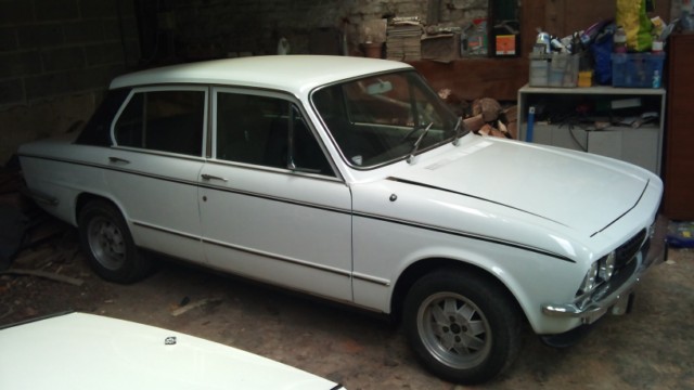

Hello,
Before writing anything else , I apologize for my poor English, i am french ( nobody's perfect ), quasily Belgian ....
I am the new owner of an auto 1850 HL , it now shares the garage with a 72 spit mk 4 and a mini restoration project
I found you forum while i was desperatly looking where to find engine serial numbers .
The dolly needs work on brakes (blocked) and new soft carburators pipes replacement
I already possess a spare engine , with an manual OD gearbox .
I would like to convert my car with this gearbox , but haven't got the right transmission axle .
Do you think it is possible to convert a sprint axle into a 1850 manual one ???
Laurent
Laurent

Hello and.......
Welcome to the forum Laurent.
Your car looks a good project.
In answer to your axle question,
fitting a Sprint axle is not the best option.
It is higher geared (3.45:1) than a 1850 manual (3.63:1) and the differential is a different shape which would mean
swapping the entire axle and having a bespoke propshaft made.
An 1850 auto differential is much higher geared (3.2:1) than the manual version so is not really suitable for a manual car.

Bonjour Laurent. Je parle Francais - un peu!
Welcome to the forum. Your English is probably better than my French! My sister-in-law (brother's wife) is French so the language barrier isn't going to be a problem.
Ian, you're right about the 1850 auto having a different ratio axle. The best way to convert would be to use the 3.63 ratio diff. I think it would be best to leave it as it is as there's comparitively few 1850 autos left. LHD 1850 autos must be even rarer!
Re: Froggy Dolly
Well said Toledo Man! Leave the high ratio diff and the automatic transmission in there & enjoy the economy and the smoothness of it all.Toledo Man wrote:.....I think it would be best to leave it as it is as there's comparitively few 1850 autos left. LHD 1850 autos must be even rarer!
Oh, and Welcome to the forum.

Welcome Laurant. Your car looks to be in lovely condition. I bet there aren't many other LHD 1850s near you!

thanks for your comments
i don't know any dolly 1850 , only 1 sprint in the club
i bought this one because the body was in a very nice condition (dinitrol treatment)
maybe because of the sticky brakes(maybe not) , the gearbox leaved its oil on the road when testing the car , that's why i guess to swap the gearbox ,if necessary, because nobody able to work on a borg-warner auto gear box here .
