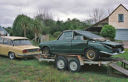

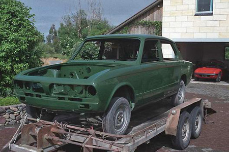

I purchased the car from the second owner Alan after it had been badly damaged in a rather unusual accident which wrote off a number of cars. A retaining wall up which this and the other cars had been parked collapsed crushing the back of the Sprint. I had seen this car long before the accident and had suggested to the then owner that if he ever wanted to sell then I would like first option to purchase. This first photo comes courtesy of the Dominion Post newspaper. One of the disadvantages of living so far from the UK is that the restoration of any car – in any condition, is compounded by the distance and inaccessibility to parts. Oh how things have changed with the internet revolution!
The trim on this car was in first class order for even when I purchased it in the state you see it here, the protective coverings that covered the doors and which were usually removed at the pre-delivery check were still in place.

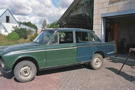

The second photo should show the car as received and delivered back here. The next step was to find a donor car for it was my initial intention to simply strip all the Sprint parts from this car and move them across to the donor car. A donor was found and purchased and then I was introduced to an outstanding tradesman. Brian acquired his skills in England before emigrating to New Zealand and working for Autorestorations, http://www.autorestorations.co.nz one of the premier restoration companies in this part of the world. He had all but retired when he viewed my project but he stipulated that if he was to be involved it would have to be done his way.
He proposed to carry out what they call in the trade, a cut and shut. He said he would cut the back end of the damaged Sprint and graft on the good back end of the donor. In that way the chassis plate would remain where it rightfully belonged. He knew exactly where to undertake the cutting of the two bodies for once I had removed items like trim, brake and fuel lines, and prop shafts he returned to the house and following another inspection, borrowed my circular saw, removed the guards and fitted a cut-off wheel and within a matter of hours the various body parts had been separated, the good halves welded back together and the shut operation had been completed.
It is fortunate that in this part of the world that rust is not the problem which others restoring their cars have had to cope with. During the body restoration process Brian was able, to demonstrate the true art of a craftsman by, for instance, using various techniques such as using a polishing buff to gently warm areas of the body and so shrink the metal and remove minor creases and dents.

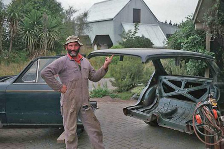

This last photo shows Brian separating the body across the body seam and cutting through the sills.

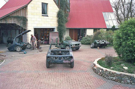

Cuts and Shuts!
Cut and shuts have a bad reputation in this part of the world too for as Brian was able to demonstrate it can be done very quickly and had the two halves matched colour, is a relatively cheap way of making one good car out of two damaged wrecks.
Perhaps it is worth noting that this project was started way back in the late 1980’s and the rules and regulations have changed here in New Zealand. Had the car sustained a similar amount of damage today then I am sure that the insurance company (the owner) would be obliged to write the car off and in doing so, if the car was restored in the manner which Brian has shown can be done, then it would have been necessary to go through quite an elaborate inspection process which has been adopted here in the last twenty years. It would have involved registered and certified engineers inspecting the work as it was being done to ensure that the completed repair was sound. And only then would a new set of registration plates have been issued.
What prompted Brian though to opt for this solution in this case was that the car had not been shunted in any way so there would not be any distortion through the front of the car. The wall had collapsed quite slowly and squeezed the back of the car into the shape you can see in the first sequence of photos. That is evident by the way that the rear left hand passenger window did not break as the wall lay down over the car.
Brian could see where all the factory joins were in the pillars and very carefully cut across the floor of both cars – on the good Sprint front half, immediately behind the seam on the floor well and ahead of the same seam on the donor car. Peeled the spot welded strips remaining, off both and then wheeled the two halves together. He brazed that seam joint together so it is stronger than it ever was.
This sequence of photos shows the separated bits of the two cars. It is hard to believe that at this point Brian would make one good one out of what is shown here. This second picture shows Brian supporting the back end of the second car and as you can see the body section is pretty balanced around the back wheels. This last picture shows the car joined together, with the doors and front windscreen sat in place, all the shut lines are what they should be. Some donor Triumph Herald wheels have been fitted in order to move the car around.

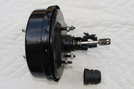

I am still on a search to find the bits necessary to restore this servo. I managed to get it apart this week but have not yet figured out how to pull all the internals apart.

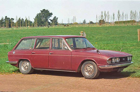

So to conclude, a photo of a broken brake servo, a rather rare PI wagon and a shot taken after the later February 2011 earthquake. This is to demonstrate to a certain group of UK TV presenters that even Toyota Landcruisers cannot cope with some of what nature dishes up to us. No matter that they think they might be indestructible – or can go anywhere. Drive it out of this hole lads!

I wonder if that bakelite servo nose thing is common to the larger servos fitted to the 2500/stag ?
If it is, then you are welcome to the spare one I've got.
I should go out and measure it, but I don't have an off-vehicle dolomite servo. Anyone know ?

Several of the mature trees on this property simply fell over. Saved me a job for I was going to drop them for next year’s firewood anyway.
When the earthquake hits you drop, cover and hold and hope for the best. It becomes automatic, as I discovered to my embarrassment when I met some folk at Kings Cross station last year. Someone remarked later that it was only the Eurostar train arriving - nothing to worry about!! The sound though – and you do hear an earthquake before it arrives, sounded very similar. So I picked myself up off the floor……..! And the meeting continued.

And you are right, it’s difficult to remember 20 years on from when the car was dismantled exactly where things went.
For instance where does the brake pedal return spring go?
The workshop manual sort of suggests that it sits behind the pedal and as I see, picks up the slot in the back of the pedal. There is a hole in the side of the pedal between the numbers 2 and 5 in the illustration but if you pop the tail of the spring in there and use the hole in the back of the steering column mount it does not pull the pedal back onto the brake light switch and the pedal hangs below the clutch pedal. In that position it sits, rubs up, against the side of the switch itself. I have hooked it behind the pedal as the second photo shows but even then it sits very close to the switch.
Note the wires are not yet connected for I am still trying to figure out exactly where the wiring harness sits to the right of the brake servo actuating rod. All the P clips are in position but it needs to “sit” in some tidy manner so that it never gets hooked up in my boots when I am driving.
Stu, there may be some commonality with some of the parts in the brake servos across the Triumph range. There are some brake reconditioning outfits in the city here to whom I shall be taking my now dismantled servo to see what they say. Thanks for your offer, I shall come back to you if I need anything.
