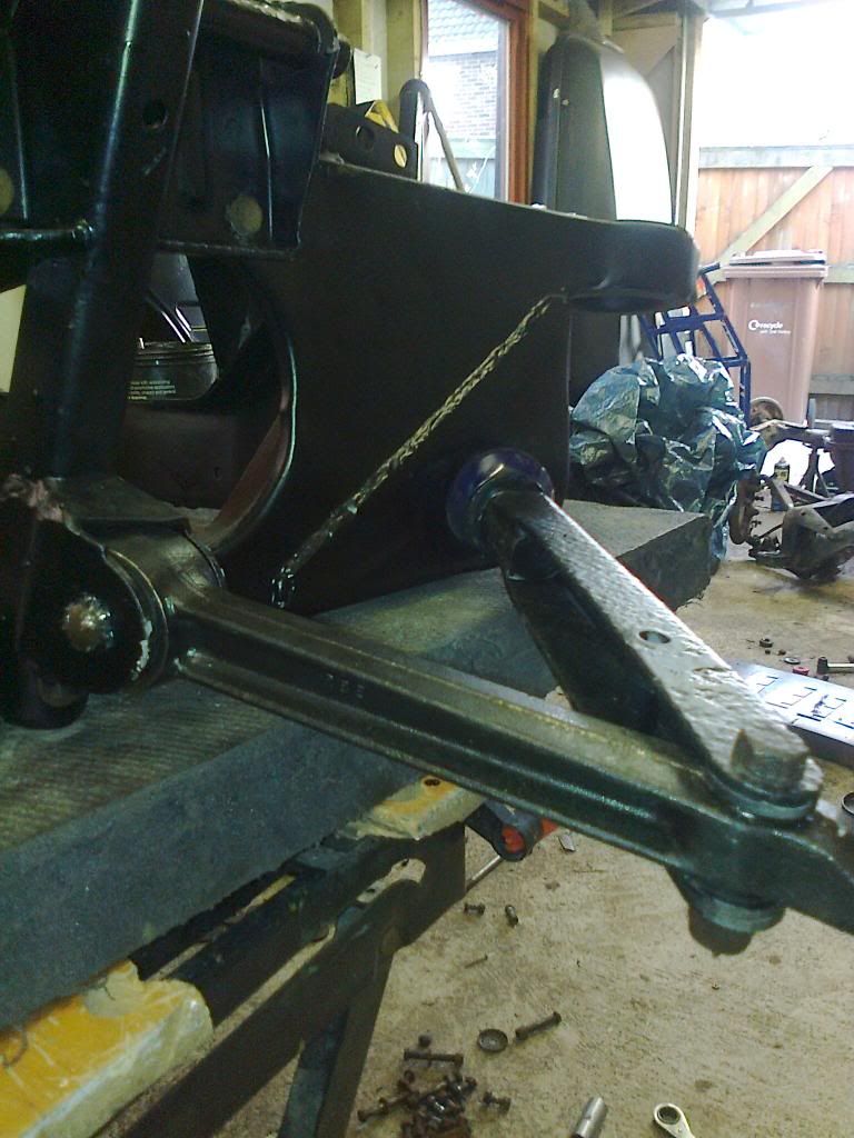

Chassis leg replaced, thanks Alun/club for supplying

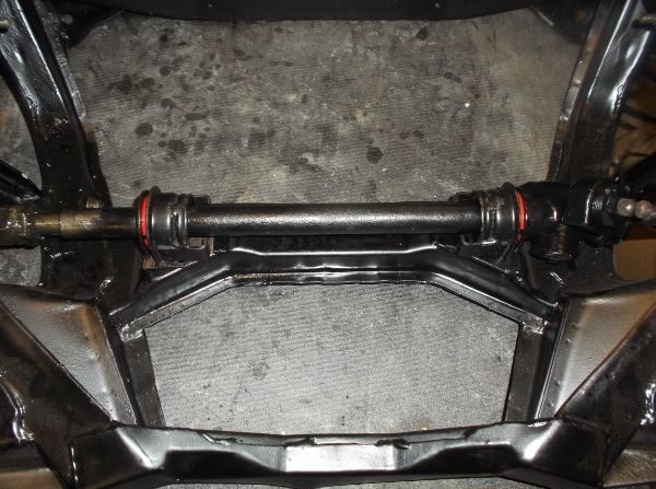

Uprated Front tie bars, identified as T2000, thanks Jeroen,new polybushes sourced.
So that's about it so far, I should be getting the painted shell back in a couple of weeks so in the meantime I am rebuilding the front suspension & cleaning up the back axle ready to go back on the car.

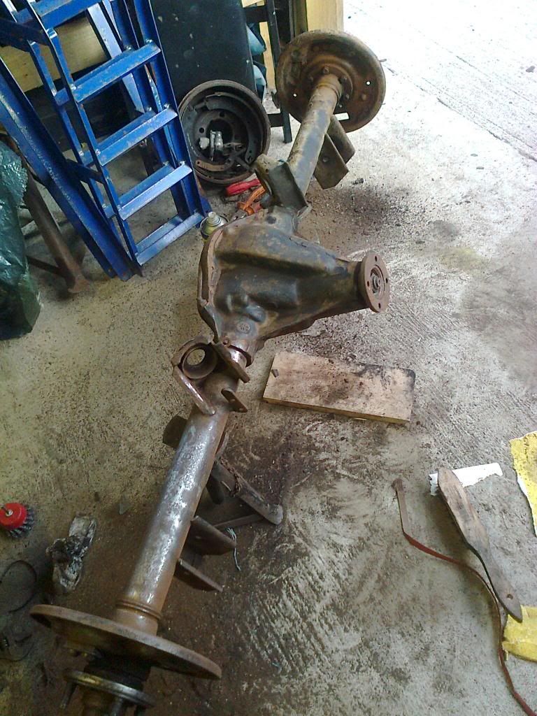

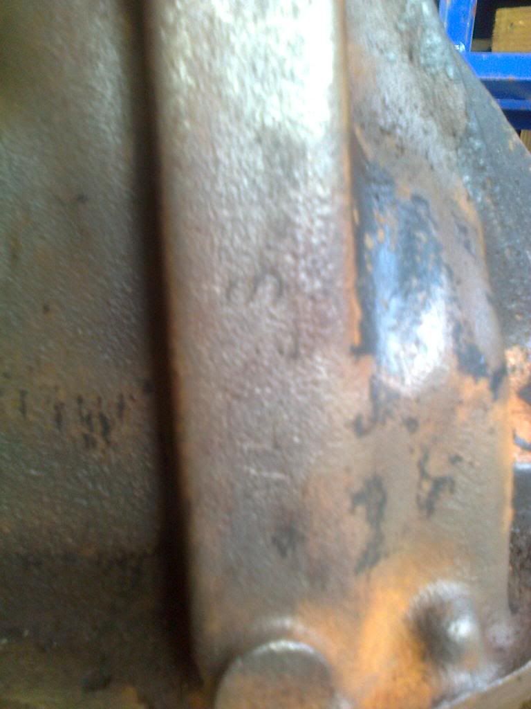

Started to clean up the back axle tonight, what a boring job!
The axle has a Powr Lok LSD fitted, but weird though it only has 'VA S' stamped on the casing no numbers?

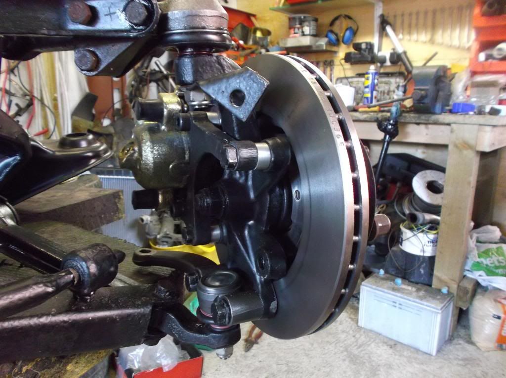

Also fitted the T2000 front tie bars & new lower wishbones

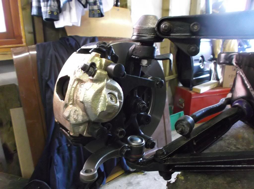

Not much time this weekend, got the nearside suspension finished including Trackerjack brake conversion (cheers Jon), would have done the offside but Rimmers sent me 2 nearside lower ball joints!

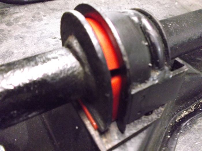

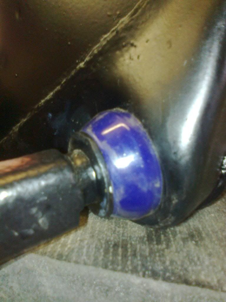

Re: your tie bar bushes.
Are they in the right way round? Im sure on mine, the tapered part fits towards the subframe, not away from it as yours are?
Or mine could be wrong and yours right :lol:
Top
 Post subject: Re: MSO 662P
PostPosted: Mon Jun 10, 2013 9:58 pm
Offline
Joined: Mon Jun 11, 2012 3:36 pm
Posts: 889
Location: Andover Hants
Hi Mart, thanks for that, I will have to decide soon, I found a couple of pictures of VHK the other day from when I first bought her in 2007, keep meaning to post them.
Hi Matt
I took some advice (see thread Front Tie Bar in Motorsport section), Ian - Sprint95m - reckoned the flat side of each bush went against the subframe, I am sure the inside one does as the cupped washer is the same shape as the conical side of the bush, so it makes sense the outer one is the same.
I think it looks right, but need a T2000 expert to confirm.

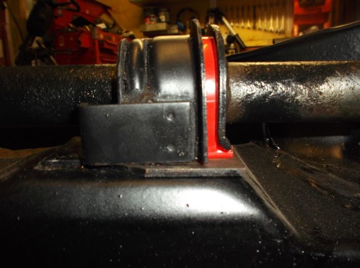

Got the rack on tonight, I ditched the solid rack mounts as they were shot, I opted for some polyurethane bushes, they were a cheapish kit off ebay.
It seems solid enough but the bush has not closed up completely when I have tightened the U bolts up, is this normal?
